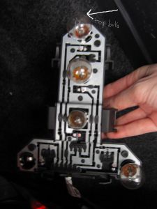

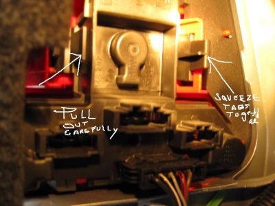

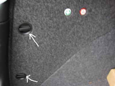

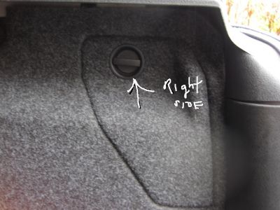

I need to change the stop and tail bulb but am not sure how I get access to the light from the boot
Sunday, October 10th, 2010 AT 7:36 AM
MARTY103
Hi to change a burnt out tail light bulb you need to open the back carpeted side panels. There are two screws very visible just twist and the panel opens on the left. The right is similar but smaller.
The bulbs are all attatched together and you have to squeeze two sided tab to pull out the bulbs. Tail stop light is top bulb. Middle bulb is tail light when you turn your lights on.
