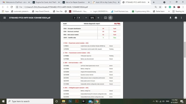

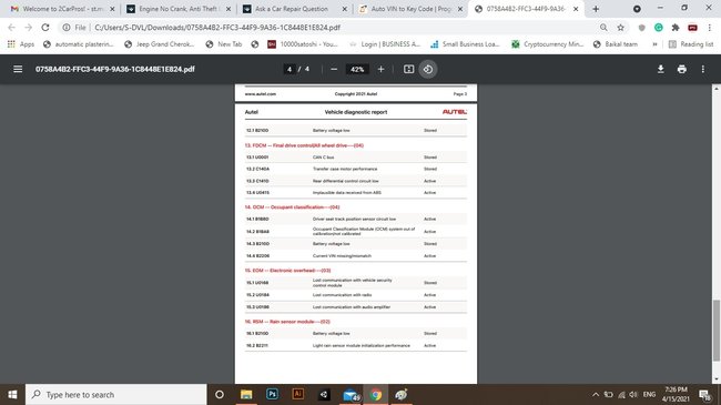

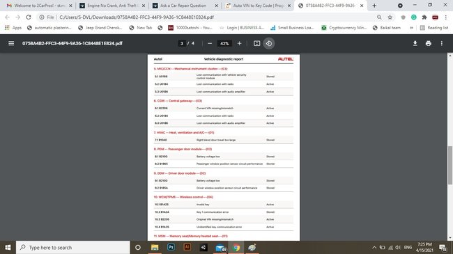

PCM replaced and didn't match my vin. should i rewrite VIN?
car didn't start .
i don't have pin code reprogramme the PCM.
i use Ap 200.
Apr 15, 2021 at 9:29 AM
Good afternoon,
The VIN has to be changed as well as the mileage from the old cluster.
Do you have access to Tech Authority for Chrysler to program the module? I do not see that option on your scan tool.

Maxi AP 200 have the option to replace PCM and write VIN on the PCM. I have seen videos and try it but i didn't have pin code for car. how can i get pin code by VIN?
Apr 15, 2021 at 2:06 PM
You can get that from the dealer. They will have access to that information.
Apr 15, 2021 at 2:10 PM
YALLA_911A
  • 9 POSTS
is there any way to extract pin code from immo or software calculate pin from VIN?
Apr 15, 2021 at 2:22 PM
No, there is not. You need to get the information from the dealer service. They can look it up for you and get you the correct one.
The one you have may have been updated and you want the most current version for the ECM.
