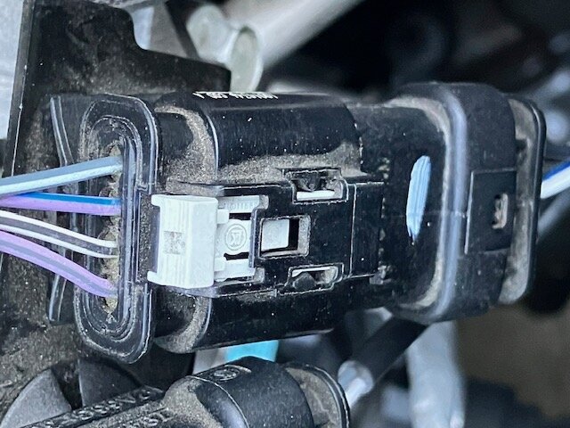

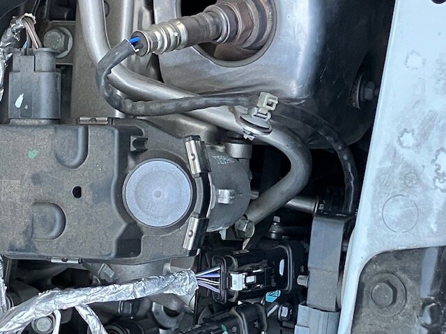

I am trying to replace an upstream oxygen sensor on the vehicle listed above; GM part 55485043, but I am having a problem removing the old part. I can't get the wire connector off. What's the trick to disconnecting, please?

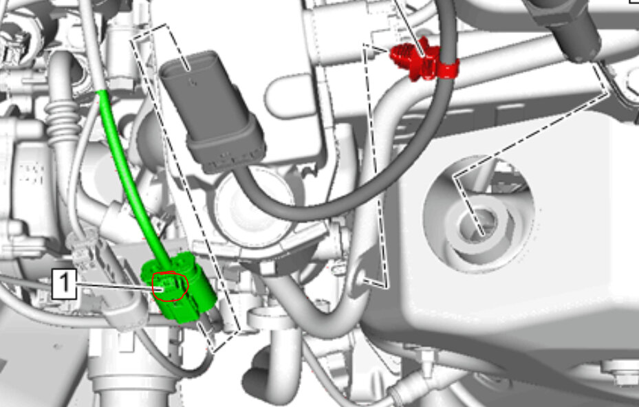

Do me a favor. Take a look at the pic I attached below. I circled a spot on the connector where I believe there is a plastic retainer/lock. It could be any color but usually, it will be red. If it is there, carefully slide it out. Once it is out, you will be able to depress the release and disconnect the connector.
Let me know if this helps.
See pic below.

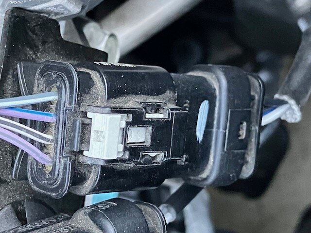

Yes, it's a white clip and I've pulled it up but still can't pull the 2 apart. Is there any other clip? What did you mean by depress the release? Thank you.

Make sure the clip is far enough out. It is in there to prevent the release from depressing. There should be a tab that will depress and allow the two to come apart.
If you are questioning the retainer, remove it completely. There could be enough still engaged preventing you from depressing the tab.
If you still have a problem, take a pic of the connector (as best as you can) from a couple of different angles and upload the pics for me to see. Maybe it is something different than what I have seen.

You have the correct piece. It's stubborn.

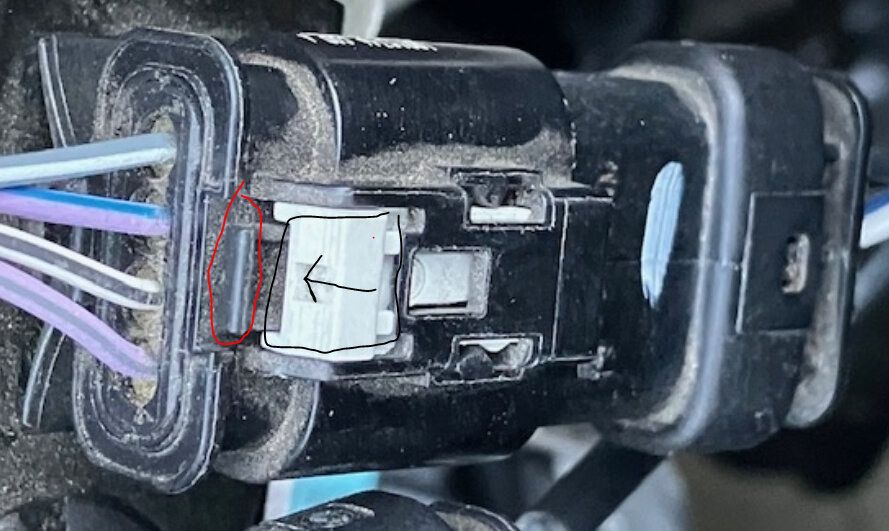

I copied one of your pictures. I circled the white clip in black. That needs to be removed by sliding it in the direction of the arrow. The lower portion of that clip is preventing the release of the connector.
Once that is removed, depress the lever I circled in red. While depressing it, wiggle the connector a bit and pull it apart.
See pic below.

OMG finally. Pull the white clip up and squeeze so that black part behind pushes in and pull two connectors apart at same time. I broke the fastener that holds it in place when I was first wriggling it to get the connectors apart. Do you know part number for fastener please?
