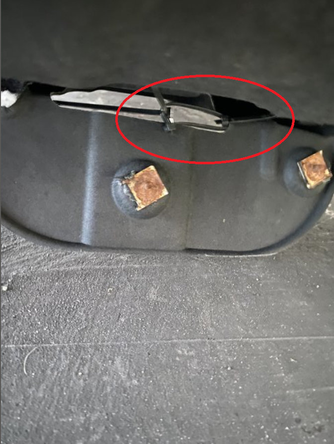

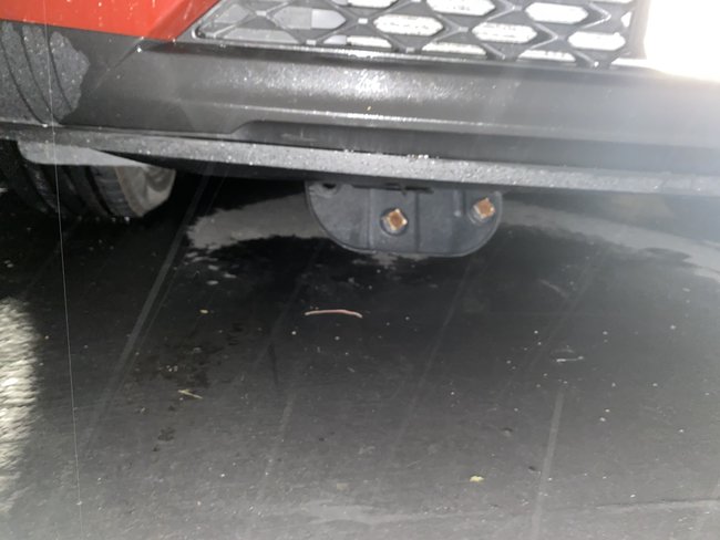

Hello, I have something hanging down low from underneath my car.

I certainly see it, but it is just blurry enough that I can't determine what it is. Would it be possible for you to take a couple of pics closer to the item and from under the vehicle looking upward?

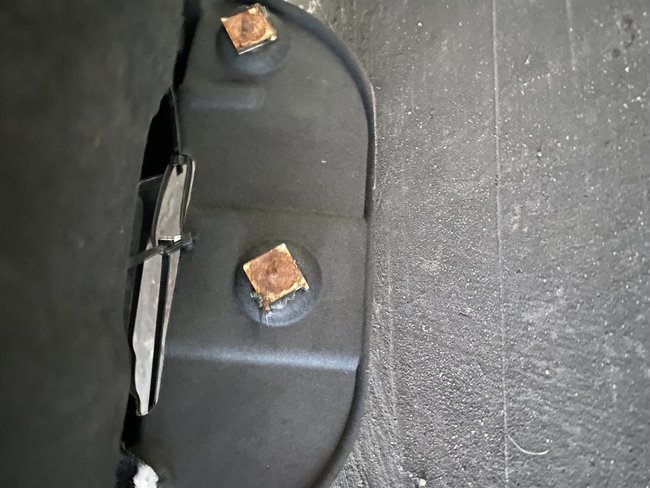

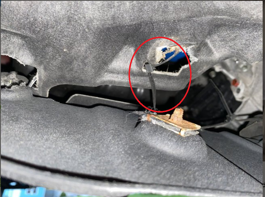

Here are the pictures:

That's the front of the vehicle, correct? It looks like possibly an access panel was ripped out after hitting something in the road. Are you noticing any running conditions? Check engine light on?
Saturday, October 1st, 2022 AT 12:23 PM (Merged)
LBARNES34
  • 7 POSTS
Yes, that is the front of the vehicle. The car is running fine, no engine light is on.
AL514
  • 5,596 POSTS
Did you buy this vehicle used? I see a plastic tie wrap behind one of those ripped out screw hold downs. It looks like this has been repaired before.
LBARNES34
  • 7 POSTS
No, this was a brand-new vehicle, and I didn’t hit anything, that’s why I’m surprised.
AL514
  • 5,596 POSTS
I see plastic tie wraps here too. It's not any part of the engine hanging down, it's just part of the protective shield.

Well, I would just have someone push it back up and do a few more tie wraps around the edges. You don't really need to replace the entire shield for that one little section. This doesn't need to go to a shop for this. A lot of shops are charging huge labor rates now. So, if you know someone handy, I'd have them do it. You don't want to pay a $100.00 to fix this.
