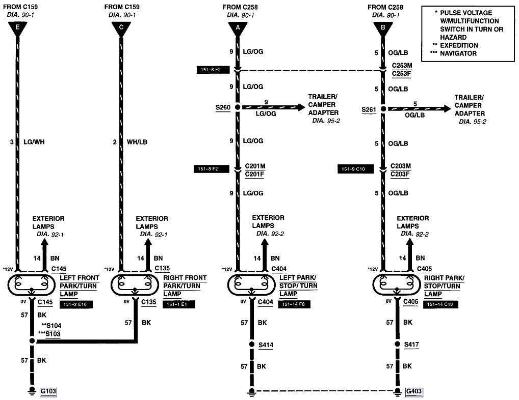

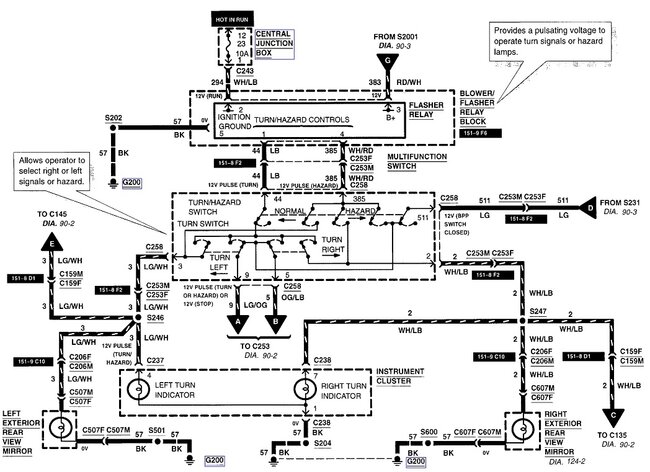

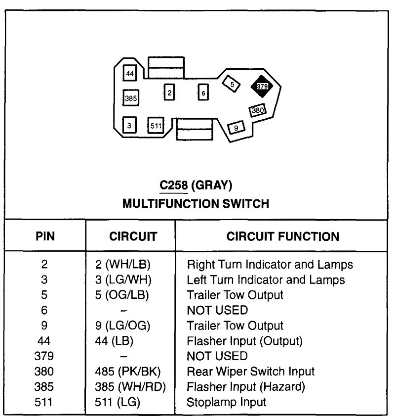

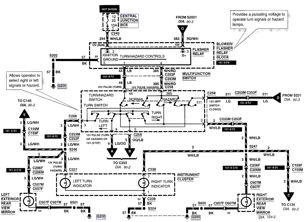

I'm trying to install a new connector but my other one's wires popped out, so I don't know where they go.
Thursday, May 11th, 2023 AT 1:01 PM
CARADIODOC
MECHANIC
34,454 POSTS

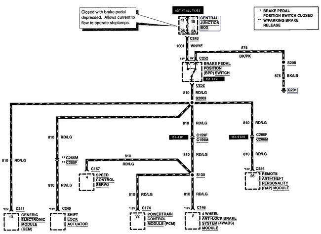

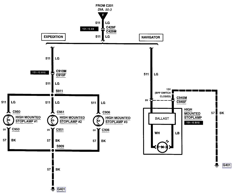

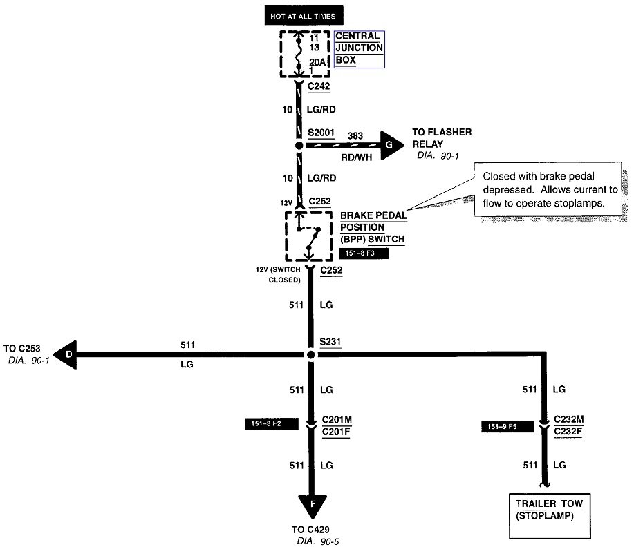

Here's the connector view. I included the diagrams for the signal system in case you need them.
