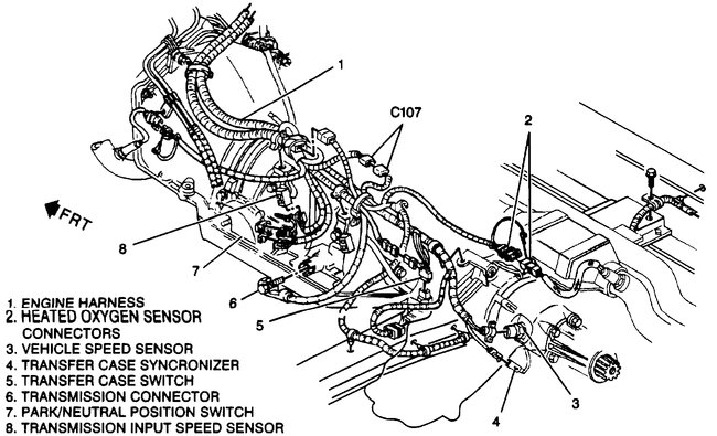

Since you just replaced the transmission, are you sure the neutral safety switch is connected and everything is properly adjusted? See if it will start in neutral. If it does not, turn the key to the start position and take the shifter from park to low 1 to see if it cranks in any position.
I attached a picture of where the switch is located.
If you are confident the switch is not the problem, here is a link that shows how to check the starter:
