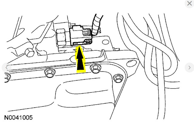

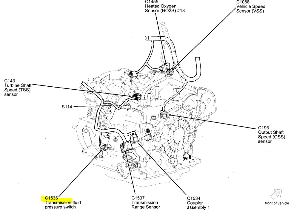

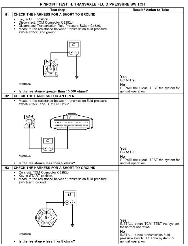

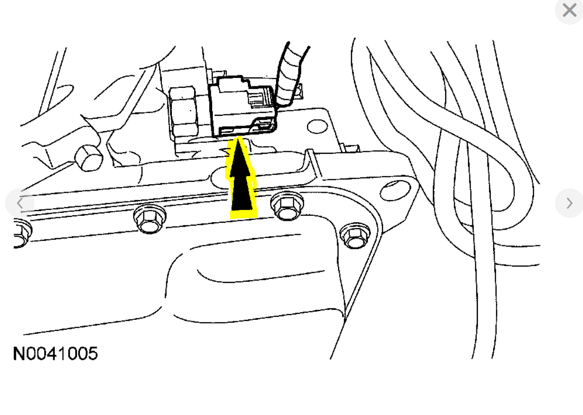

Where is the transmission fluid pressure switch/sensor located?
Sunday, May 8th, 2022 AT 9:58 PM
SQM
MECHANIC
6,383 POSTS
The transmission pressure sensor is located on the lower left side of the transmission.
I have attached diagrams below for your reference.
Also attached are the diagnostics for the code P0841, this issue could also be due to wiring issues.
Let me know of any questions.
