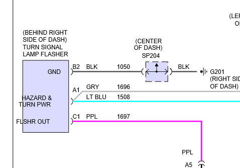

Ned know how to trick computer through turn signal switch.

If bulbs and fuses are good you need to replace the t/s hazard flasher. See picture it can also be multi function switch on steering column.
Image (Click to make bigger)
