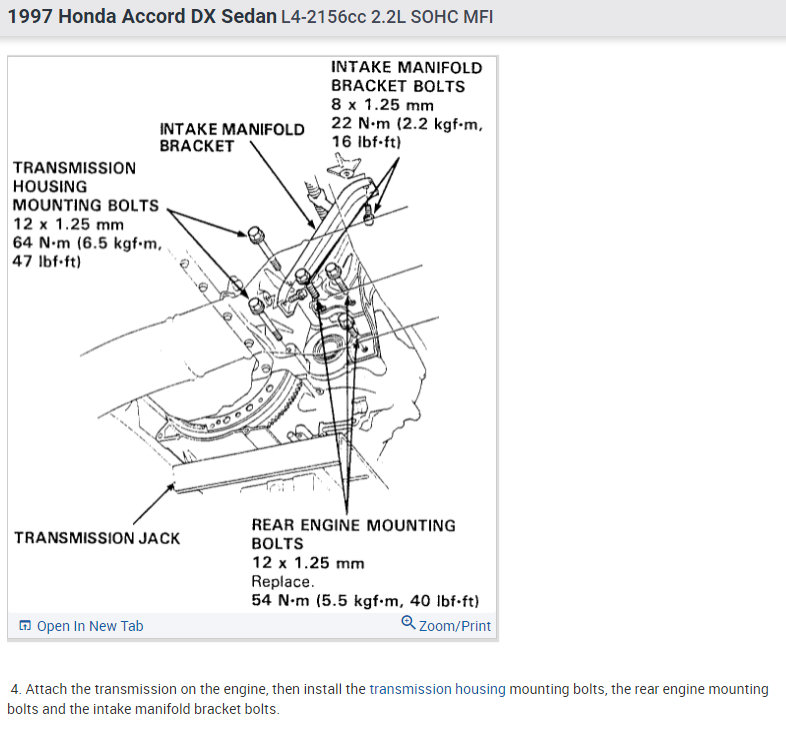

Will a 1993 Honda civic automatic transmission fit in a 1997 Honda accord same 4 speed automatic?
Wednesday, October 6th, 2021 AT 3:13 PM
SQM
MECHANIC
6,383 POSTS

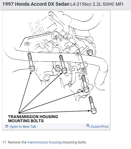

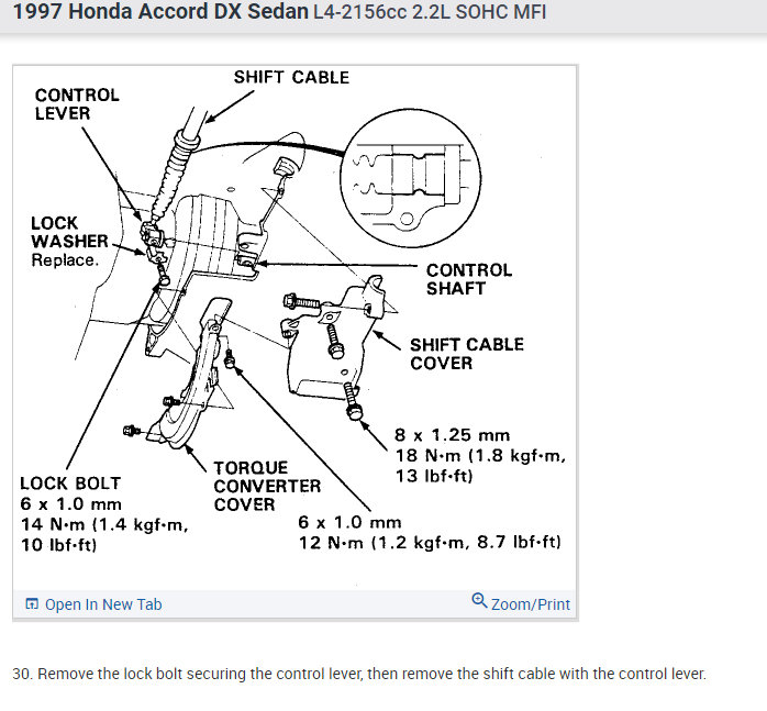

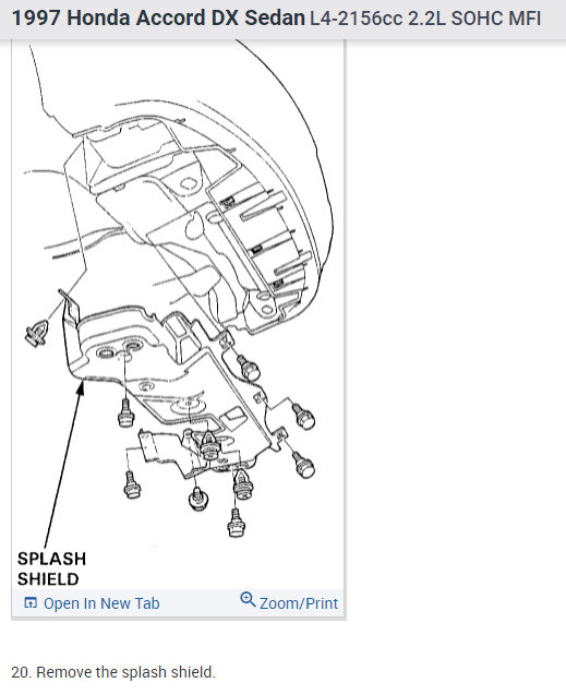

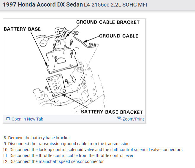

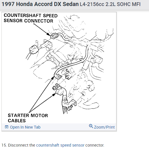

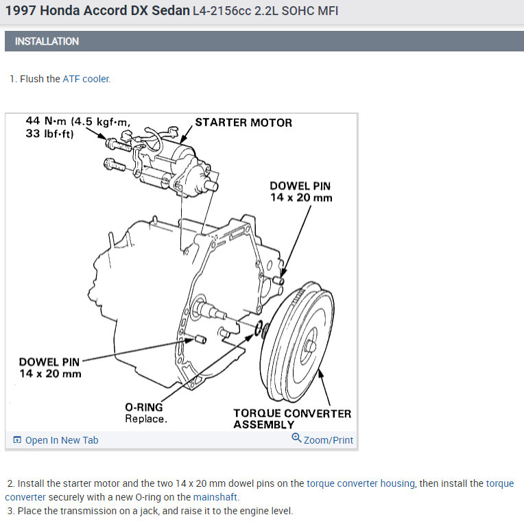

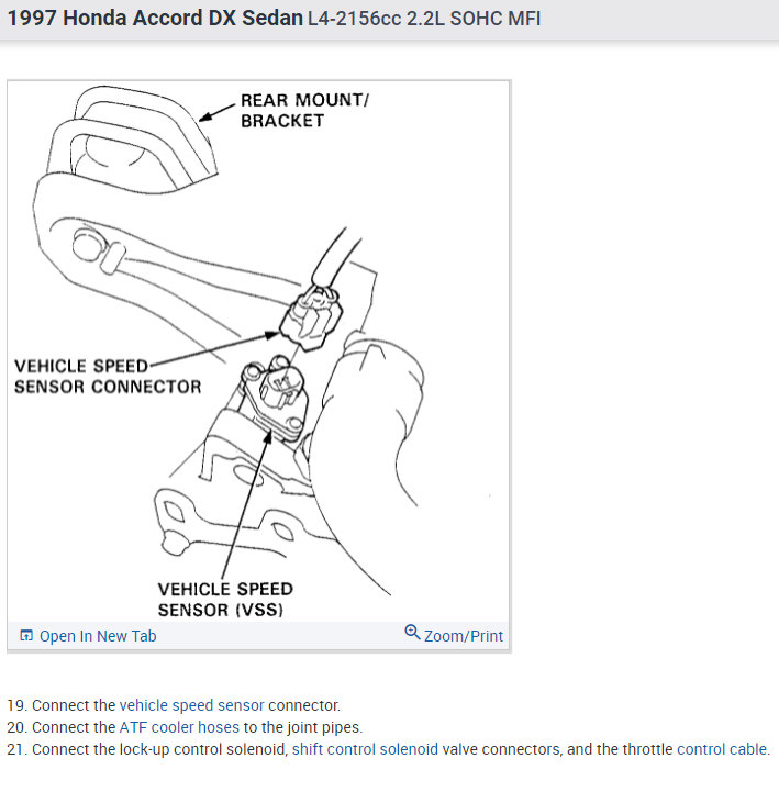

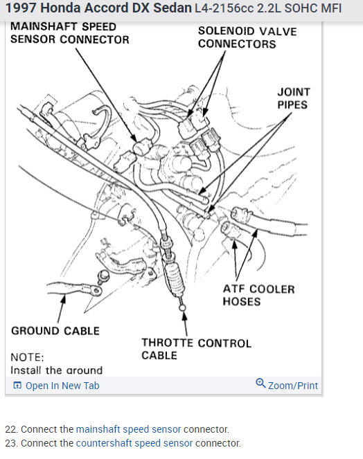

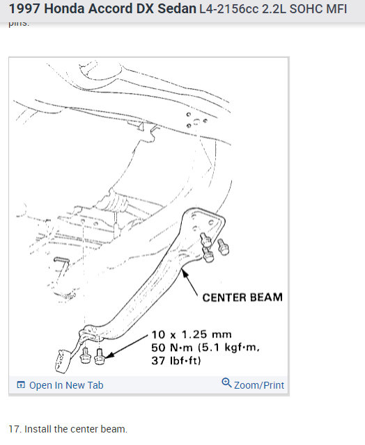

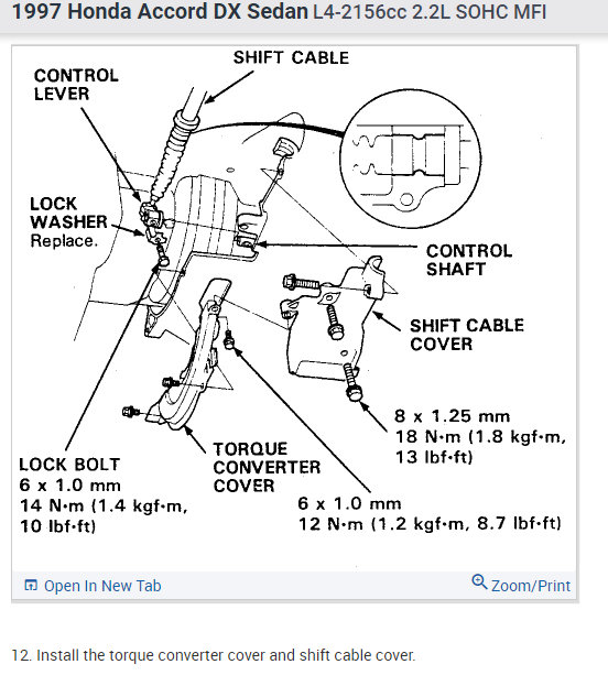

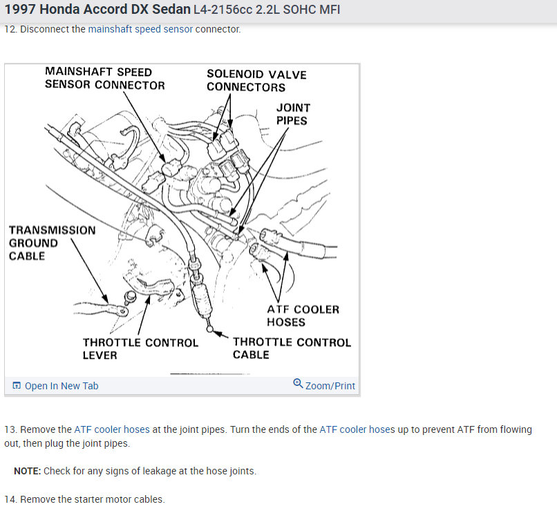

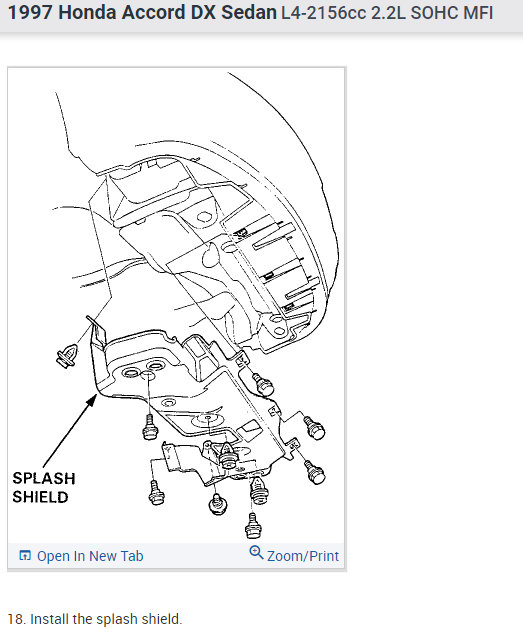

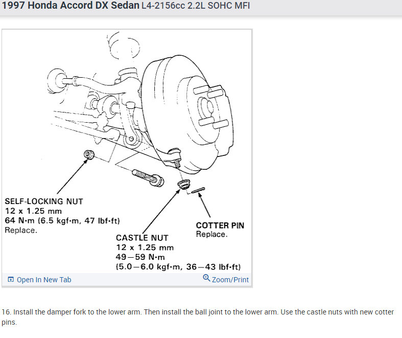

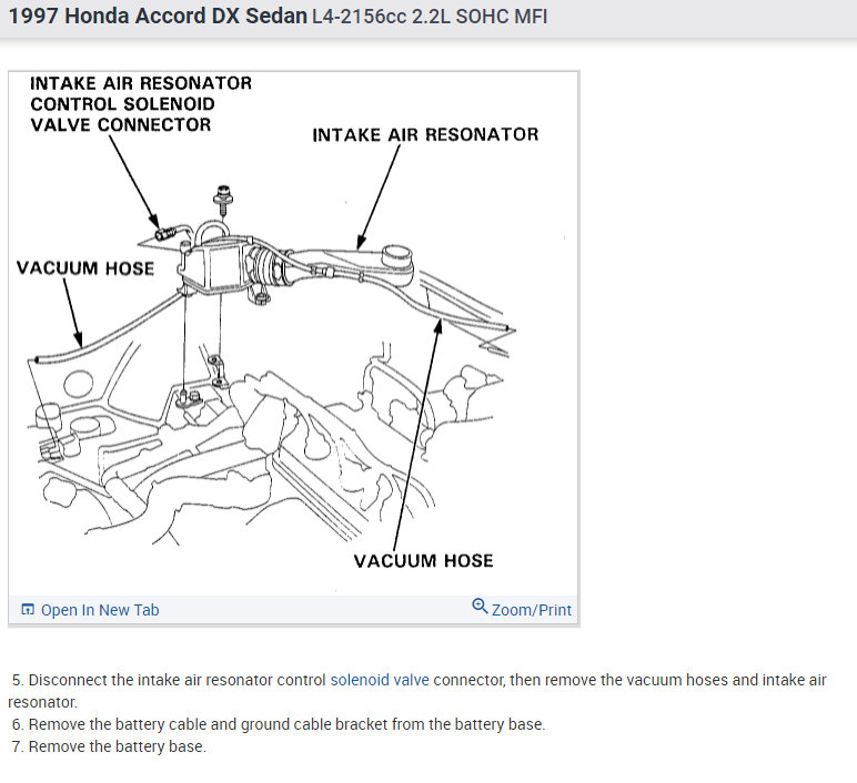

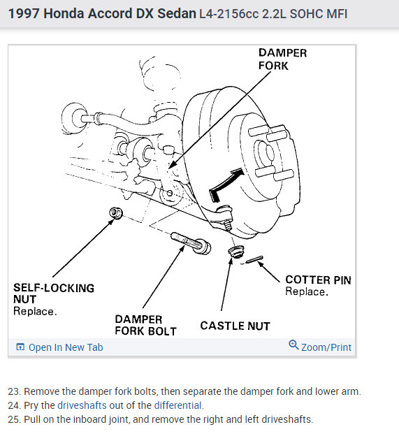

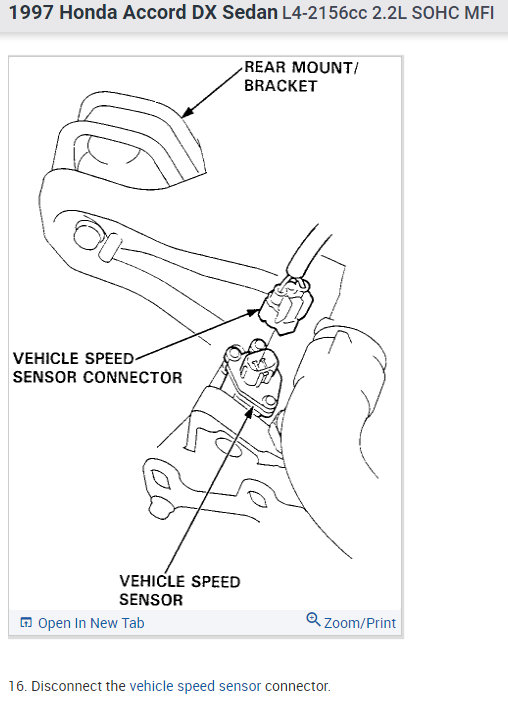

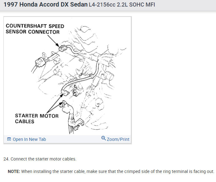

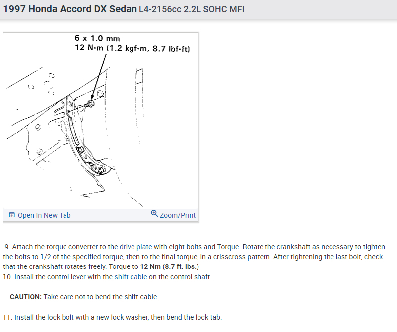

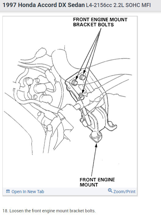

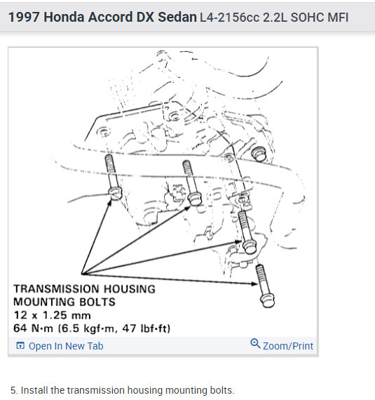

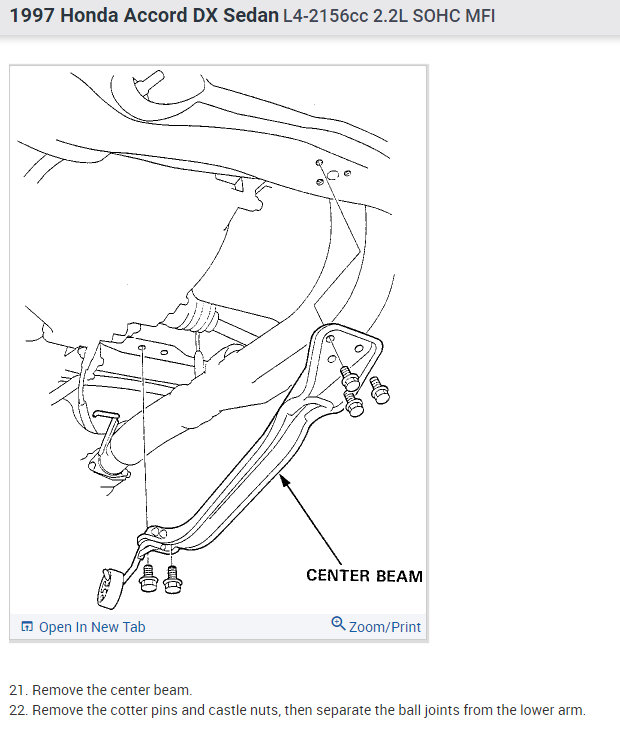

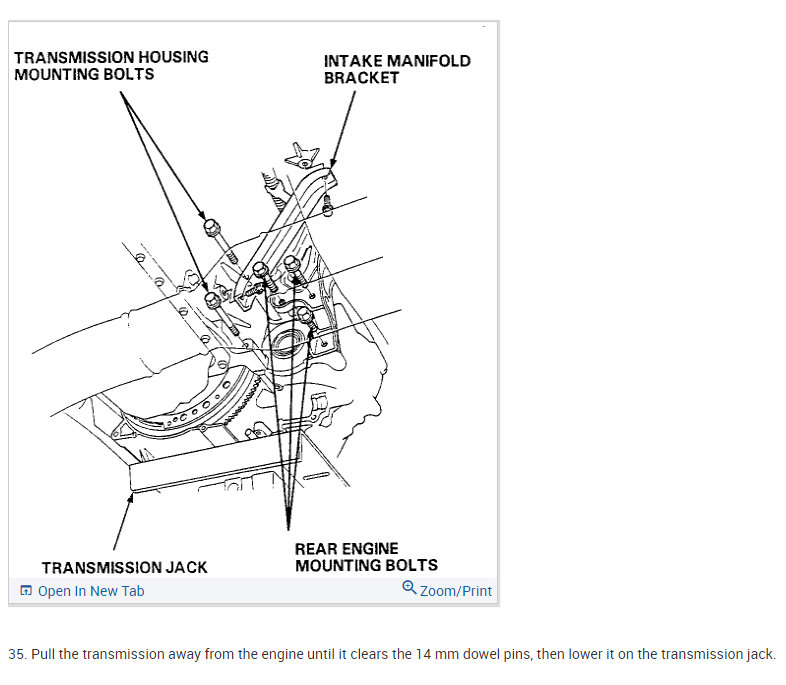

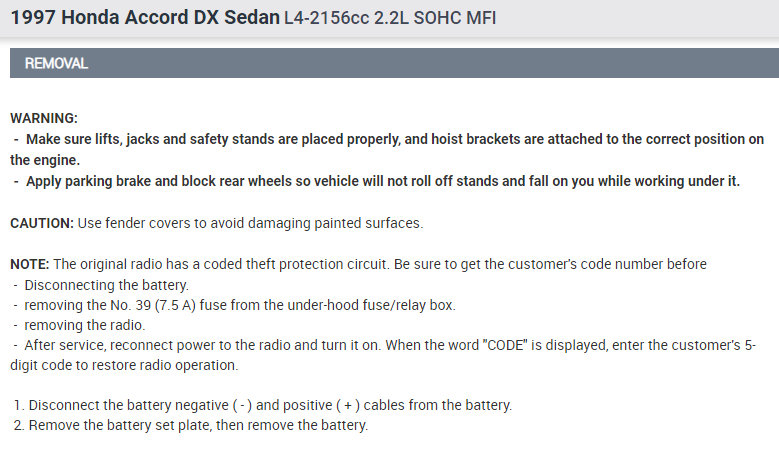

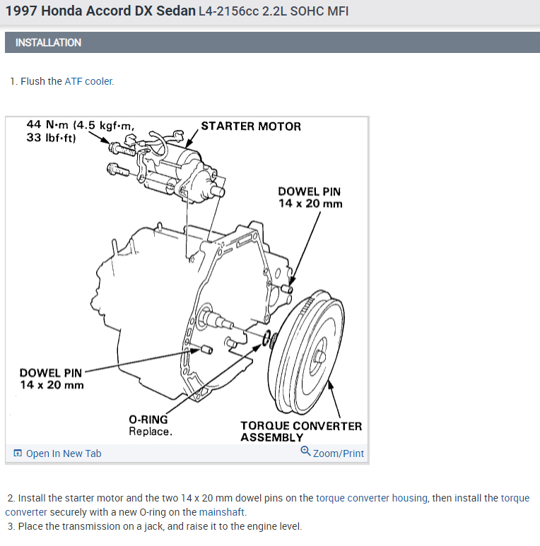

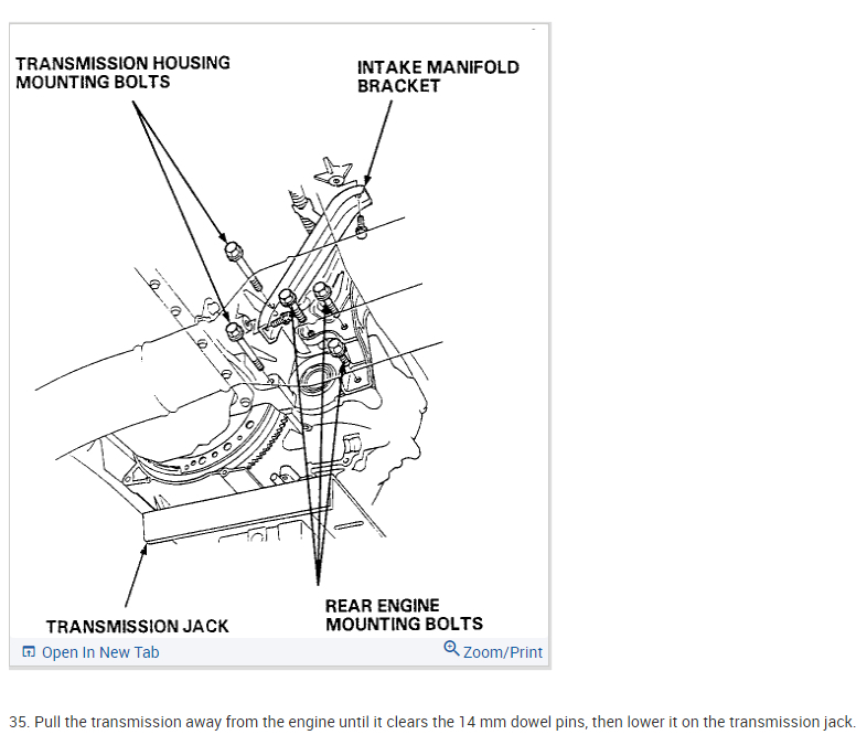

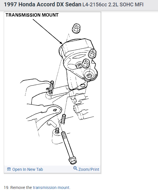

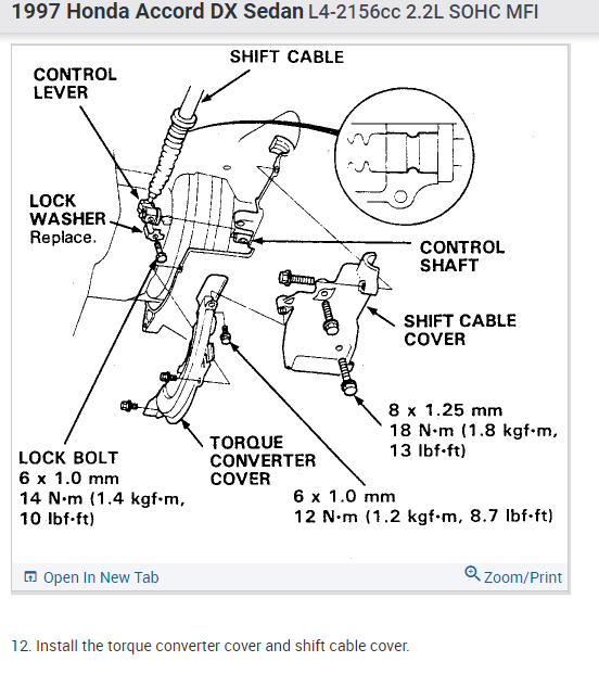

These transmissions are not interchangeable. They are different mechanically as well as uses different computers.
https://www.2carpros.com/articles/how-to-remove-an-automatic-transmission-rwd

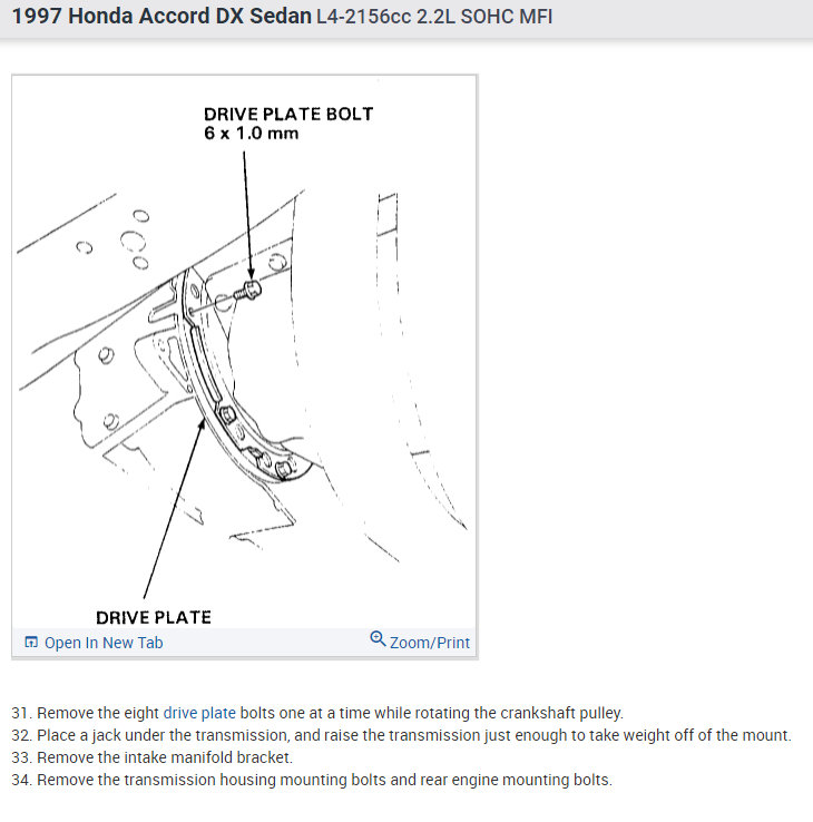

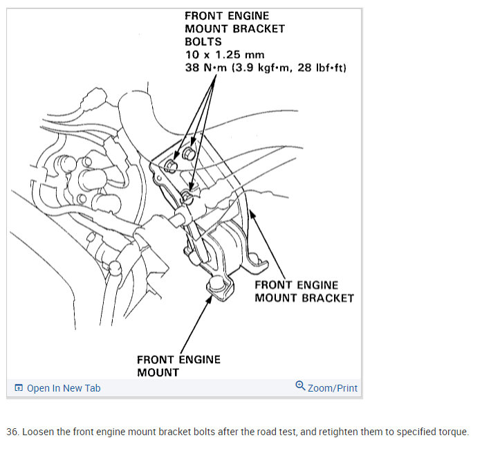

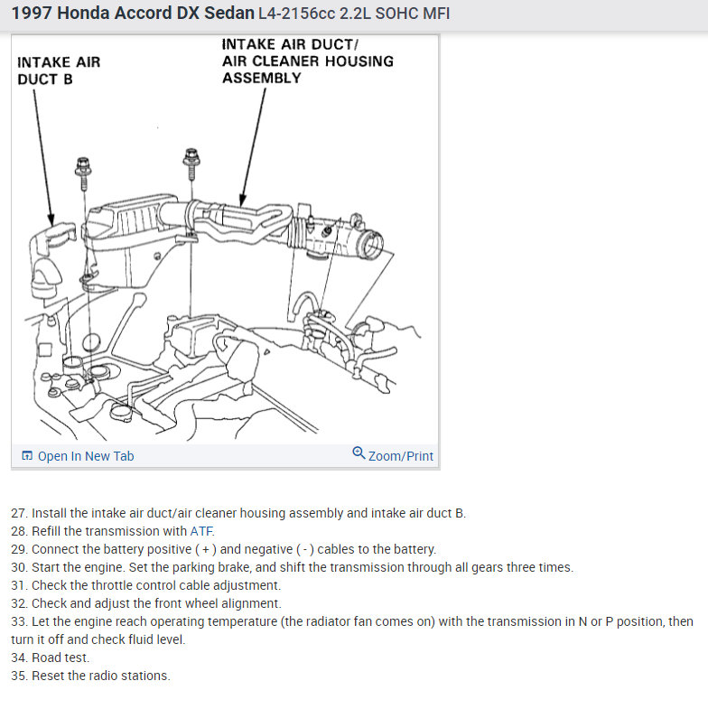

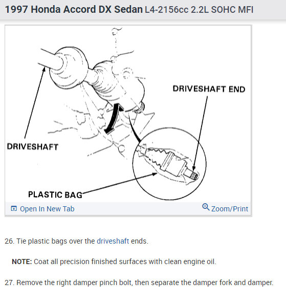

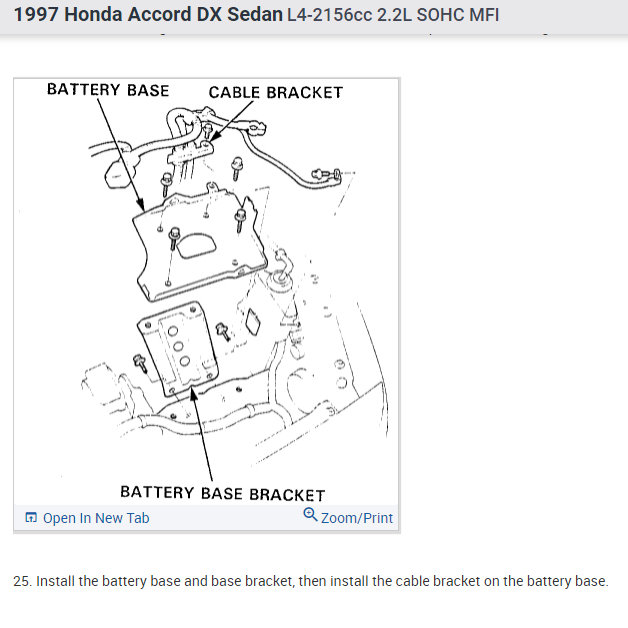

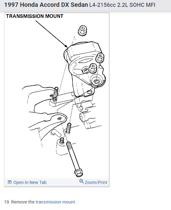

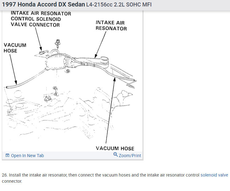

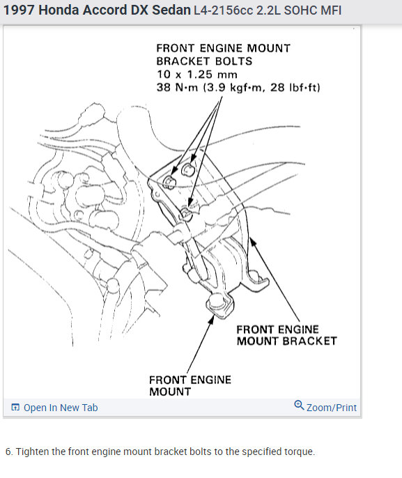

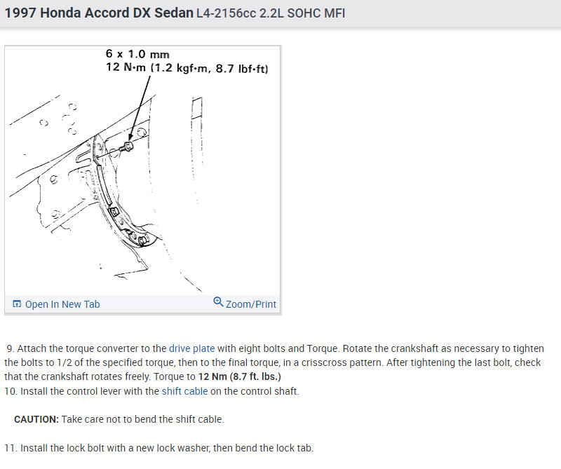

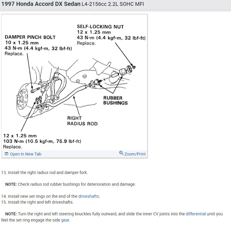

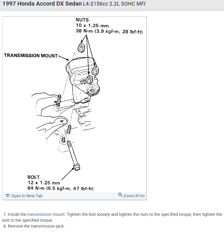

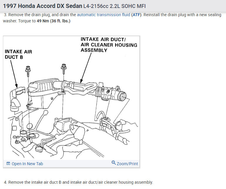

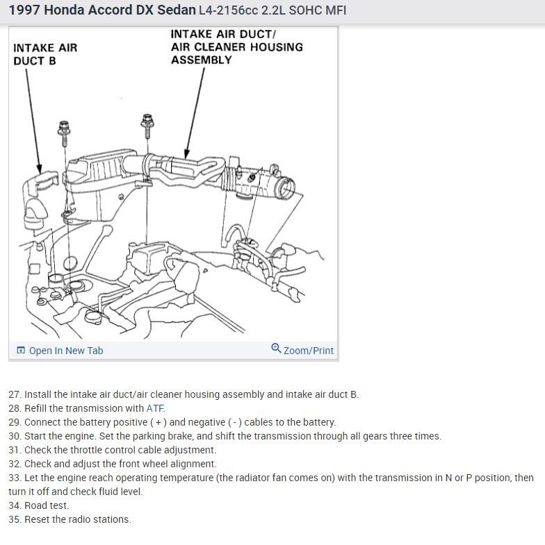

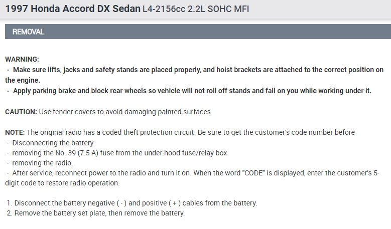

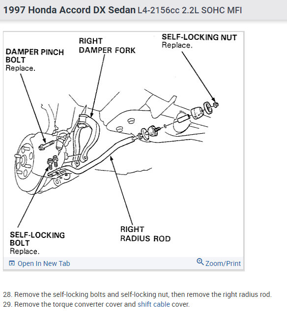

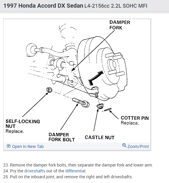

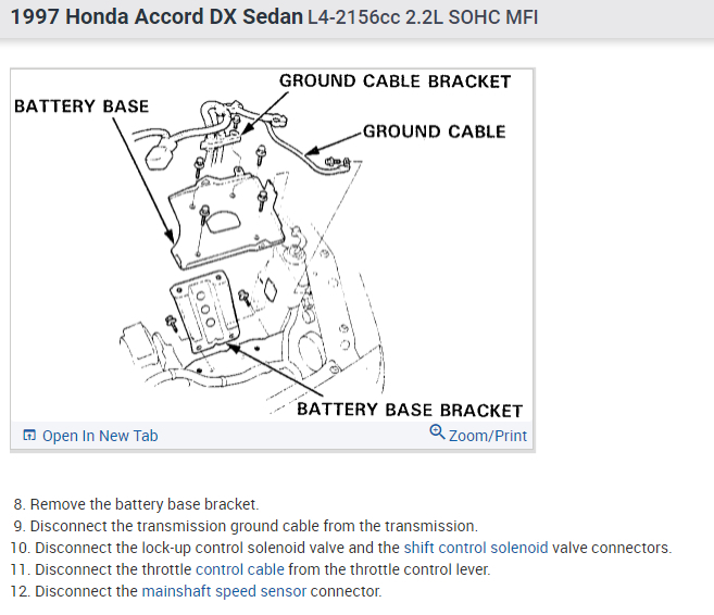

I have attached the transmission replacement for your reference.
