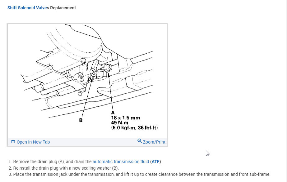

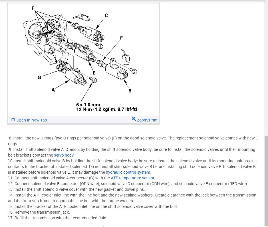

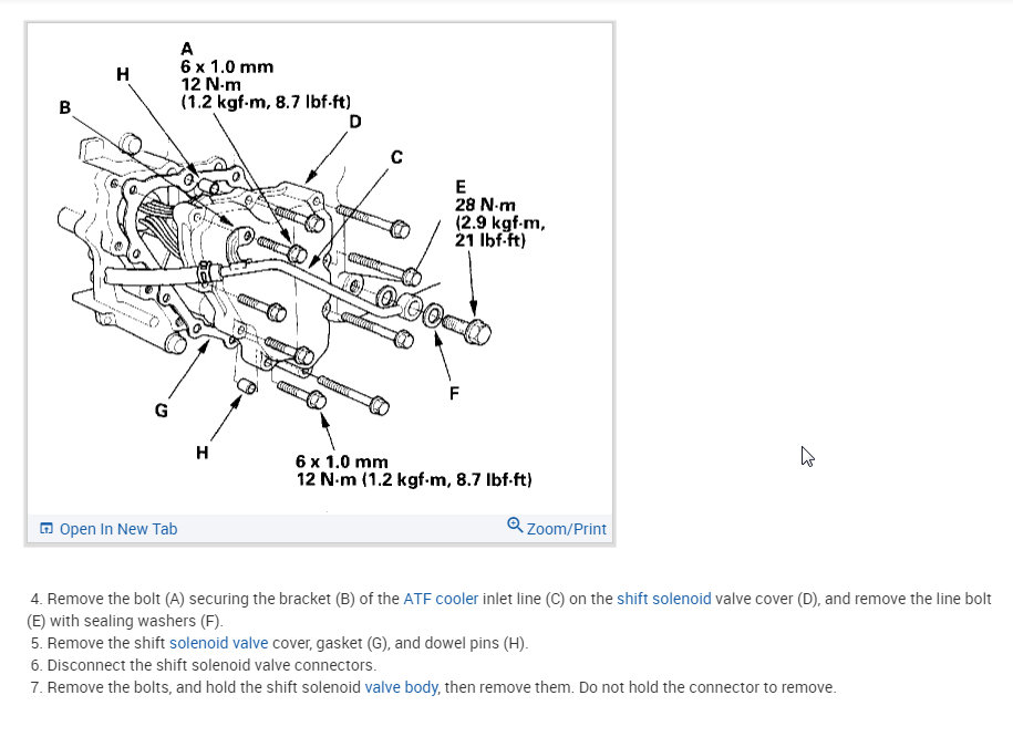

At scanner do a problem with solenoid c.
Wednesday, December 25th, 2019 AT 8:32 AM
MECHANIC
18,907 POSTS
If you found a code for the solenoid then most likely it has failed and needs replacement. Let me know what the code is and we can get you the detail.
I attached the detail about the solenoids. Let me know if you have questions. Thanks
