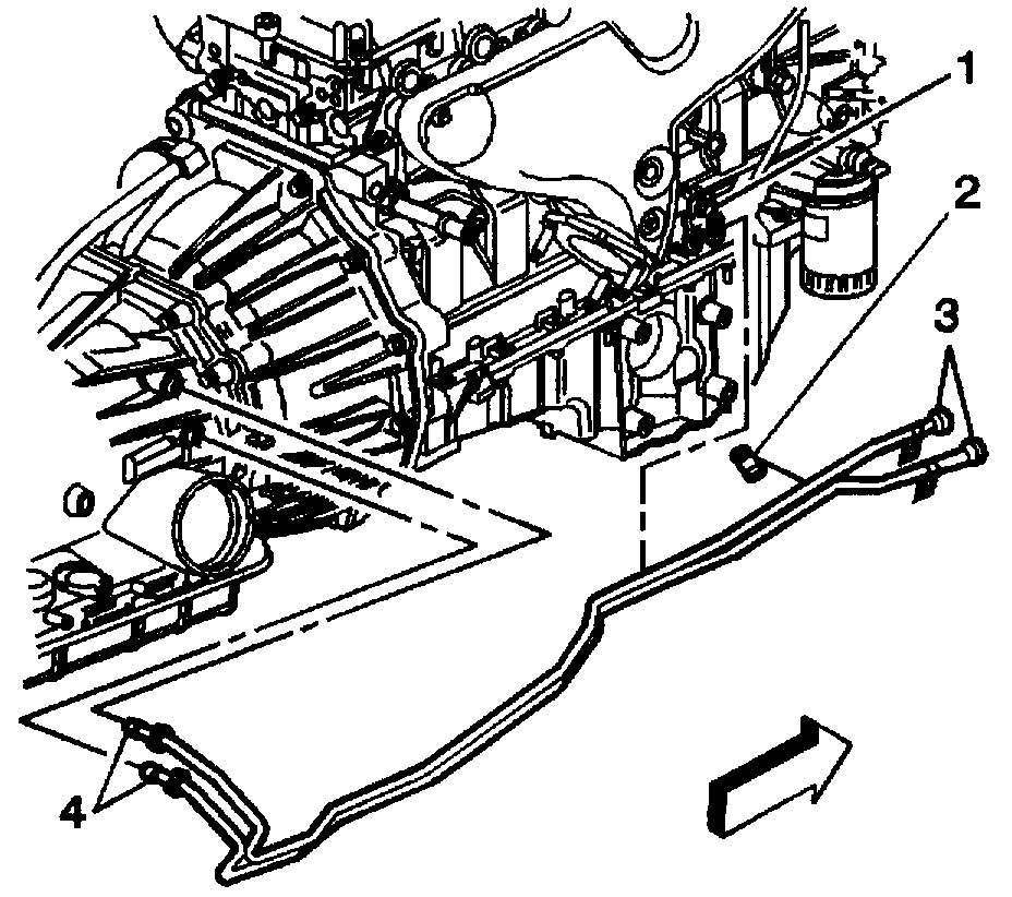

I need to know how to replace the two transmission lines that run by the exhaust. They are leaking. what is easiest way to get them fixed?
Nov 20, 2020 at 7:08 PM
  • 110,193 POSTS

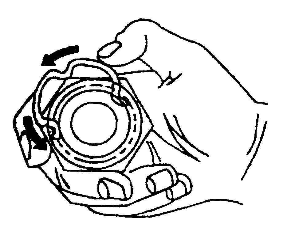

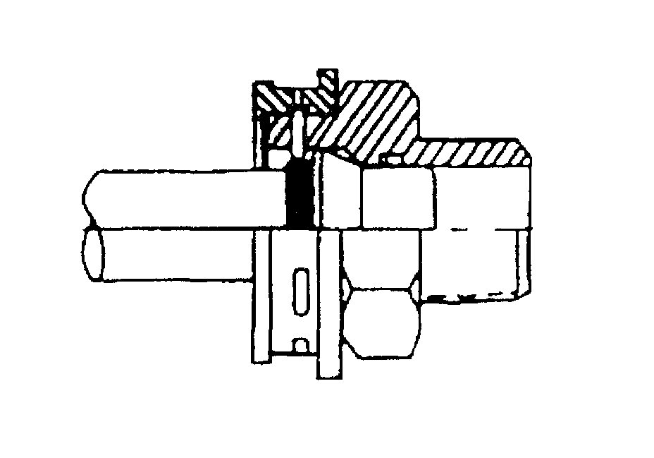

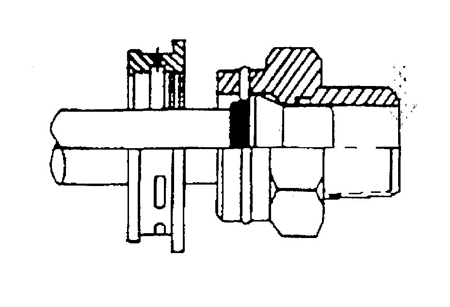

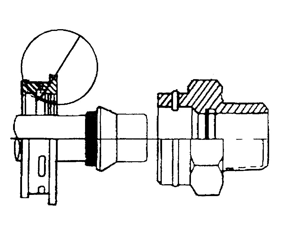

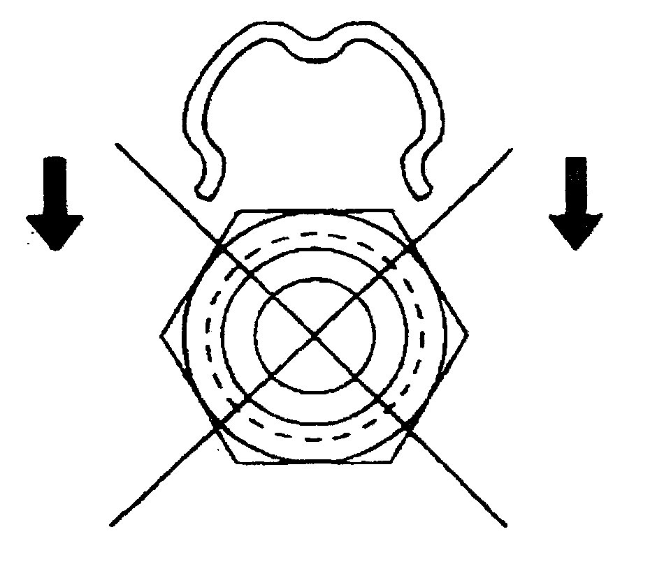

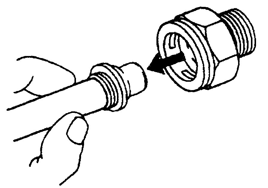

The easiest way to do it is on a lift. However, I'm not sure if you have access to one. Other than that, it is going to be tight and difficult to move around under the vehicle and to guide the lines where they belong.
Regardless, here are the directions. The attached pics correlate with the directions. Note: When you remove the retainer which holds the line on at the trans and radiator, be really careful not to lose it. They are small, hard to see, and like to fly off. If you look at pics 6 and 7, you will see the clips I'm referring to.
_____________________________________
2002 Chevy Truck TrailBlazer 4WD L6-4.2L VIN S
Procedures
Vehicle Transmission and Drivetrain Automatic Transmission/Transaxle Fluid Line/Hose Service and Repair Procedures
PROCEDURES
Transmission Fluid Cooler Hose/Pipe Replacement (Body Vin Code 3)
Removal Procedure
Important: The front and rear sections of the cooler lines can be serviced separately. Refer to the appropriate steps when servicing individual lines. Perform the following procedure when removing the cooler lines from the quick connect fittings.

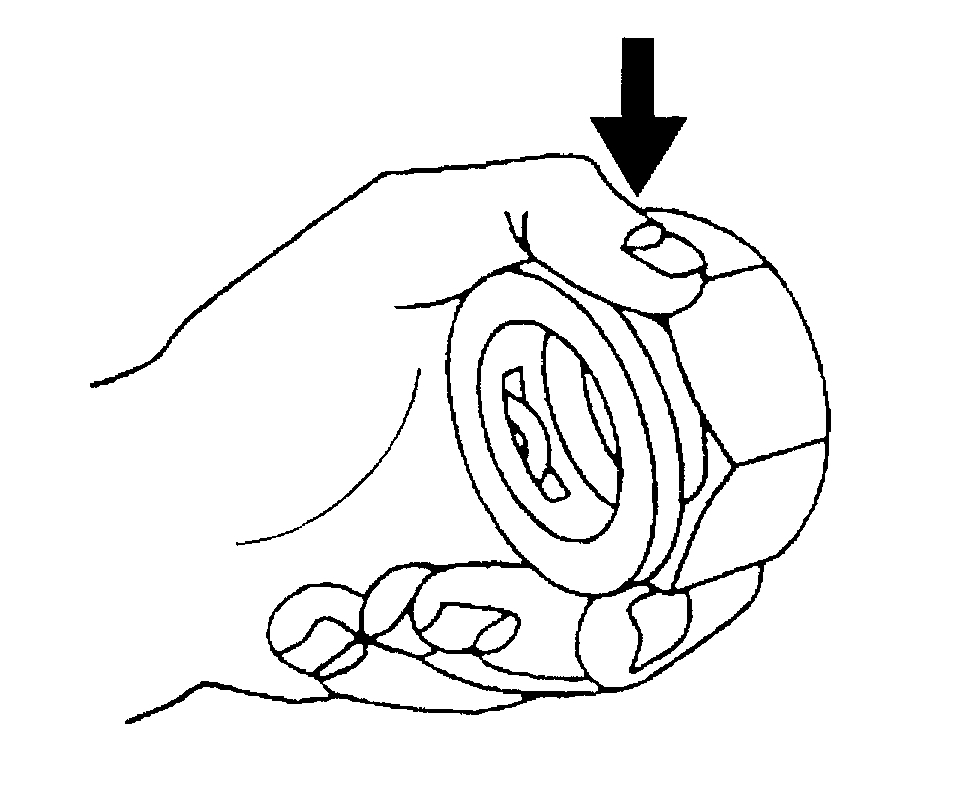

pic 1

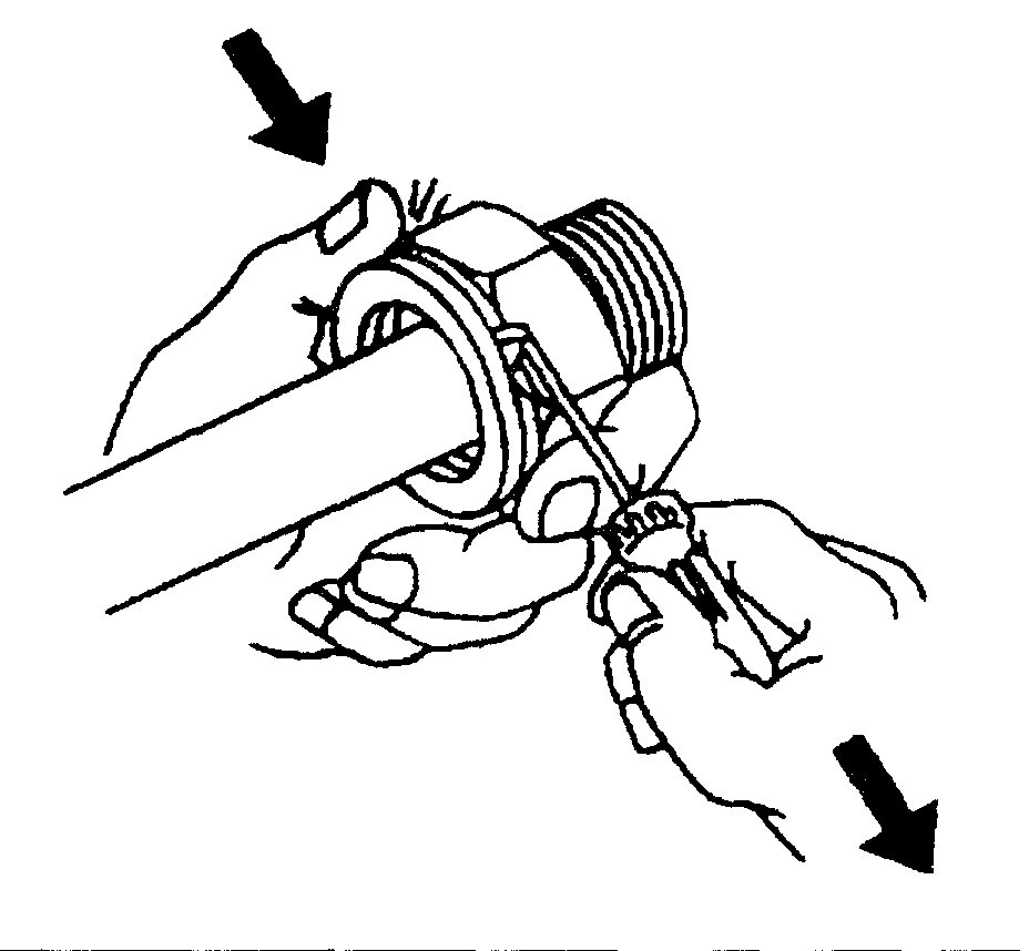

1. Pull the plastic cap back from the quick connect fitting and down along the cooler line about 5 cm (2 inch).
2. Using a bent-tip screwdriver, pull on one of the open ends of the retaining ring in order to rotate the retaining ring around the quick connect fitting until the retaining ring is out of position and can be completely removed.
3. Remove the retaining ring from the quick connect fitting.
4. Discard the retaining ring.

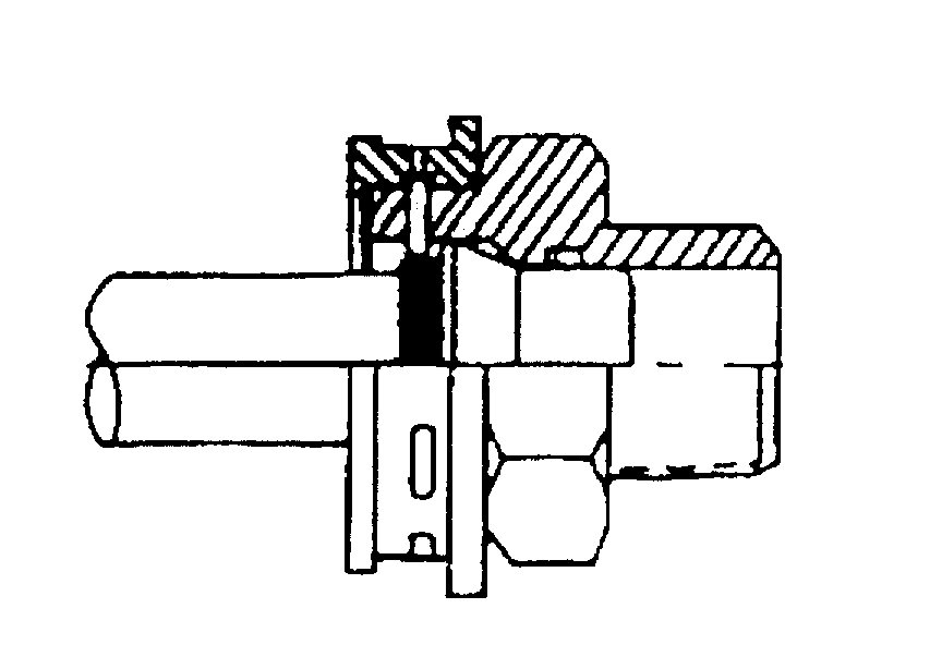

pic 2

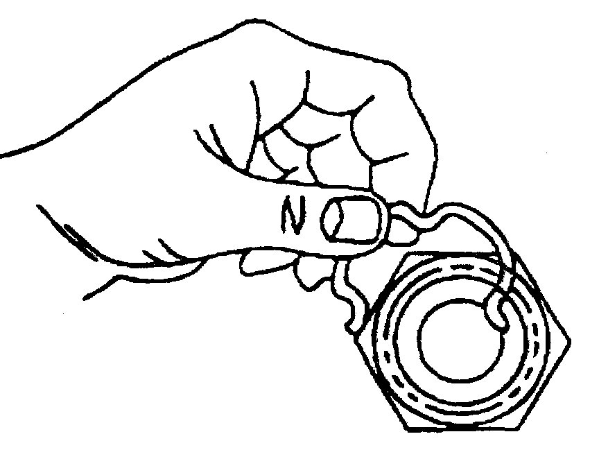

5. Pull the cooler line straight out from the quick connect fitting.
pic 3

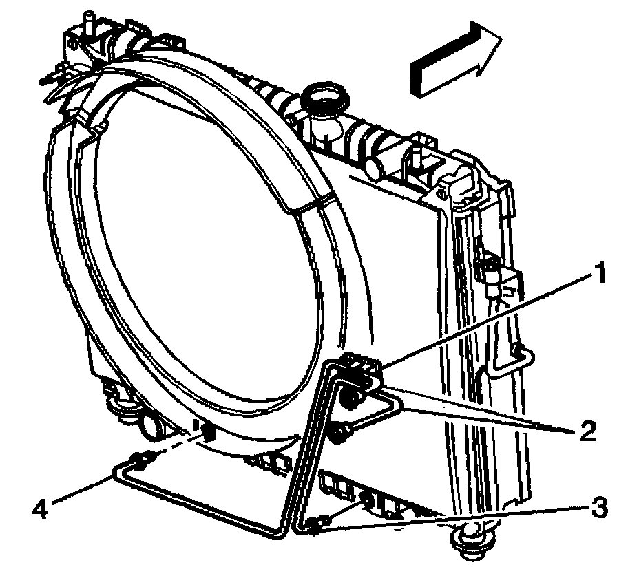

6. Raise the vehicle. Refer to Vehicle Lifting.
7. Place a drain pan under the vehicle.

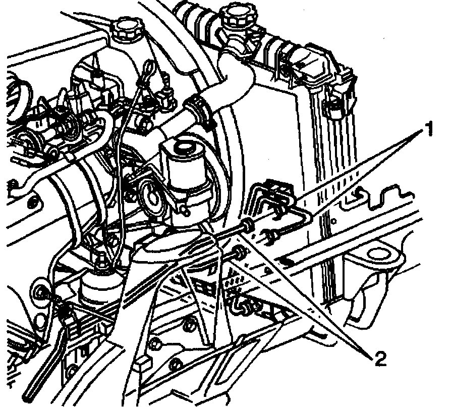

8. Remove the cooler lines (3,4) from the radiator.
9. Separate the front and rear cooler lines at the quick connect fitting (2).
10. Remove the cooler lines from the retainer (1) located on the radiator shroud.
11. Remove the front sections of the cooler lines from the vehicle.

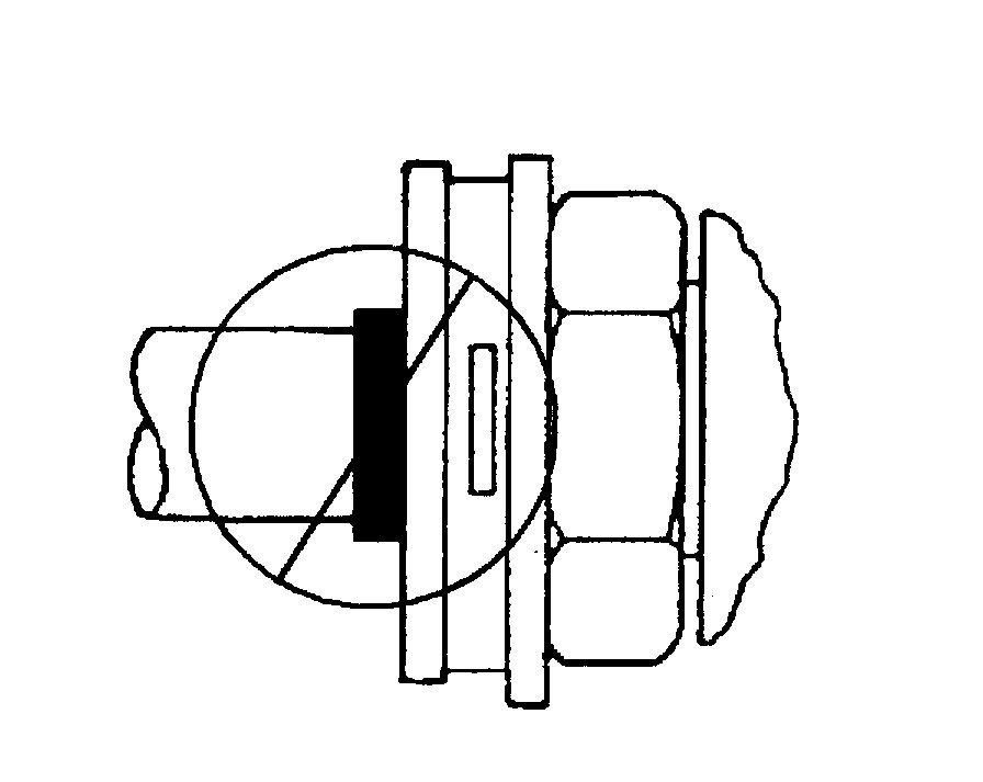

pic 4

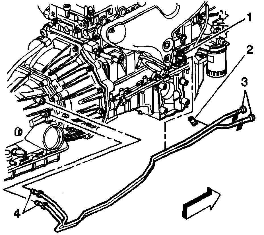

12. Remove the rear sections of the cooler lines from the retainer (1) located on the right side of the engine.
13. Remove the clip (2) that holds the cooler lines together.
14. Support the transmission with a transmission jack.
15. Remove the transmission support.
16. Remove the front exhaust pipe assembly.
17. Carefully lower the transmission to gain access to the cooler line fittings.
18. Place a drain pan under the vehicle.
19. Disconnect the oil cooler lines (4) from the transmission.

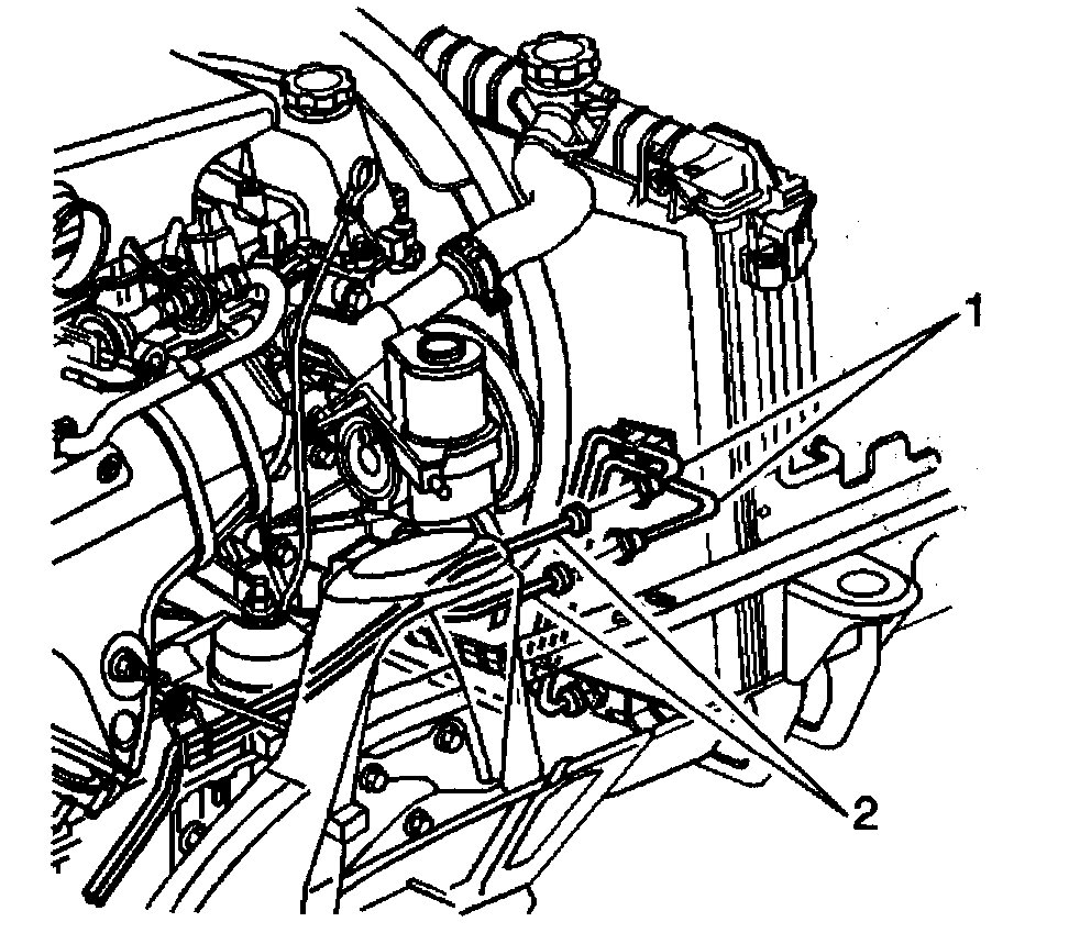

pic 5

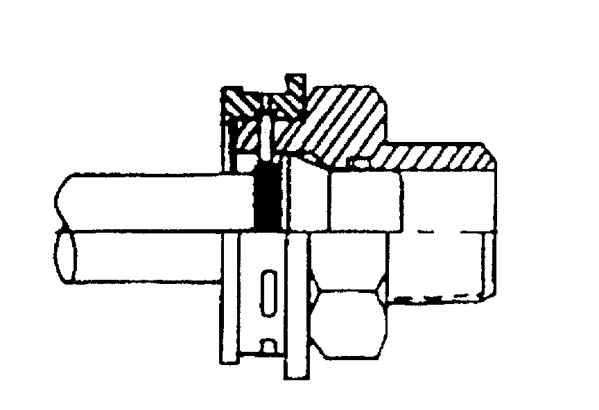

20. Disconnect the rear oil cooler lines (2) from the front oil cooler lines (1).
21. Remove the oil cooler lines from the vehicle.

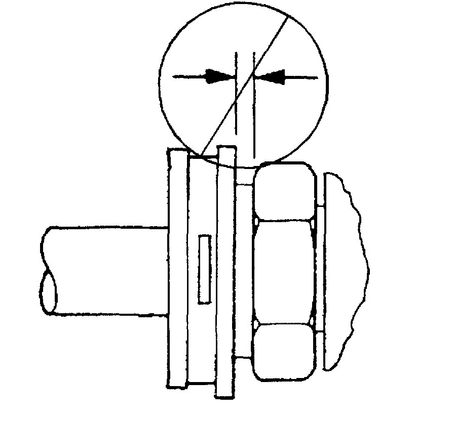

pic 6

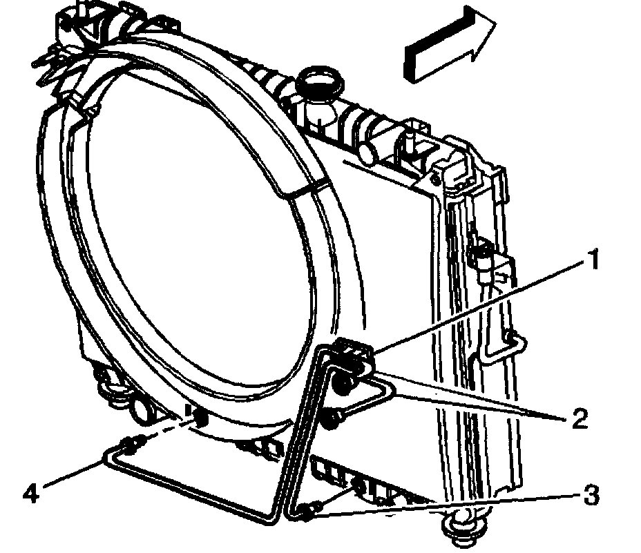

1. Install the transmission oil cooler lines to the vehicle.
Important:
^ Do not reuse any of the existing oil lines or oil line fittings if there is excessive corrosion.
^ Do not reuse any of the existing retaining rings that were removed from the existing quick Connect fittings. All retaining rings being installed must be new.
^ Ensure the following procedures are performed when installing the new retaining rings onto the fittings.
2. Install a new retaining ring (E-clip) into the quick connect fitting using the following procedure:
3. Hook one of the open ends of the retaining ring in one of the slots in the quick connect fitting.
pic 7
4. Rotate the retaining ring around the fitting until the retaining ring is positioned with all three ears through the three slots on the fitting.
pic 8
5. Do not install the new retaining ring onto the fitting by pushing the retaining ring.

Where can I get the transmission lines from?
Nov 20, 2020 at 7:49 PM
  • 110,193 POSTS
You should be able to get them at any parts store such as AutoZone. I know they are manufactured aftermarket by the Dorman company.
