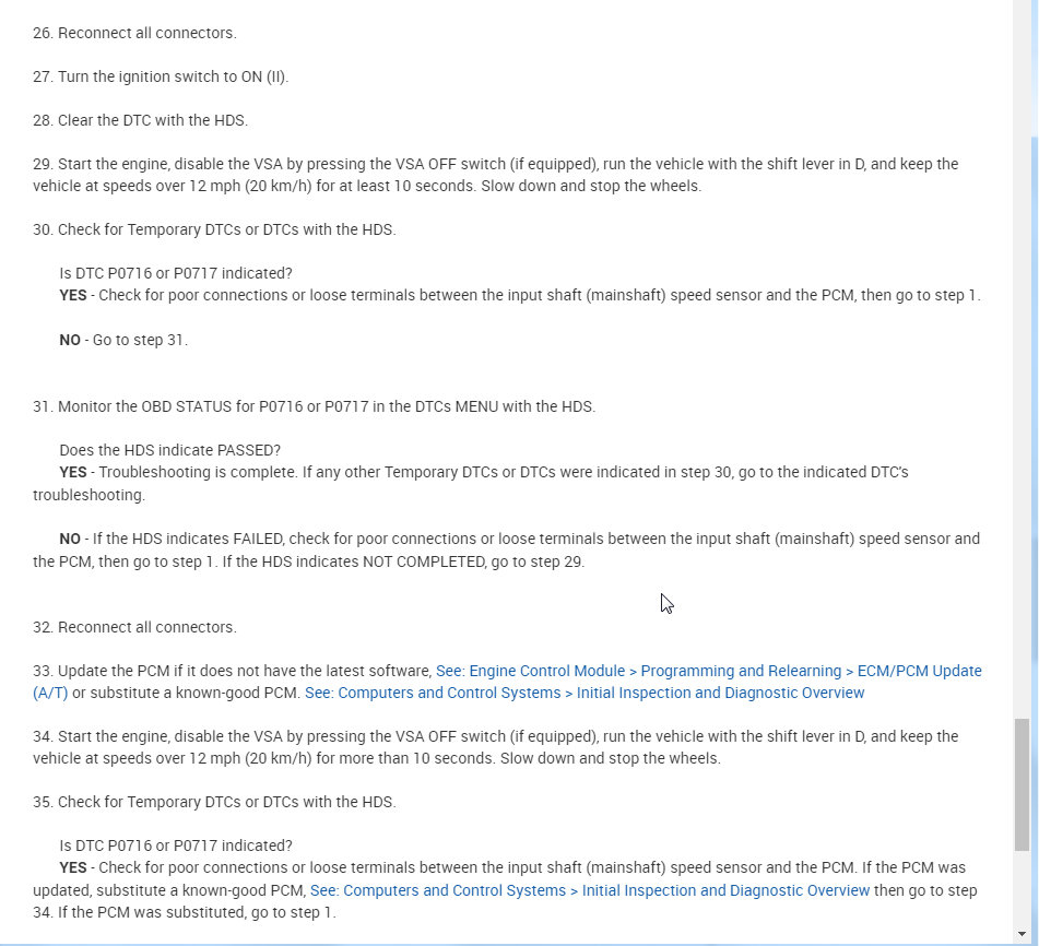

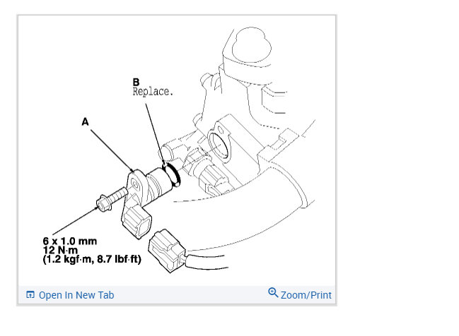

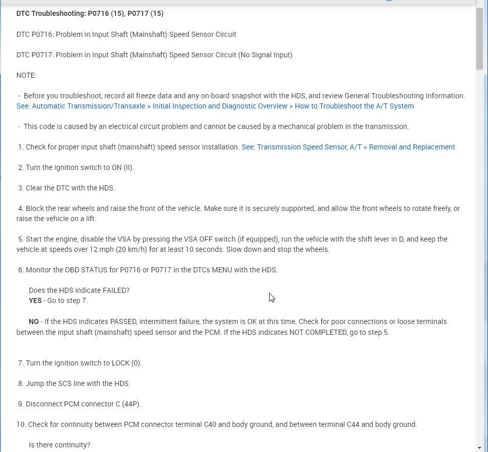

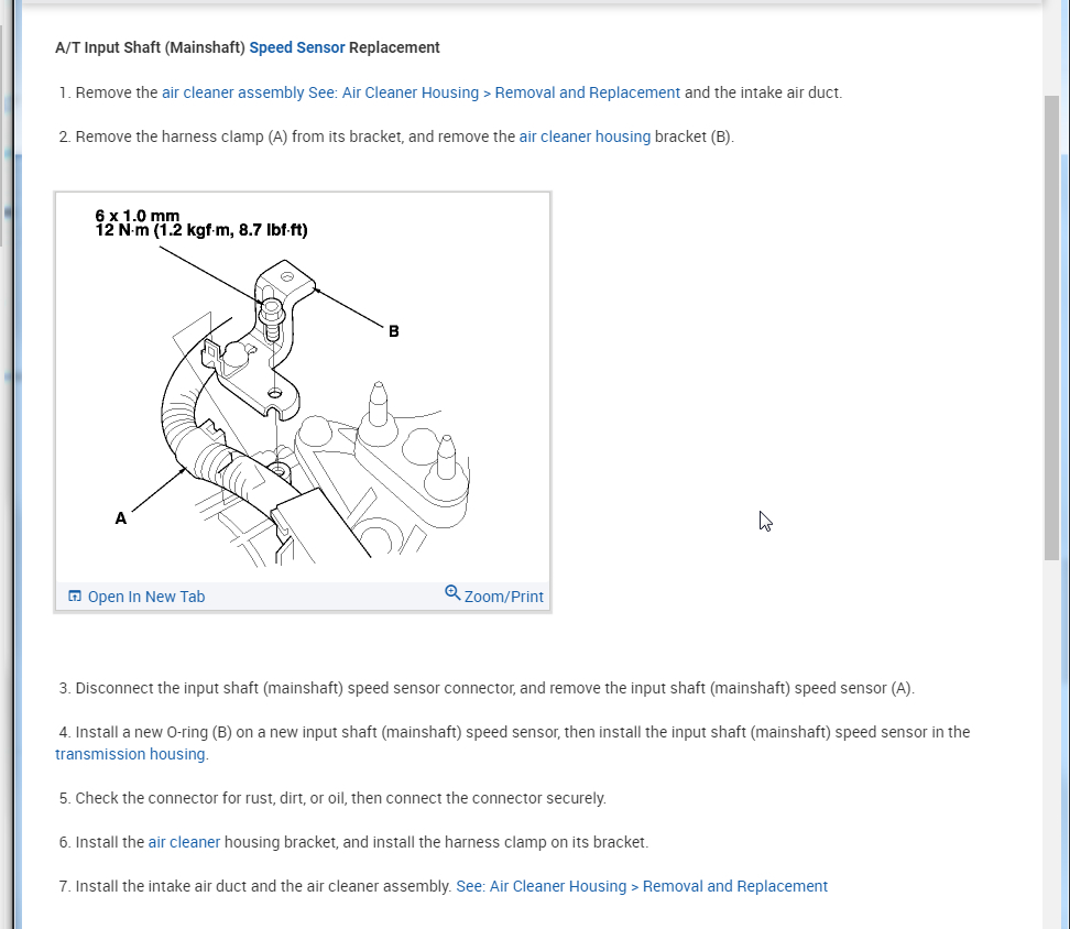

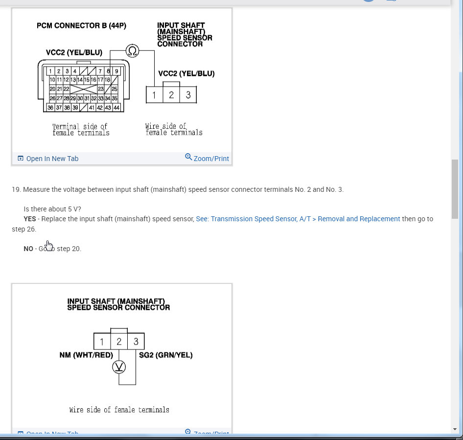

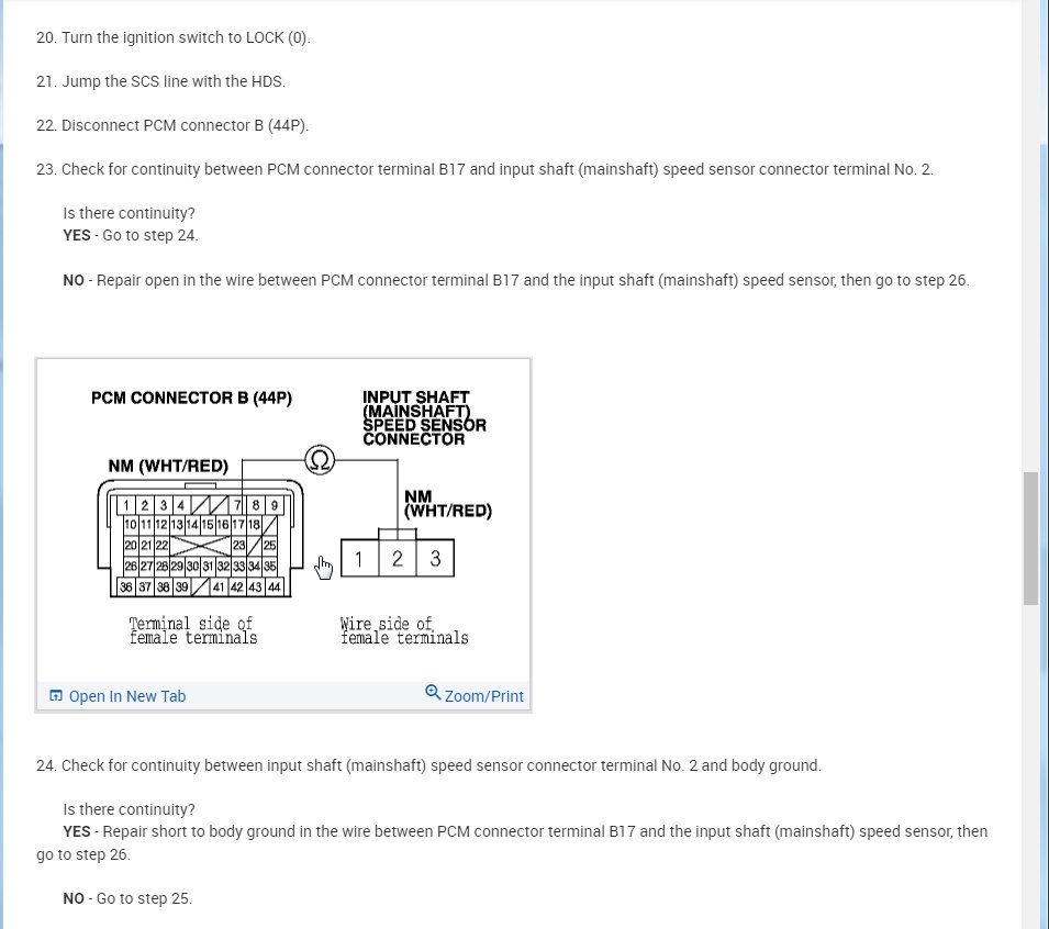

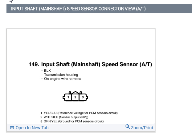

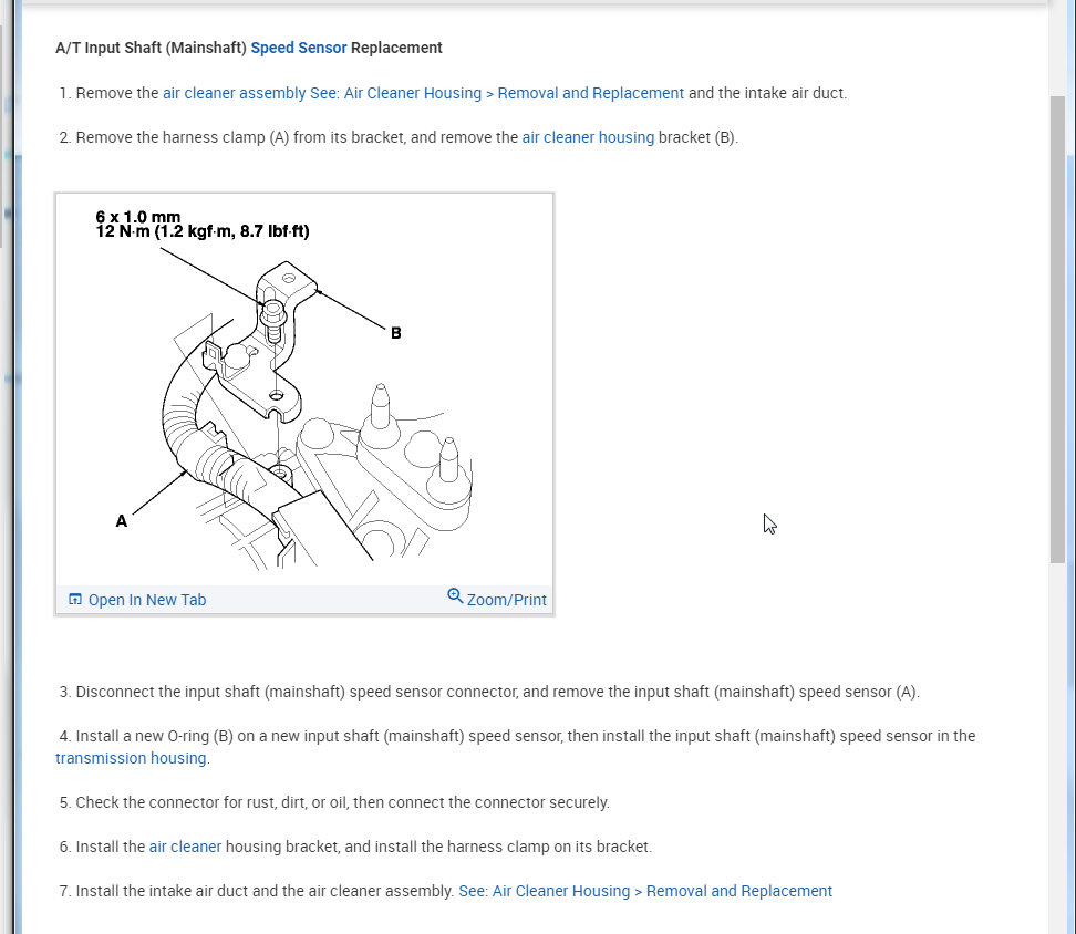

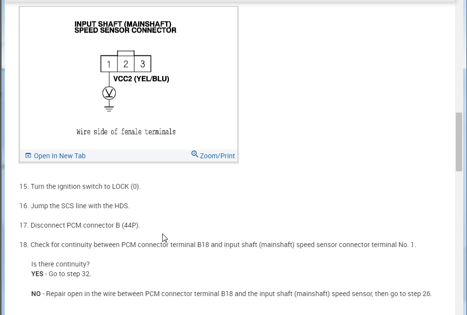

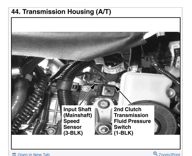

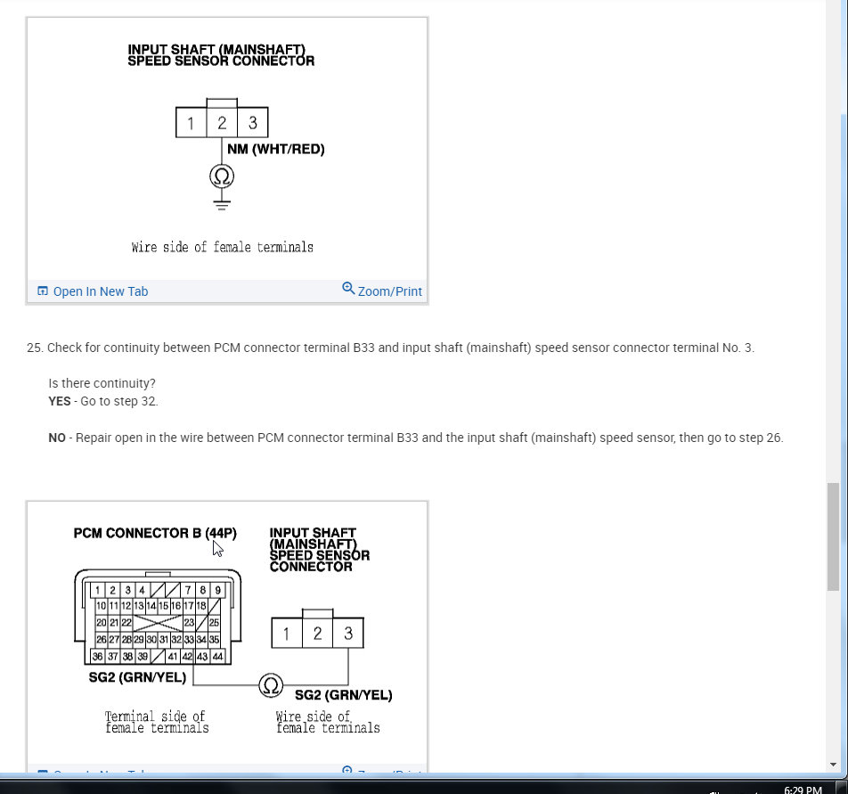

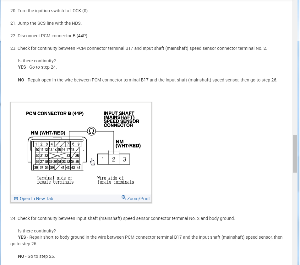

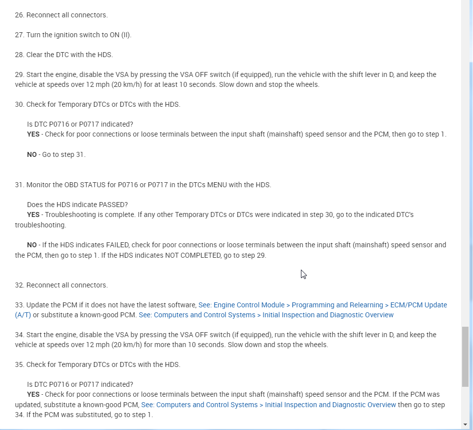

Which is a fault with the input/turbine speed sensor. Where is this sensor and how do I replace it?
Monday, May 18th, 2020 AT 11:20 AM
MECHANIC
18,907 POSTS
P0717 - Input shaft speed sensor failure. No signal
P0718 - Input shaft speed sensor failure. Intermittent signal.

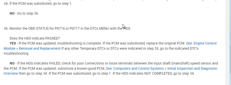

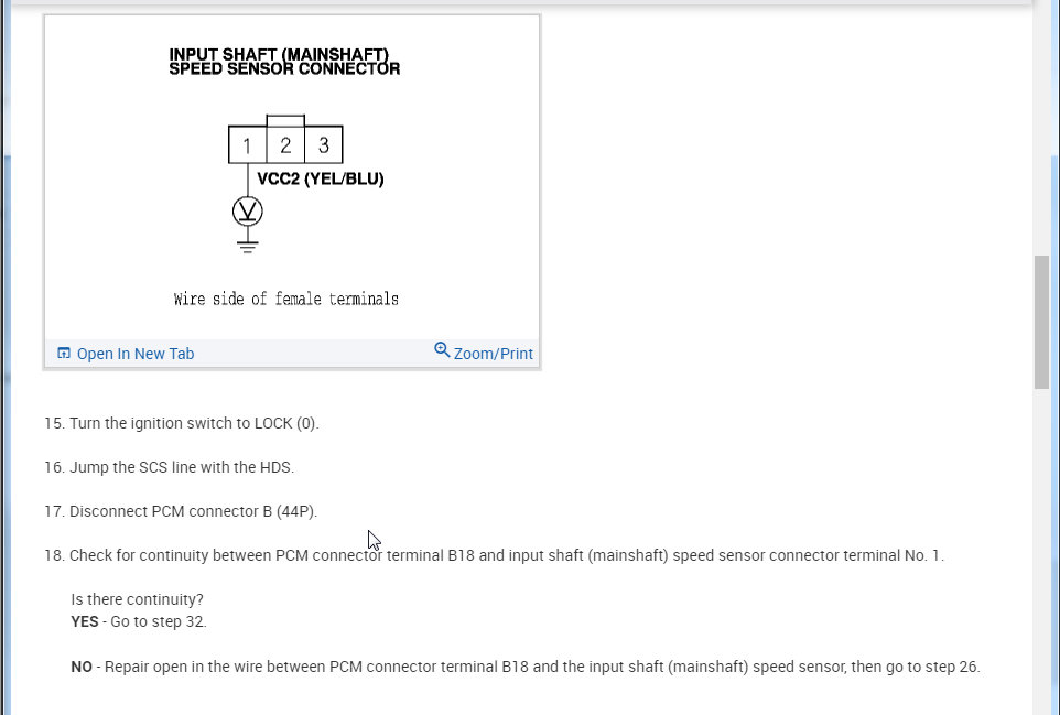

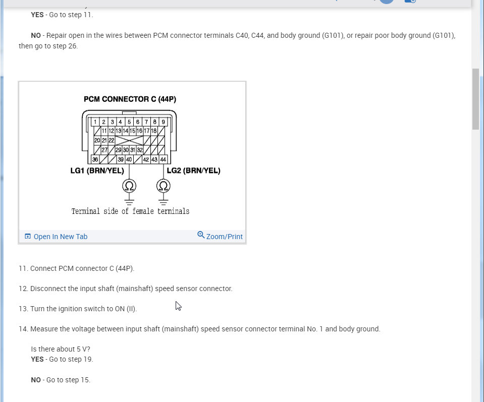

I attached the testing for the p0717 code is you want to run through that to find the issue. I also attached the location and replacement information.
Let me know if you need more info and we can go from there. Thanks
