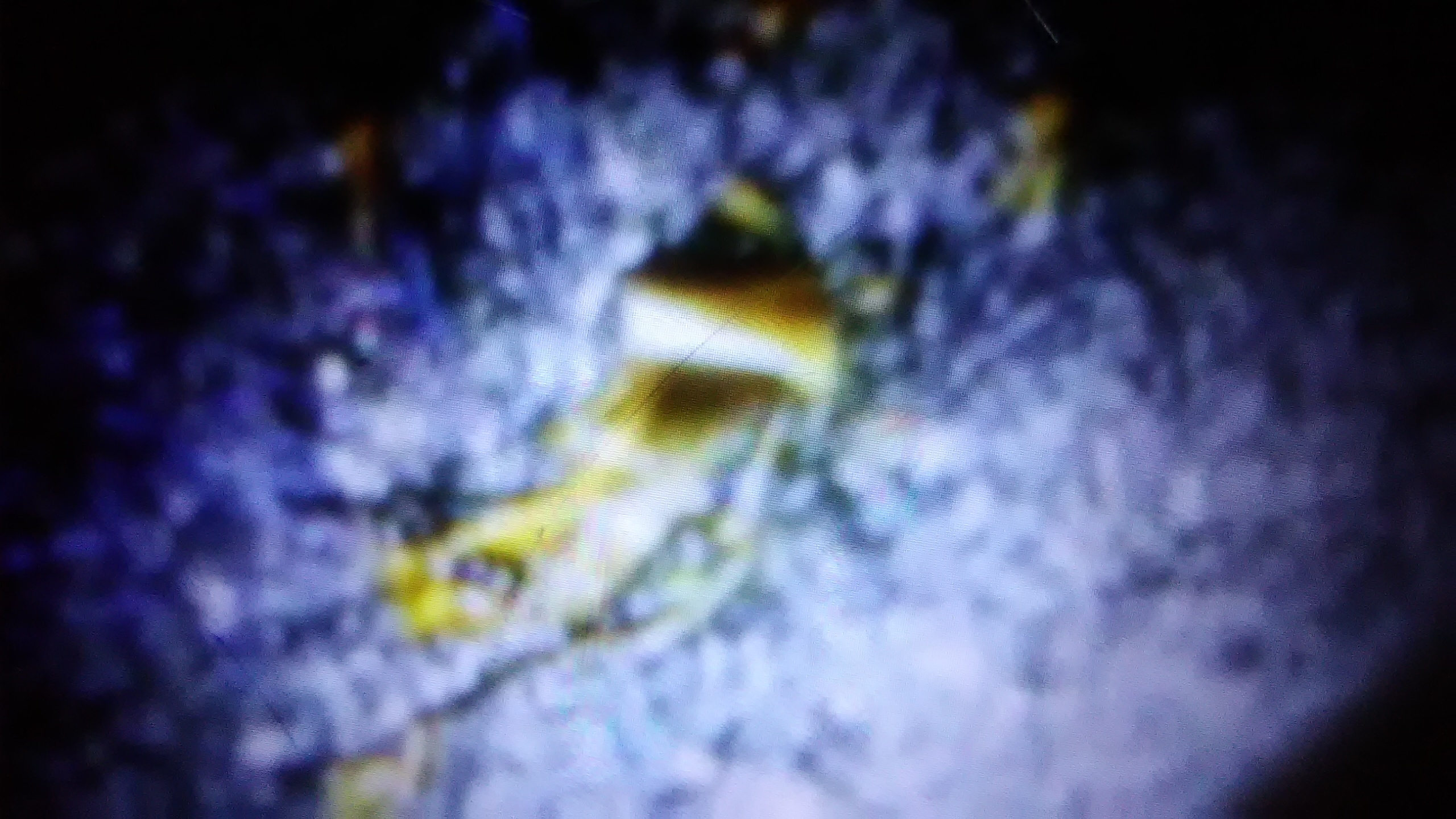

I change the transmission filter. I took the filter apart and they got metal and brass shavings in it.

That metal and brass pieces I came out the old transmission oil filter I took it apart to see what was inside.

Okay, that is not a good sign at all. That tells me there is damage inside the transmission.
Do you have any issues with the transmission?

Started slipping anyone going to gear.

It sounds like it is going to need to be rebuilt. The metal and brass are clutch material.
It may help with a new filter but the end is near for the transmission.
