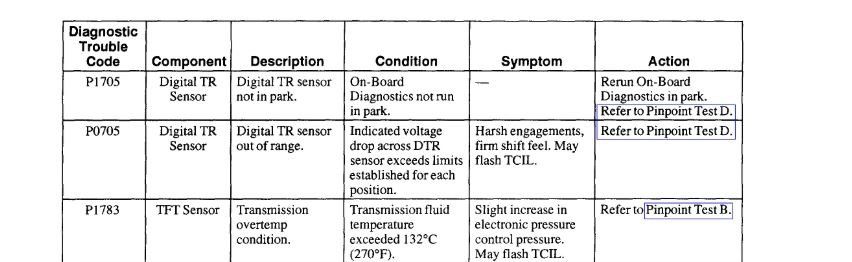

Is it okay to keep driving a vehicle with a check engine light on with a code P0705 transmission range sensor (circuit A) malfunction? Will any serious damage start to occur?
Jul 17, 2018 at 9:05 PM
  • CERTIFIED EXPERT
Good morning.
It could cause shifting issues as well as hard shift and engagements.
It may or may not be the transmission range circuit. Tests need to be done to confirm.
