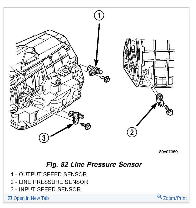

Driving down the road acts like it shifts in to neutral. Changed the shift solenoid, have 2 codes p1762 and p1757.
Friday, January 31st, 2020 AT 7:48 PM

P1762 Dodge | Governor Pressure Sensor Offset Voltage Too High or Low, it looks like the pressure sensor is not working correctly. Here is the location so you can check it out/ replace it/ check the connections. Check out the diagrams (below). Please let us know what you find. We are interested to see what it is.

I replaced the shift solenoid. I'll check out the pressure sensor.

I changed the solenoid. Filled the tranny fluid. Shifts really good, but put it in drive you have to really give it the gas to take off. It acts like it is pulling a heavy load.
