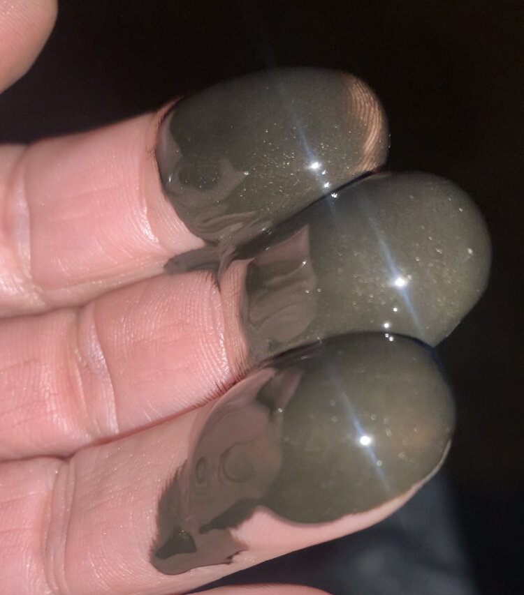

Well, I shouldn’t have spoken so soon, I’m now leaning towards the rear differential as well. After correctly checking the Transmission fluid no bubbles and levels looked perfect, so I decided to take a look at the rear drive shaft universal even though I just had it replaced. Universal is good so I figured while I was under, I’d check the gear oil level again and it is black as coal and sparkling which it definitely shouldn’t be a month after basically having it rebuilt. That was my first thought when I heard the howling starting up a couple weeks ago but the mechanic who rebuilt it keeps telling me it’s the T-Case or trans. To be fair I am still 350 miles from home so he hasn’t looked at it but he doesn’t even want to entertain the fact that it could be something wrong with the rear end that he just built. I’m no mechanic but even I know the gear oil in this pic that is barely a month old shouldn’t look like this. I’m assuming they didn’t balance the rear drive shaft maybe which is probably making the clunking I hear/feel when I let off the gas pedal quickly.
Jan 3, 2023 at 3:27 PM
  • 54,128 POSTS
Yep, that is bad, something went wrong inside the differential. I would forward the image to your mechanic to let him know.
