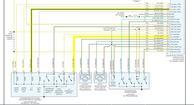

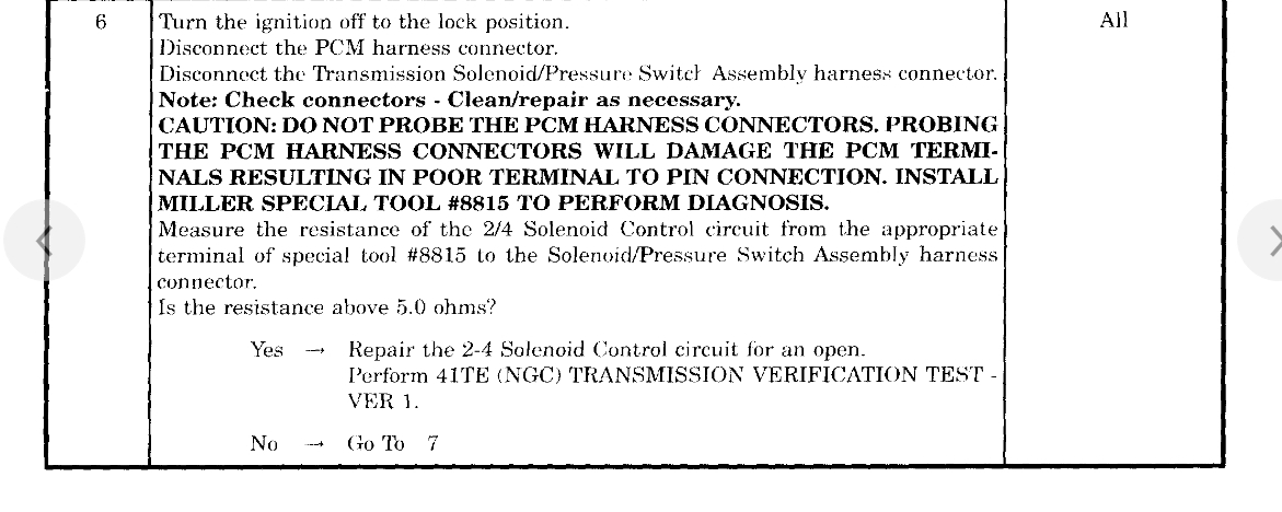

Dtc code came up p0700 and p0755. I replaced input and output sensors and dtc code p0755 cleared away. But still have p0700 code why still on since I replaced both sensors?

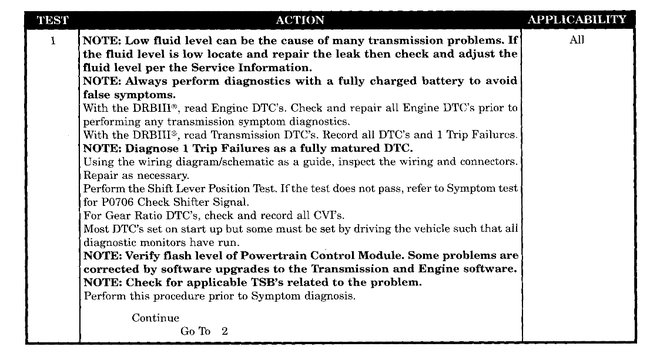

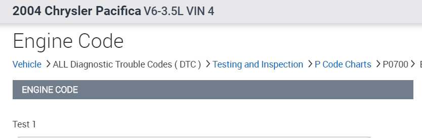

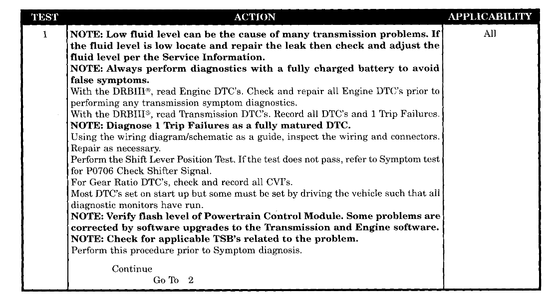

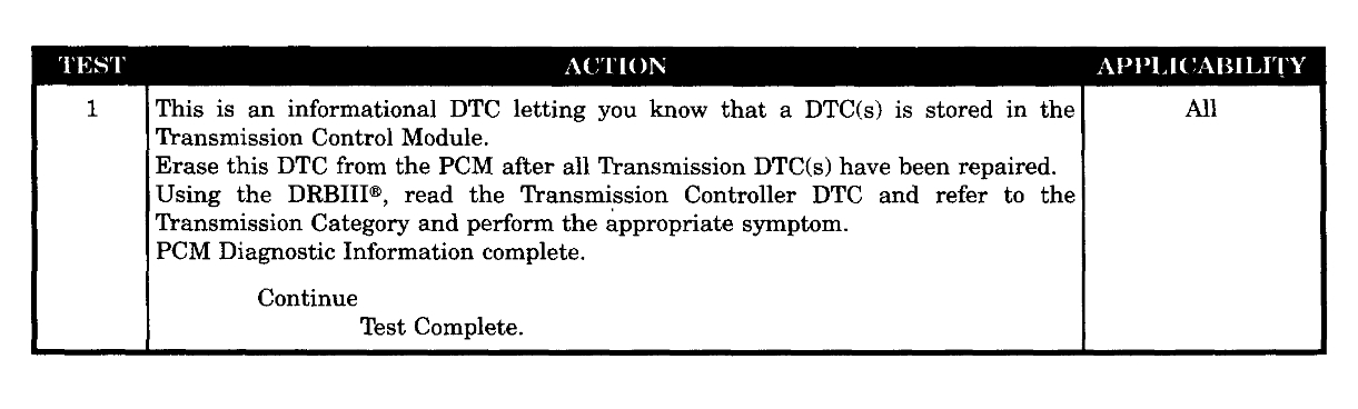

This Direct Trouble Code (DTC) is just an informational DTC letting you know that there are transmission DTC's set. I have included the factory description of this DTC in the diagrams down below. Please go through this guide and get back to us with how everything turns out.

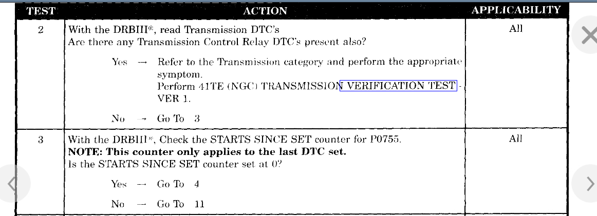

I don't have DBR lll tool I have regular scan tool.

The 700 indicates a general transmission code. It says there is a fault stored in the system. There should be another code listed. Recheck and see if there are any other codes listed.

My car doesn't shift to overdrive seems like it is in low one but only c okay Dr is p0700. Use to have code p0755 but replaced input and output sensors and only code p0700 came back.

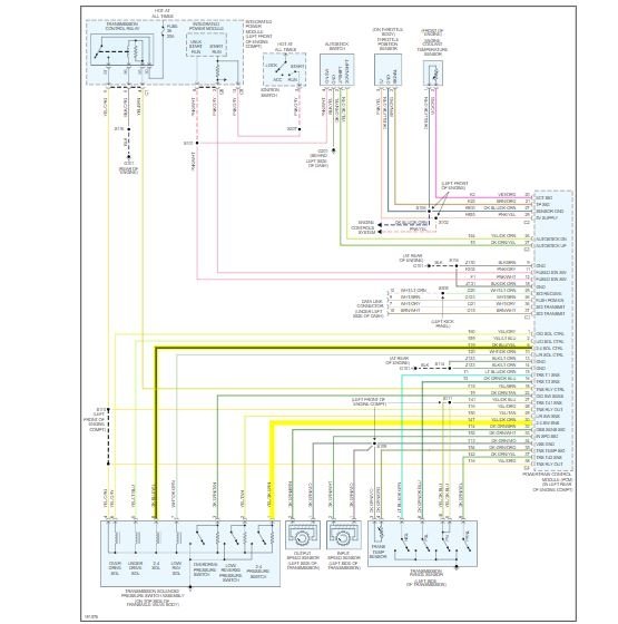

The code has nothing to do with the sensors. It is all about the 2-4 shift solenoid.
I listed the possibilities below for you to view. These items need to be checked for the failure. It may be just the solenoid or it may be wiring to the solenoid.
How long since you changed the fluid and filter?

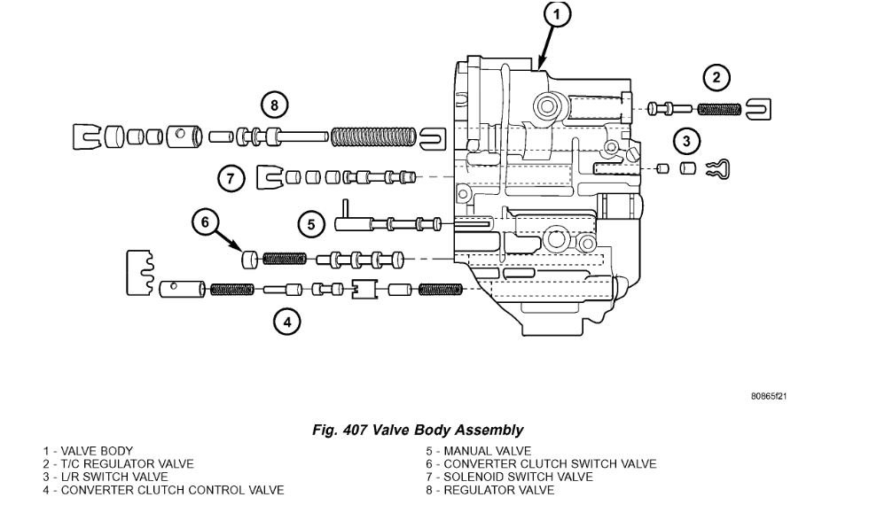

I attached a picture of the valve body. The solenoids are at the valve body and control the shifting of the transmission based on other sensor inputs.

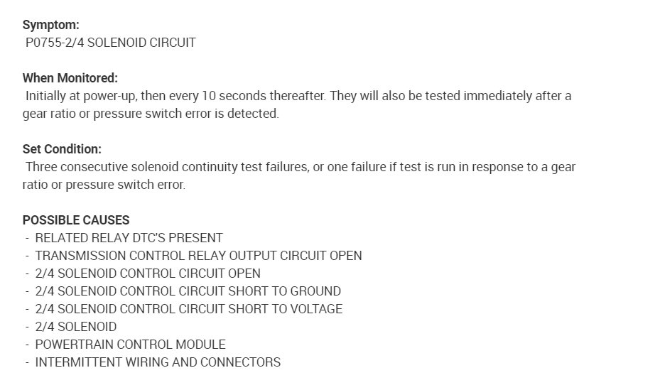

P0755
Descriptor
2/4 Solenoid Circuit
Probable Causes
2/4 Solenoid
2/4 Solenoid Control Circuit Open
2/4 Solenoid Control Circuit Short to Ground
2/4 Solenoid Control Circuit Short to Voltage
Intermittent Wiring and Connectors
Powertrain Control Module (PCM)
Related Relay Diagnostic Trouble Codes (DTC's) Present
Transmission Control Relay Output Circuit Open
Thursday, August 15th, 2019 AT 3:49 PM (Merged)

Yea, I have changed the filter on Saturday fluid looked good red with little shavings. I have not changed the solenoid pack yet. I know AutoZone has for $158.00 going to do that.
Thursday, August 15th, 2019 AT 3:50 PM (Merged)
Hello again,
Make sure you verify voltage to the solenoid pack as well.
The shavings are not a good sign at all. Those could be in the valve body not allowing the valve to move for shifting.

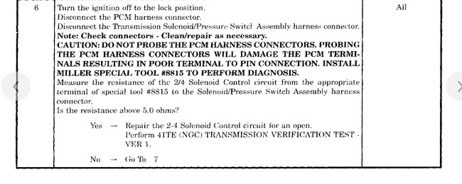

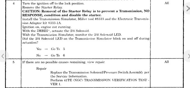

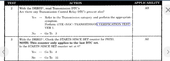

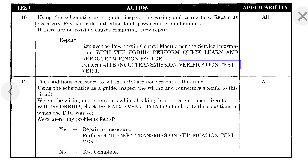

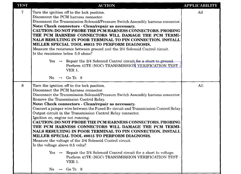

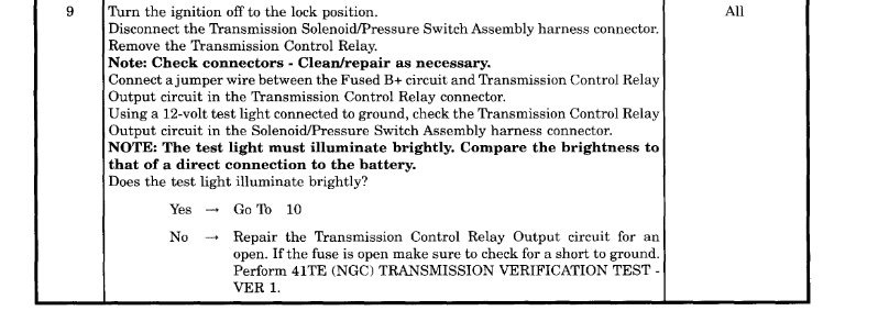

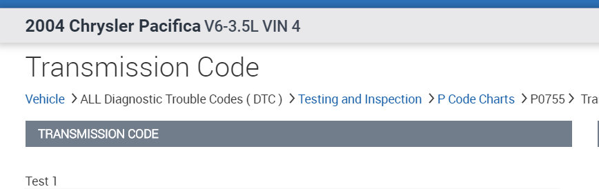

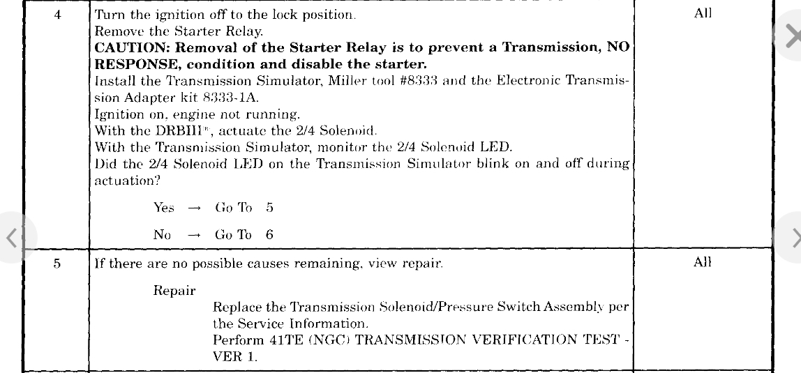

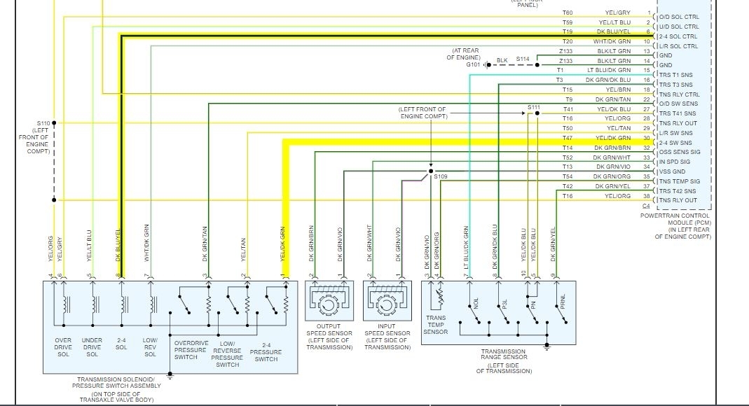

In the diagrams down below I have included the factory diagnostic troubleshooting guide for Direct Trouble Code (DTC) P0755 for your vehicle. Please go through this guide and get back to us with what you are able to find out.
