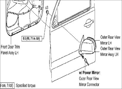

OUTER REAR VIEW MIRROR ASSY LH
COMPONENTS
Fig. 51: Identifying Outer Rear View Mirror Assy LH Components
Courtesy of TOYOTA MOTOR SALES, U.S.A., INC.

7. REMOVE OUTER REAR VIEW MIRROR ASSY LH
a. Disconnect the outer rear view mirror connector (w/Power mirror).
b. Remove the 3 nuts.
c. Disengage the claw and remove the outer rear view mirror.

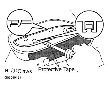

8. REMOVE OUTER REAR VIEW MIRROR LH
. Apply protective tape to the outer circumference of the outer rear view mirror, as shown . See Fig. 53.
https://www.2carpros.com/forum/automotive_pictures/248015_3_77.jpg
a. Using a screwdriver with its tip taped in protective tape, disengage the 2 claws.
b. Disengage the 2 claws and remove the outer rear view mirror.
Fig. 53: Removing Outer Rear View Mirror LH Claws

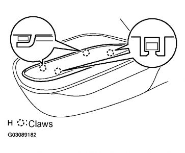

9. INSTALL OUTER REAR VIEW MIRROR LH
. Engage the 2 claws into the outer rear view mirror.
a. Engage the 2 claws and install the outer rear view mirror.

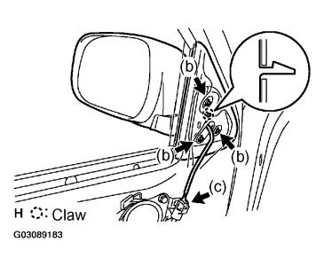

10. INSTALL OUTER REAR VIEW MIRROR ASSY LH
. Engage the claw and install the outer rear view mirror.
a. Tighten the 3 nuts.
Torque: 8.0 N.m (80 kgf.cm, 71 in.lbf)
b. Connect the outer rear view mirror connector (w/Power Mirror).
Fig. 55: Tightening Outer Rear View Mirror Assy LH Nuts
https://www.2carpros.com/forum/automotive_pictures/248015_5_34.jpg

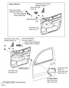

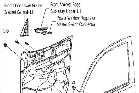

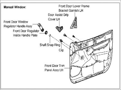

Thanks for your help thus far. My real difficulty is getting the door panels off--could you provide a clearer graphic of that process? The subsequent graphics of the actual R&R are terrific, but the door graphic, even when enlarged, is extremely difficullt to visualize. Thanks for your efforts on my behalf.
Friday, February 20th, 2009 AT 8:24 AM
IMPALASS
  • 3,112 POSTS
Hello -
Is this the pic you are talking about?
I had to break it down into 3 parts. . .. . .. . .so overlap and piece together.
If this does not work go into the PM and send me your email address and I will try that way. If that doesn't work we can try a fax if you have a number.
https://www.2carpros.com/forum/automotive_pictures/248015_Picture1_57.jpg
https://www.2carpros.com/forum/automotive_pictures/248015_Picture2_43.jpg
https://www.2carpros.com/forum/automotive_pictures/248015_Picture3_28.jpg
Friday, February 20th, 2009 AT 4:24 PM
