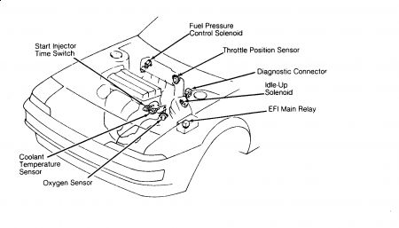

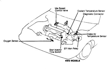

The front one (dark orange) is coolant temp. the one that is closest to radiator. The one wire is gauge sender, then fan switch (points towards battery) next is Bi-Metal switching valve, has two vacuum lines coming out. The rear one next to waterpump hose is the one I can't remember, the connector is green.
Toyota should have all these, I have purchased most of them in the last year.
Talk to a different Toyota dealer parts dept.
You can also get these at junk yard from 90-92 Toyota Corolla or 90-92 Geo Prizm.
https://www.2carpros.com/forum/automotive_pictures/108325_Toyota_1_1.jpg
https://www.2carpros.com/forum/automotive_pictures/108325_toyota_2_1.jpg
