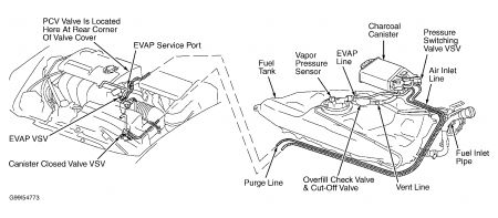

On my 02 celica, about 5 months ago I replaced the motor with one with only 32,000mi runs great BUT the next day the speedo started to flicker it would work then stop but always start working again within seconds. So about a month of that and it stop working all together. I have replaced the speed censor on the tranny and tried 3 dash clusters the tack works great it's only the cruse control, speedo and odometer. I have gone through every fuse twice or three times all the wiring looks good all the way back to the fuse box, I had to cut open the wire loom and still all good! Please help i'm about to take it to the dealer because the easy fix is not so easy anymore. Also every time I fill up with gas now and only when I fill up the tank the car will die within 30sec of starting? But after a start or two it runs great again.

Is there voltage on Red/Blue wire at VSS? As for fuel tank maybe faulty purge or air valve when you fill up do you stop when fill handle stops or pump a few more into tank.

Ok, all I needed was alittle help. It was the back up censer on the tranny, I unpluged it and put a new fuse in and it works great. Now the fule isue. I live in oregon we dont pump r gas, I like it that way lol. But sometimes they cap it off and other times as soon as it clicks off they hang it up. This also started rite after I put in the new motor.

Good to hear speedo is working why TOY powered VSS off back up who knows. Fuel issue see diagram and see if the two purge hoses from engine to tank where hooked up.
https://www.2carpros.com/forum/automotive_pictures/198357_Graphic_459.jpg
