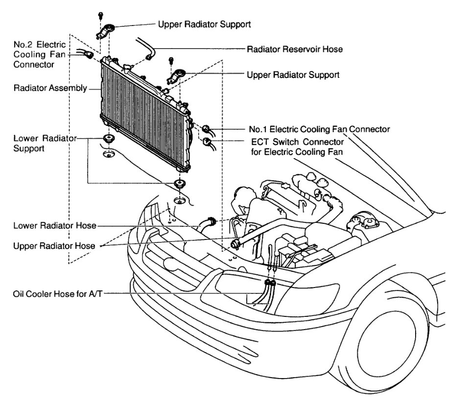

There is a small leak at the top of the radiator -- water indicator in dash is normal. Do I need to replace immediately or can I drive in mountain conditions for another 140 miles
Thursday, October 22nd, 2009 AT 10:19 PM
15 Replies
JOE C.
  • 25 POSTS
I wouldn't. If you need one, why take the chance. Too costly if it blows the engine, the head gasket, or cracks a head from overheating. Just replace it and be done with it . If cost is an issue I would use aftermarket instead of the dealer. To get even lower price you can use a junk yard radiator. I've never gotten a bad one from a junk yard but you can always pressure test it yourself or take it somewhere to be pressure tested before installing it.
Here is a guide to help you replace it with the instruction for your car in the diagrams below.
https://www.2carpros.com/articles/how-to-replace-a-car-radiator

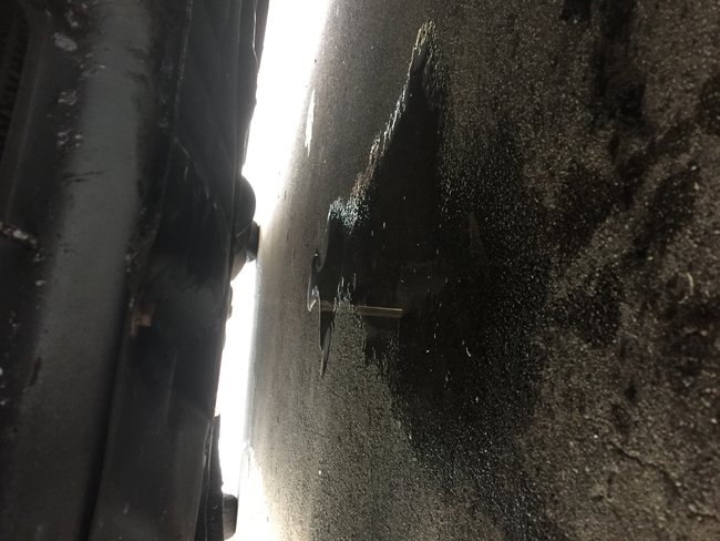

It looks like I have a leak on my radiator after I accidentally hit my car pulling from the curb. It did make a noise when it happened. It is leaking a yellowish fluid and I think it is leaking the coolant. I am afraid my mechanic will tell me the radiator is broken on the bottom and will have to replace. Is it possible to make a small fix before I spend a lot of money? What do you recommend? Thanks.
Thursday, April 30th, 2020 AT 3:08 PM (Merged)
CARADIODOC
  • 34,485 POSTS
Do not do anything until you have a proper diagnosis. This could be as simple as a rusted hose clamp. If the radiator is damaged, do not waste your money trying to repair it. The cooling system gets up to fifteen pounds of pressure, and patches do not hold up to that. What if that patch lets go on a Saturday night, out in the country, when it is 30 degrees below, and you are on a hot date? The disappointment will be over-shadowed by the potential expensive damage that could occur to the engine.

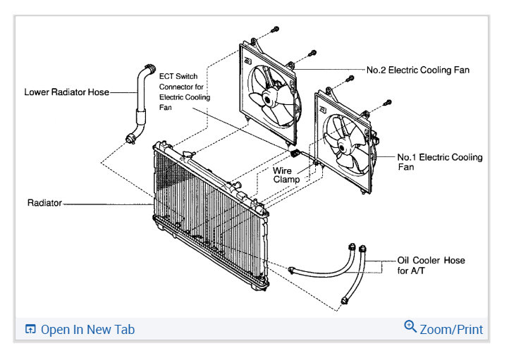

My cars fans wont turn off and there drianing the battery. Checks radiator levels, checked for leaks they work normally whrn care is on they even turn off but once I turn off and take the key out they turn on. I was told it might be a relay or sensor any thoughts help thanks.
  • 75,992 POSTS
Inspect and test the fan relay-sounds like its sticking closed
MADDOGG13
  • 6 POSTS
Which relay exactly is it would you happen to have a picture or a description thanks in advance
  • 75,992 POSTS
You're looking for the fan relay no.1 which is located in the J/B left side of engine compartment-sorry no pic available
