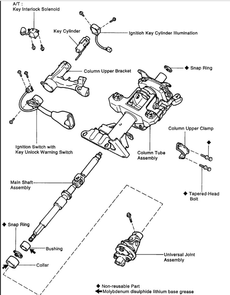

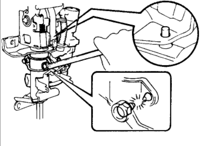

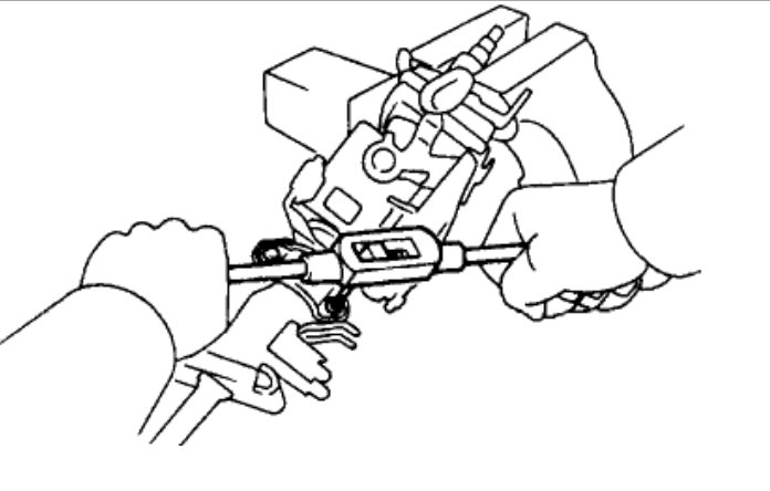

to remove the ignition switch you must remove the steering column cover to get started. Disconnect the battery as well.
Using a centering punch, mark the center of the 2 tapered-head bolts.
Using a 3 - 4 mm (0.12 - 0.16 in.) Drill, drill into the 2 bolts.
Using a screw extractor. Remove the 2 bolts.
INSTALL COLUMN UPPER BRACKET AND COLUMN UPPER CLAMP
Tighten the 2 new tapered-head bolts until the bolt head breaks off.
Here are some diagrams to help you get the job done. (Below)

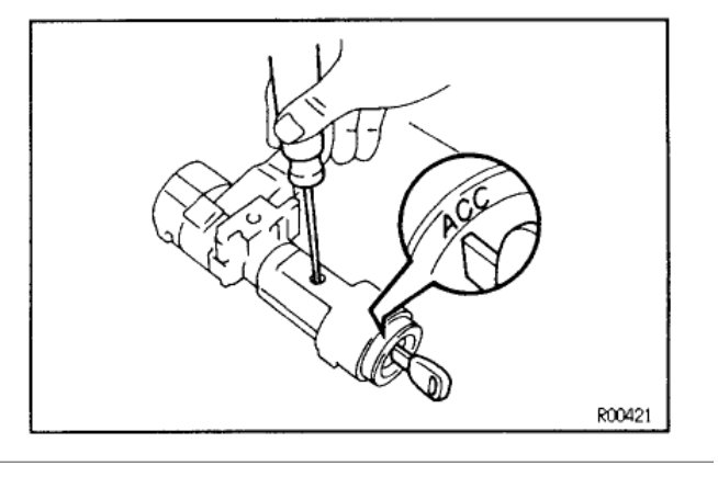

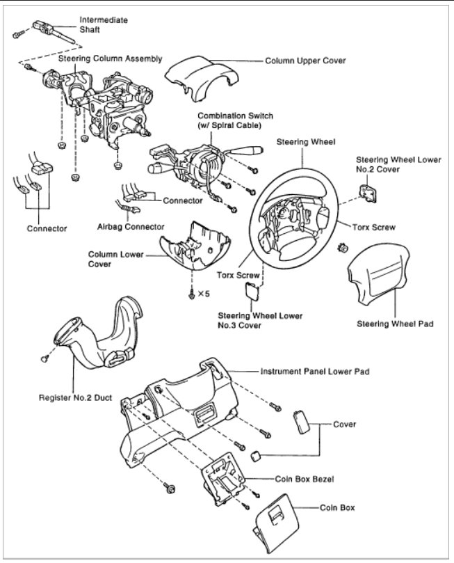

BLUELIGHTNIN6
  • 16,542 POSTS
Disconnect the negative battery cable.
If equipped with an air bag, wait at least 90 seconds before working on the vehicle.
Remove the lower steering column cover. Unfasten the ignition switch connector under the instrument panel.
Remove the screws which secure the upper and lower halves of the steering column cover.
Turn the lock cylinder to the ACC position with the ignition key.
Push the lock cylinder stop in with a small, round object (cotter pin, punch, etc.).
On some vehicles, it may be necessary to remove the steering wheel and combination switch first.
Withdraw the lock cylinder from the lock housing while depressing the stop tab.
To remove the ignition switch, unfasten its securing screws and withdraw the switch from the lock housing.
