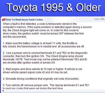

Try reading the codes, check engine light should be on? Here's how to read the codes...
https://www.2carpros.com/forum/automotive_pictures/62217_95AndOlder1_1.jpg
https://www.2carpros.com/forum/automotive_pictures/62217_95AndOlder2_1.jpg
https://www.2carpros.com/forum/automotive_pictures/62217_95AndOlder3_1.jpg
This last part is the driving test mode..
