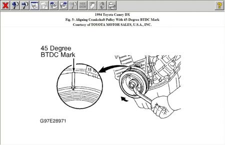

i need help on how to put it the timng chain on to start the car

Put the engine no.1 piston on compression stroke/TDC and then align below
