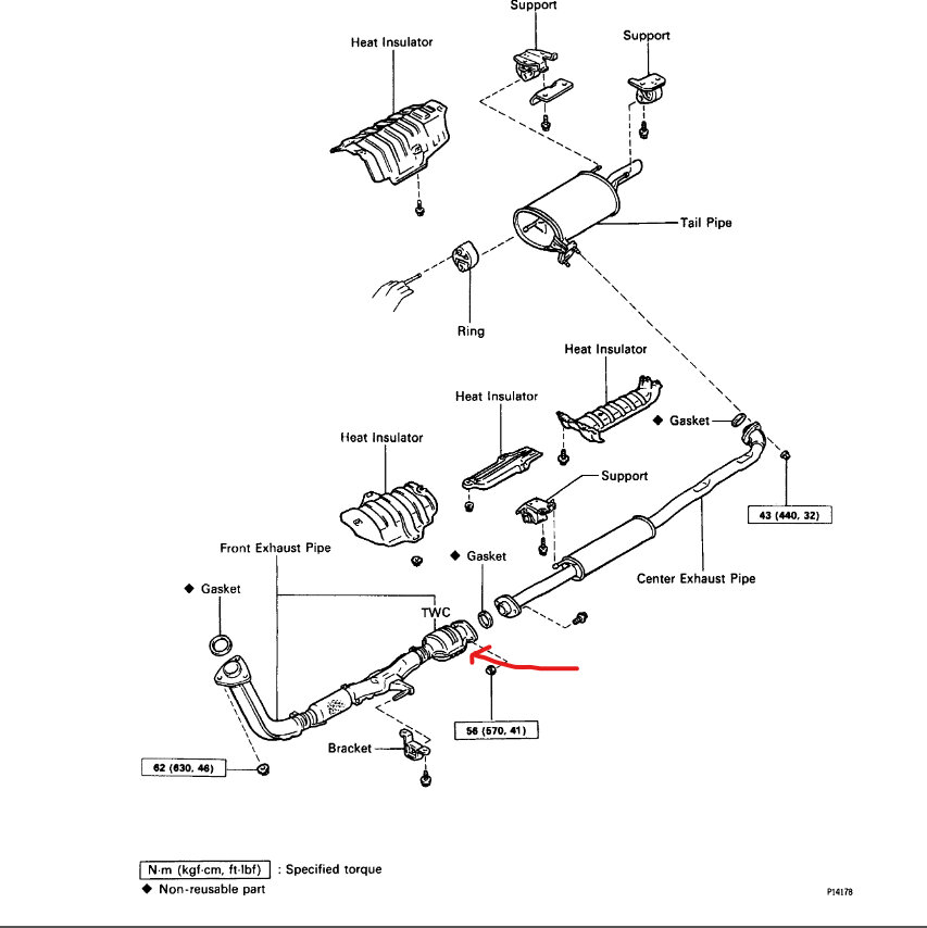

94 toyota fails emissions for nox it was 2100 when it should be below 1006. What needs to be repaired and what is the average cost

Have the exhaust gas recirculating valve check out-its purposes it to reduce nitrogen oxides-Nox

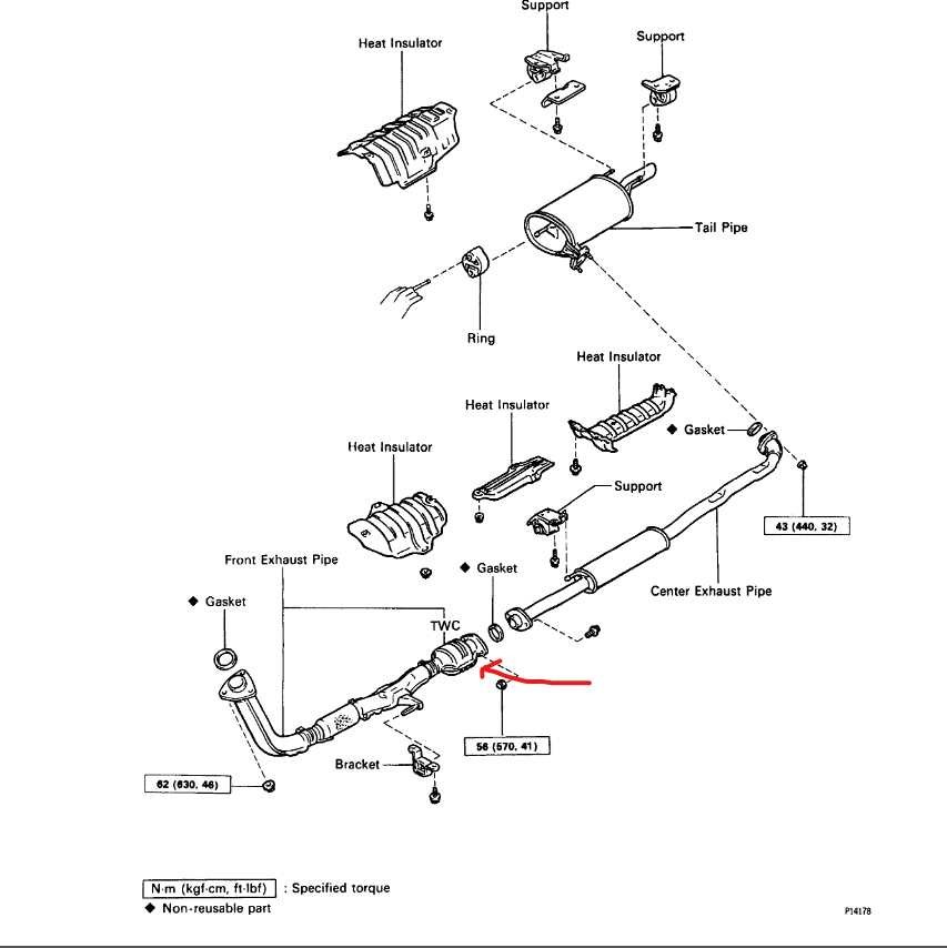

Also, a worn out catalytic converter can cause high nox as well. FYI, this guide may be able to help as well.
https://www.2carpros.com/articles/smog-test-inspection-information
Here is the location of the cat so you can have it checked out. Check out the images (below). Let us know how it goes
