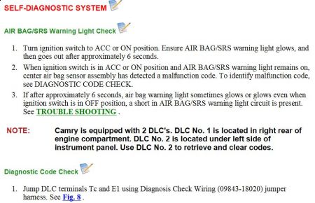

Thanks for your help. I didn't think the problem was with the plugs at all (or the wires). So I started googleing and found out the problem could also be related to the distributor. So I took it apart and, thanks to google, there was my problem. The copper cable inside the distributor was all loose and broken and nasty. Bought a new distributor and replaced it last night. Car works fine again. The only think I need to get fixed now is the airbag light that has been on for 3 months now. I had a bad fuse and when replacing it, the airbag light went on and has been on ever since. Any suggestions?
Friday, June 19th, 2009 AT 9:50 AM
KHLOW2008
  • 41,814 POSTS
Glad you have solved your problem and sorry for the delay in replying.

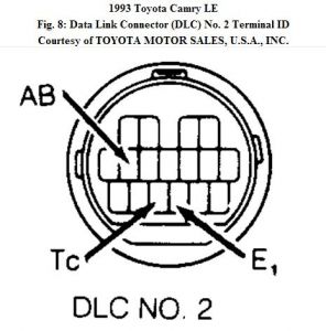

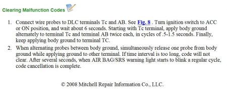

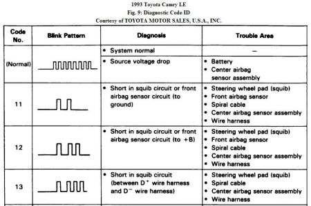

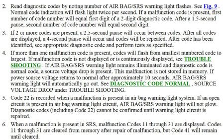

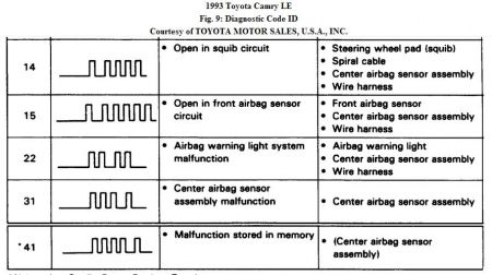

An error in the airbag system has been detected and you need to retrieve the trouble code to know what could possibly cause it. Here are the procedures.
