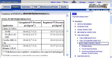

Got fuel pressure measured at the top of the fuel filter and it is 46psi. But I don't think it is to to the point where it won't let the engine crank over (start).

Do this and recheck the fuel pressure-1st blow thru the return line and check the fuel pressure and see below
http://www.2carpros.com/forum/automotive_pictures/12900_fuel_pressue_camry_1.jpg
