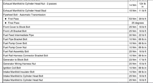

What are the torque specs for intake and exhaust manifold?

Good morning,
I attached the torque specs for you.
Image (Click to make bigger)

There is no order of torque sequence.

Center out.
