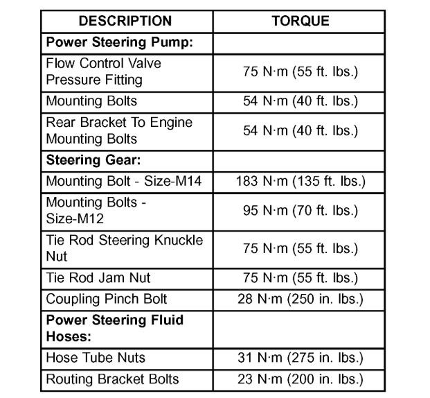

What is the torque specs for the outer tie rod end?

Good afternoon.
Attached is the specs for the steering for you. Check out the diagrams (Below). Please let us know if you need anything else to get the problem fixed.
Image (Click to make bigger)
