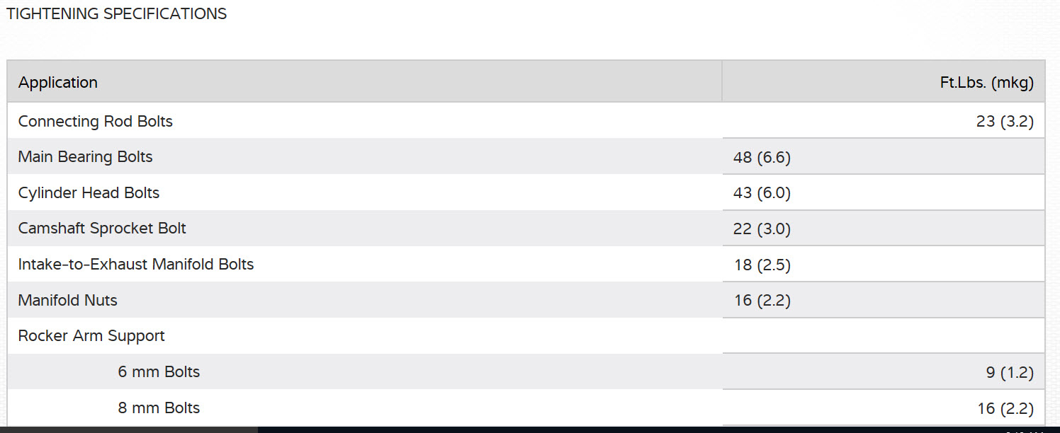

EB2 engine, I am planning a full rebuild, so what are the correct torque ratings for the head, crank shaft and rods?

See pic this is all we list
Image (Click to make bigger)
