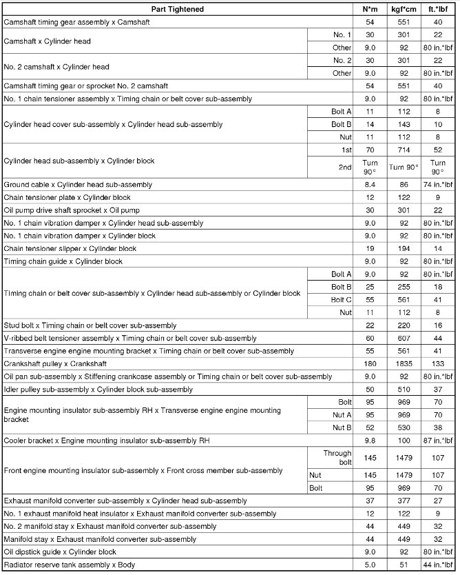

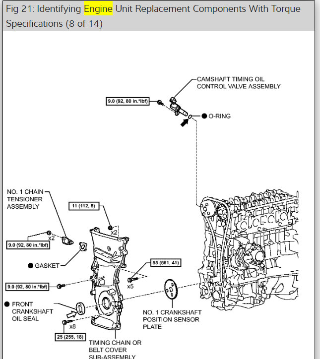

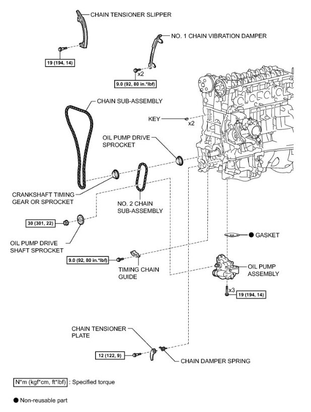

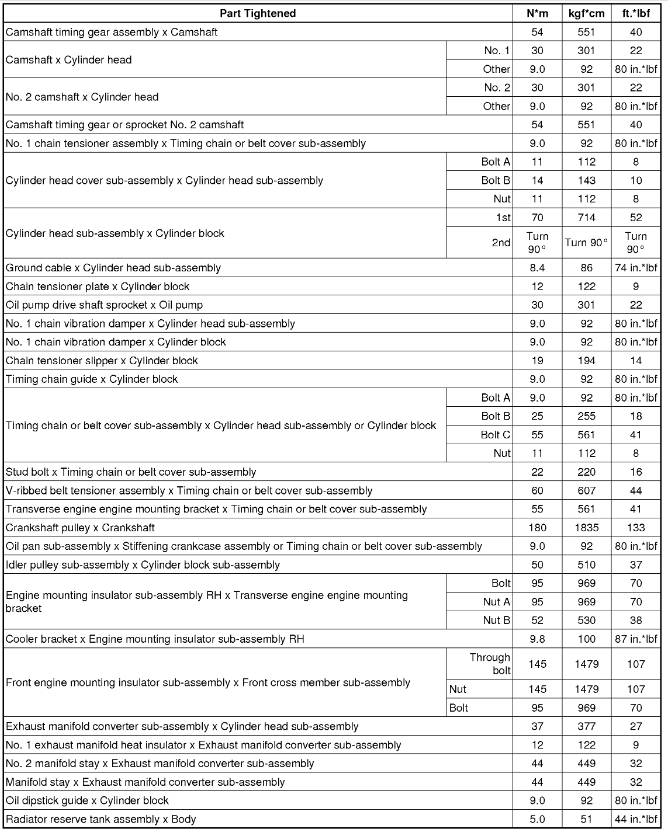

I am going to replace the timing chain tensioner to see if that will quiet up a rattle noise. I am looking for the service manual steps to replace it and torque value for the two nuts holding it on. Also, the gasket I will probably have to buy from Toyota. I already bought a tensioner and watched similar videos on other Toyota cars but want the specific manual procedures for this vehicle listed above timing chain tensioner change.

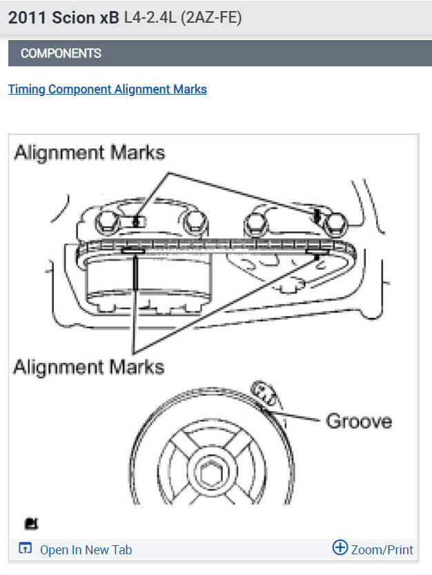

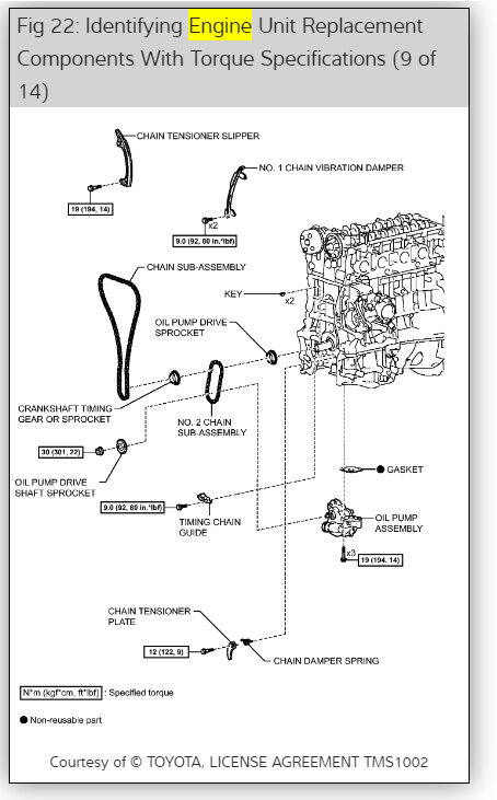

Yep, a worn tensioner and chain will cause a rattling noise at the front of the engine while it is running. I would install a new timing chain and guides since you are going to be in there anyway. Be sure to clean the gasket surfaces, which will help seal the gasket so you will have no oil leaks. Here are the torque specs as well for the engine and timing chain components. Check out the images (below). Let us know if you need anything else.

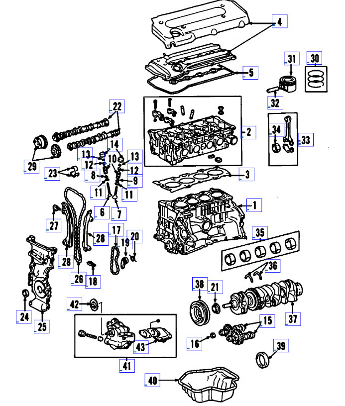

Thanks for the help so far. This is all good info. I am actually specifically looking for the factory service manual steps to replace the tensioner (#27 depicted in the diagram). I plan to just remove and replace that tensioner for now. This task involves removing the old tensioner and installing the new one with the hook on the new tensioner in place when installing. Then the engine is rotated at the crank by hand in such a specific way according to the FSM so that the hook releases the tensioner against the slipper and the chain does not skip a tooth. I really want to know what the factory service manual says for this task which I believe is rotating the crank counter-clockwise slightly to release the hook on the newly installed tensioner. Next the crank should be rotated clockwise in normal engine rotation, and this will allow the tensioner to extend out against the slipper. Factory written procedure is what I am looking for. Thanks!

The tensioner pushes on #28 in the exploded view diagram you provided which is called a " chain tensioner slipper". Yes, basically it is a guide. I was just trying to use the proper terminology from the diagram you provided. Nevertheless, I need the Factory service manual procedure step by step which will help me to properly remove and replace the chain tensioner itself which is accessible from the rear passenger side of the engine. It is #27 as depicted in your provided exploded view diagram. The tensioner has two nuts or bolts which hold it on.

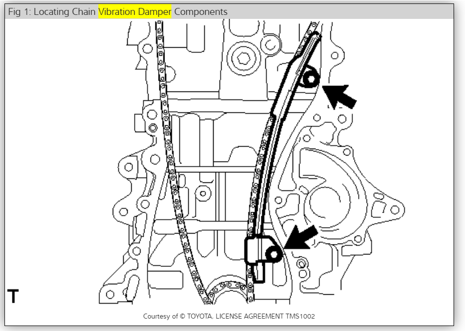

This is the only information I can find on the tensioner and guides. Check out the images (below). Please let us know what happens.

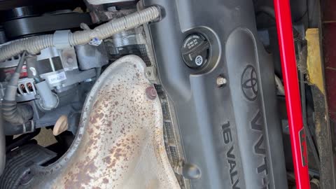

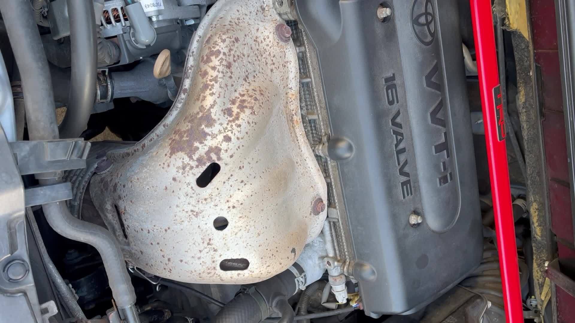

I never was going to take the whole front cover off and do the whole chain. I took a video for you to hear. I hope the video works.

Thank you for the video. This does not sound like the timing chain or its components. This sounds like a broken piston, rod bearing or seized wrist pin.

Okay. I can say that the engine does consume oil but not enough to cause it to constantly smoke. In fact, it does not visibly smoke at all. All I know is that it consumes a small amount of oil, maybe a half of a quart every 500-1000 miles. The car does not externally leak oil. Is there any way to tell which cylinder might be the problem area or to do a check to rev the engine in or out of gear or under load to check further?

I would pull out the spark plugs to see which one looks different. This will be the cylinder that is having the issue.
