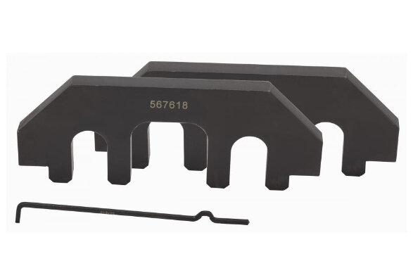

Need instructions to install timing chain and tensioner on the truck listed above.
Looking for step by step for reference so I don’t destroy my engine.
Tuesday, April 9th, 2024 AT 7:16 PM
BORIS K
MECHANIC
836 POSTS
Below are 2 links to timing chain replacement videos/guides.
https://youtu.be/OJIn2h10OAA?si=TWdD8hPUx4X1f5Qo
and
https://youtu.be/0Bs9yrm4c6E?si=_2imis-Ehxn9V7Nu
Special locking tools are illustrated in image below.
Hope these help.
Cheers, Boris
