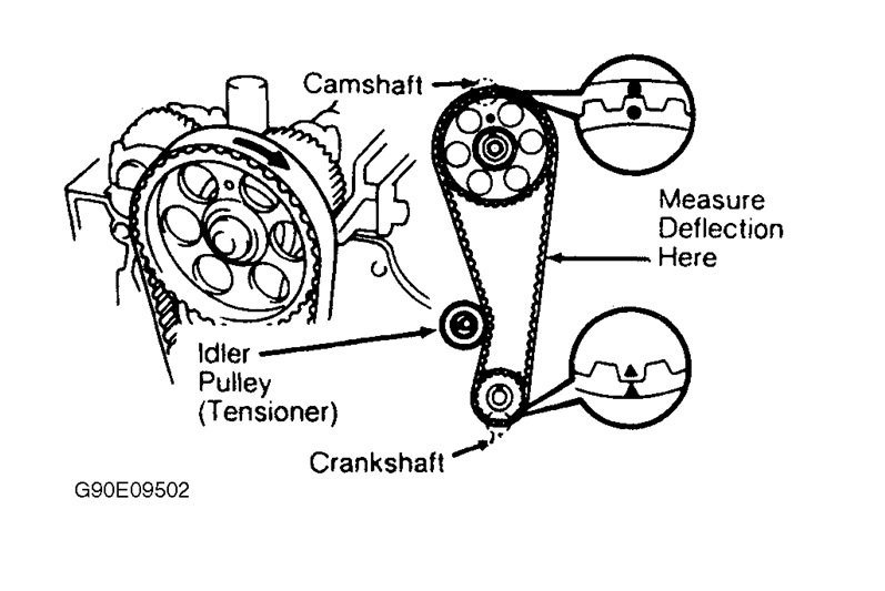

I need the diagram, picture, of a 1994 toyota corolla 1.8 to show me how to put the timinig belt back on. That way it will be put on right and the timing belt will be in time. Any pictures would be greatly appreciated.

This is for single overhead cam.

Do I have to get the number 1 piston up before putting the timing belt back on

Yes, #1 cylinder on top dead center of compression stroke.
