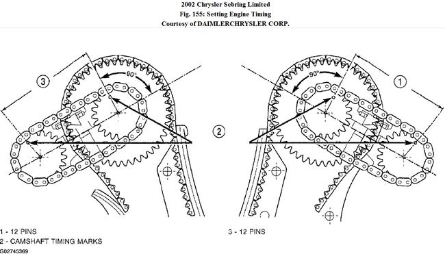

How can I set a 2.7 v6 in timing I need to see a Picture of the timing sequence please help.

There is a video on youtube how this is done. Just enter 2.7 v6 timing and go to the 10.02 min video part 2, by ihartmacz chrysler mastertech.

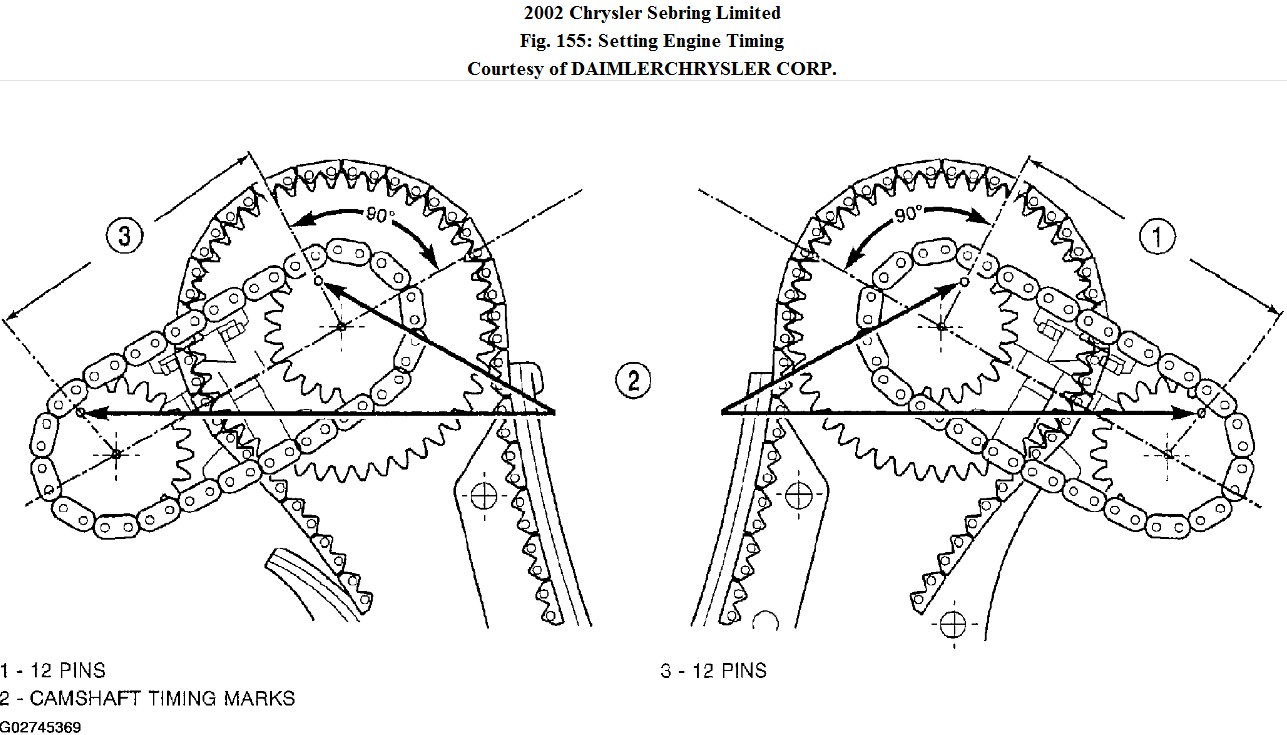

Ignition timing is setby computer, cam timing in pic

Thank you that was a great video.
