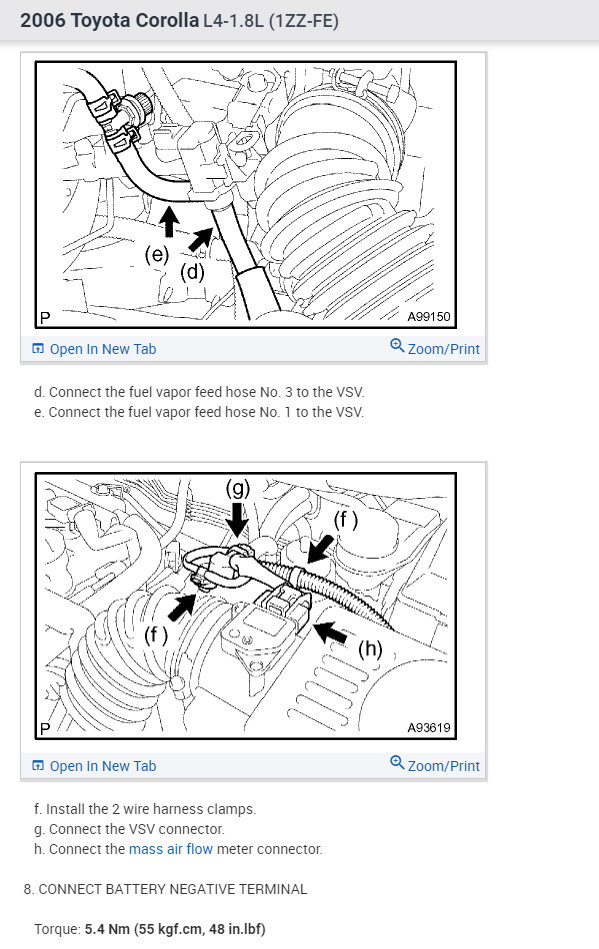

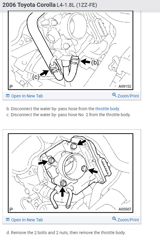

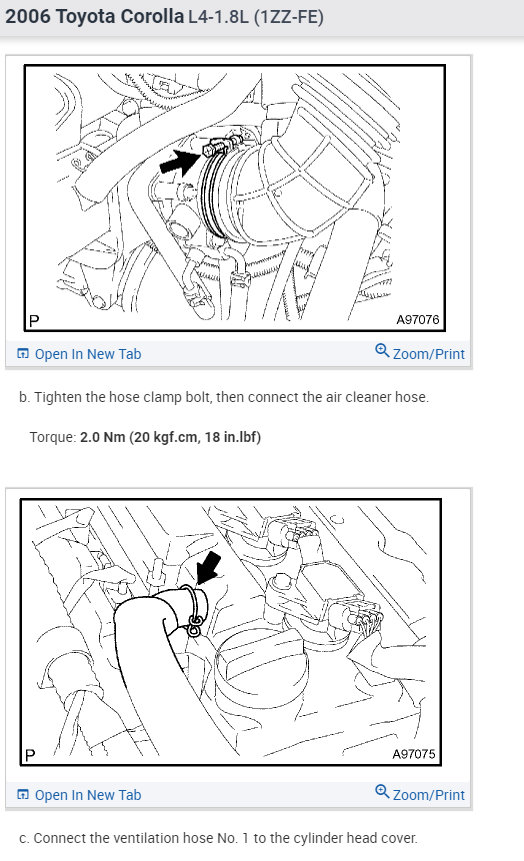

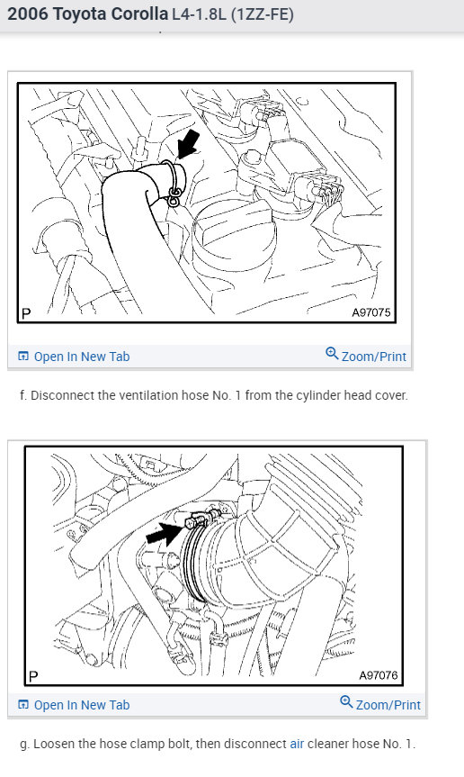

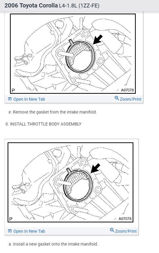

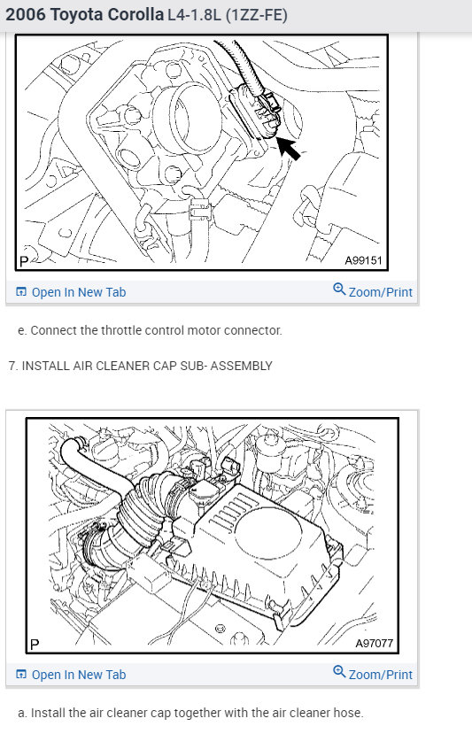

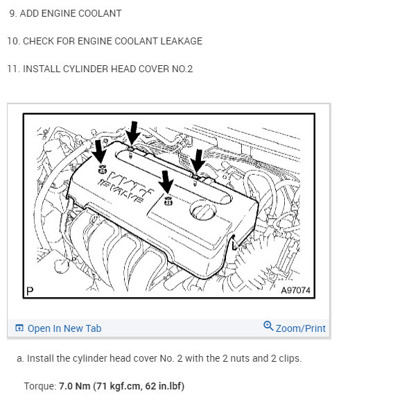

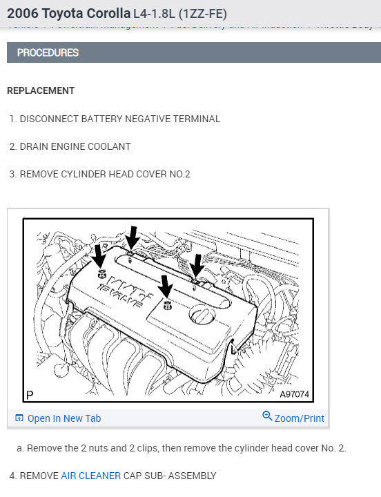

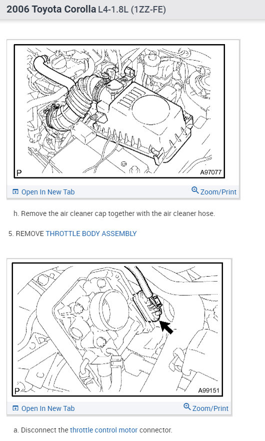

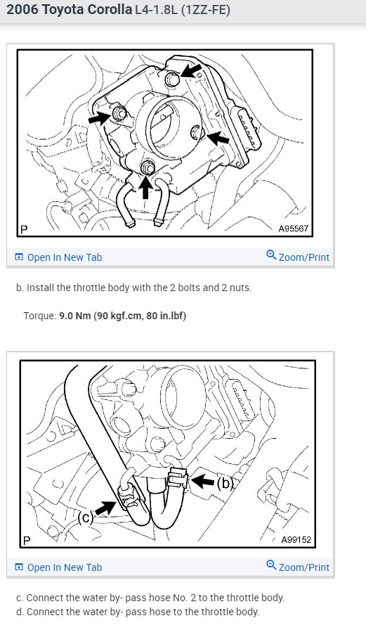

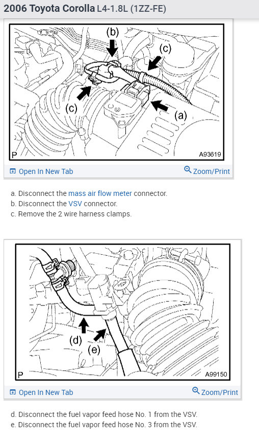

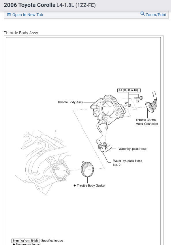

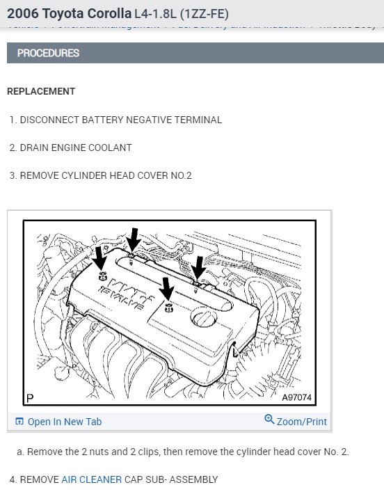

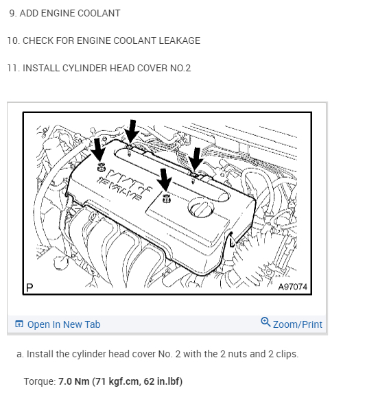

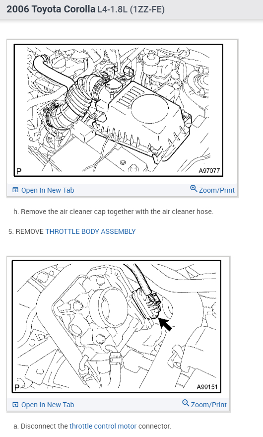

Anytime you are removing the throttle actuator you want to make sure that the battery is disconnected first.
Also, on this 2006 Corolla you can manually move the plate without causing damage.
Take a look at this video showing the cleaning process of a 2006 Corolla:
https://youtu.be/y2PQ1sDIbuI

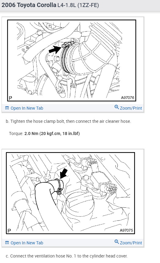

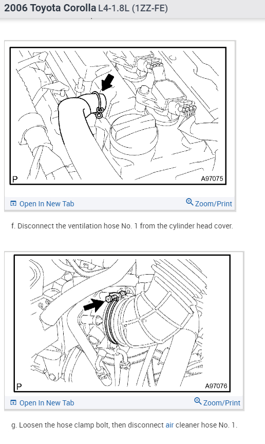

I have attached the throttle actuator removal process below for your reference.
Let me know of any questions.

Hello again, and thanks for the help as I'm disabled and not working with major medical issues. I need a little more info before proceeding. So, here are my questions:
1. I don't plan on taking the throttle body off. I'm going to clean it in place by removing snorkel hose out of the way.
2. Why does the battery need to be disconnected?
3. I need to make sure I don't damage the mechanism when manually opening the butterfly. When I move it all the way open will it stay there. Then after cleaning it should I put it back in the closed position before reconnecting the battery? I was told that there are gears that can get damaged if you force it open or get something out of calibration. If you open this electronic type, will you feel resistance of the gear mechanism and need to go really slow with it.
Thanks, Robert
Thursday, July 14th, 2022 AT 5:52 AM
SQM
  • 6,383 POSTS
You want to disconnect the battery as if it is not disconnected it can mess with the programming of the throttle actuator.
As for the butterfly, it will spring back into the original closed position when you let go of it.
On this 2006 throttle actuator it will not damage anything when the bottlefly gets manually opened after the battery is disconnected.

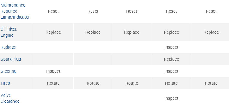

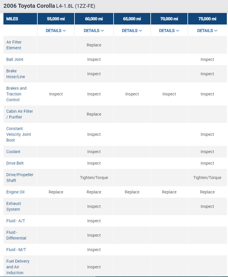

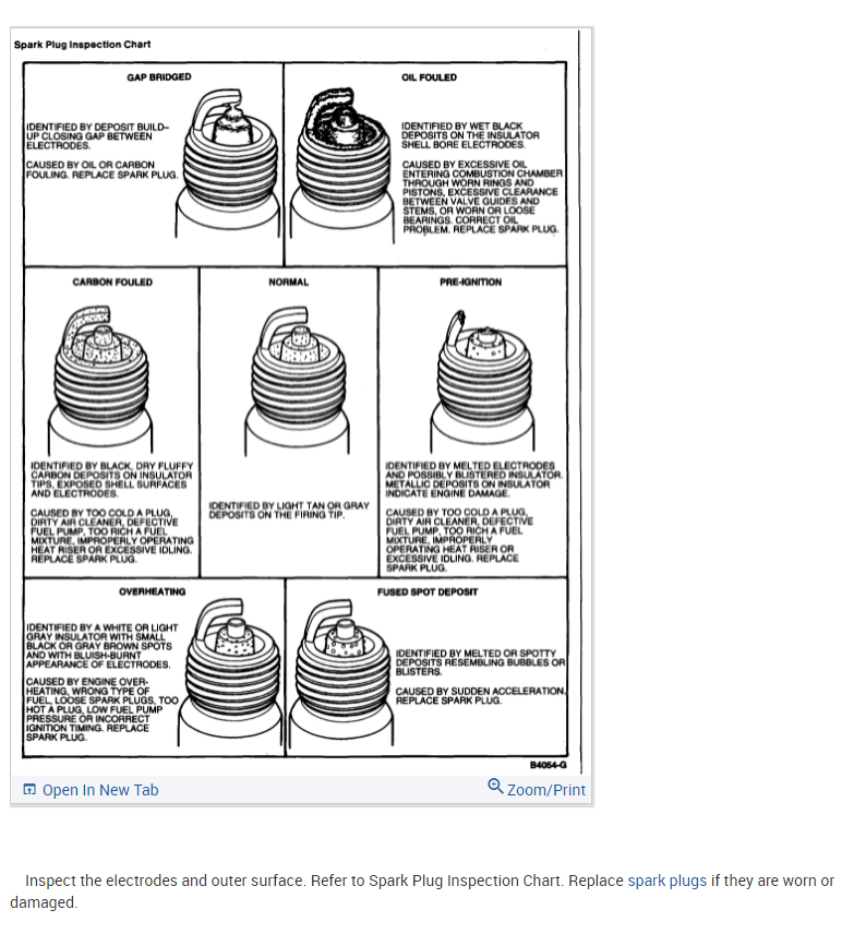

You have been very helpful, so thanks. One more question. My car has very slight rough idle so I'm going to clean throttle body first and see what happens. However, I have the original spark plugs on car with 72,000k miles. Looking at my manual maintenance schedule I believe it shows to change on 2006 Corolla 120,000. I don't want to do it any sooner than necessary so what do you recommend? Thanks
Friday, July 15th, 2022 AT 9:31 AM
SQM
  • 6,383 POSTS
You are welcome.
Cleaning the throttle actuator can improve idle quality, given it is dirty. Which is likely due to the mileage and if it hasn't been done recently.
For the plugs you want to remove and inspect them. If they are in good condition, no need to change.
Friday, July 15th, 2022 AT 9:43 AM
RWALBROEHL
  • 126 POSTS

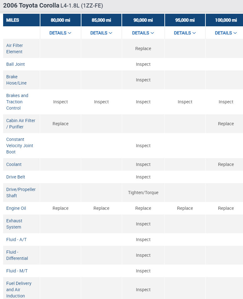

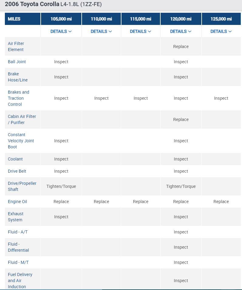

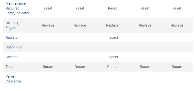

Thanks for the info but could you give me your recommended plug change mileage for the 2006 Toyota Corolla? Also, I don't think if I take them out and inspect them you could put them back in as the crush washer at the base has already been squashed.
Friday, July 15th, 2022 AT 10:21 AM
SQM
  • 6,383 POSTS

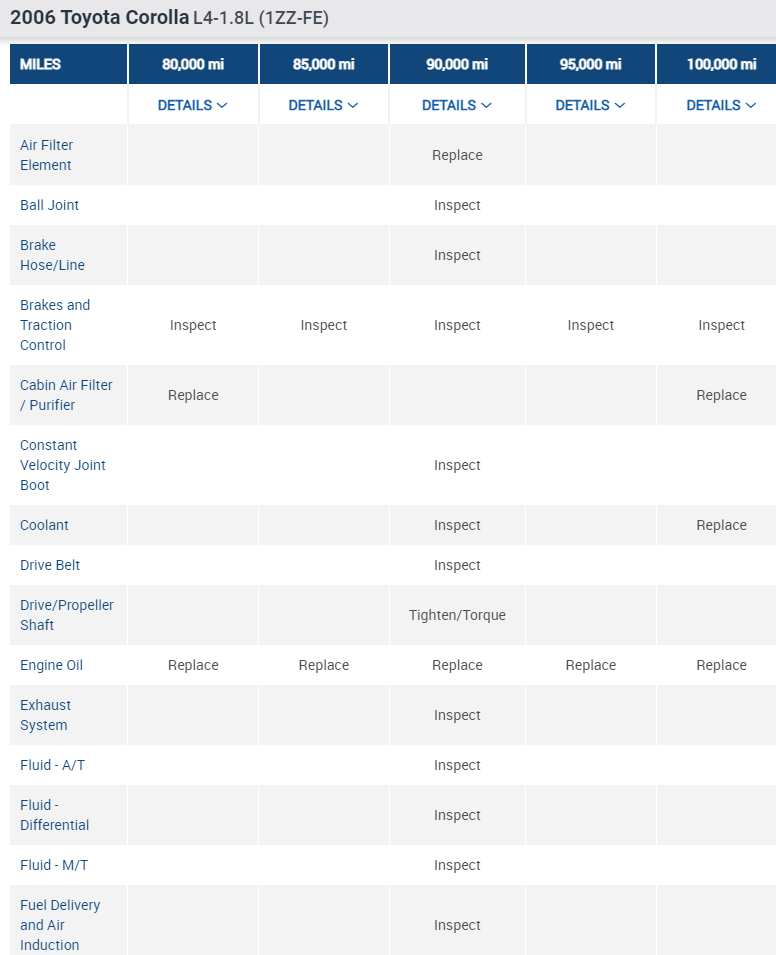

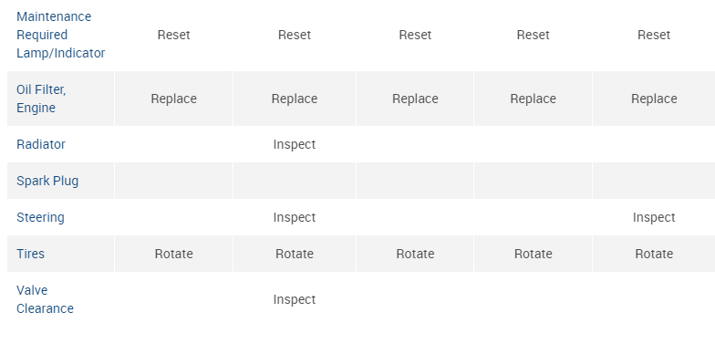

See attached for the maintenance timetable with the intervals. From 70,000 to 125,000 mileage.

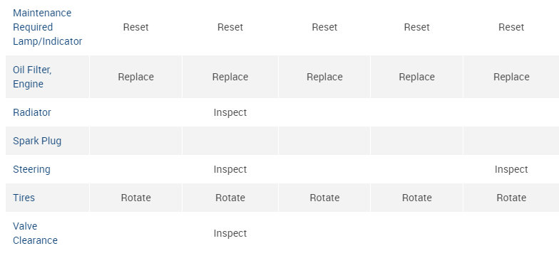

-1
Friday, July 15th, 2022 AT 10:27 AM
RWALBROEHL
  • 126 POSTS
Unable to read. Was blurry.

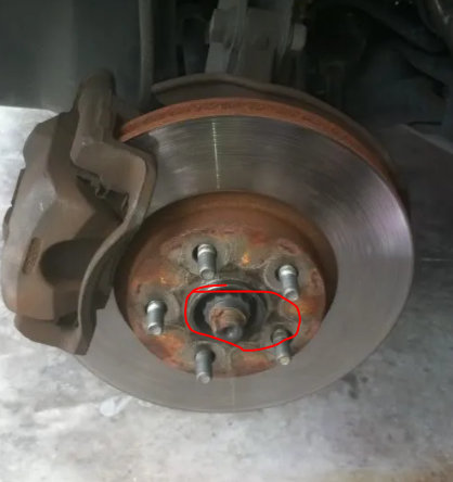

Never mind. Sorry it was my error. Could you tell me where to tighten the drive shaft bolt they are talking about? Picture please.
Friday, July 15th, 2022 AT 1:48 PM
SQM
  • 6,383 POSTS
For your vehicle it will be the axle nut that is for the CV shaft.
It should be torqued at 159 ft. Lbs.

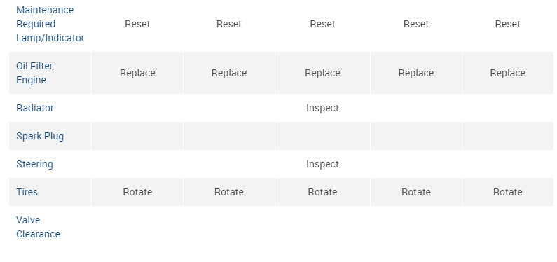

Looking at the chart you sent me on 2006 Corolla spark plug change I believe it shows 120,000 miles. Is that correct? Also, I'm getting ready to clean throttle body with that cleaner. I was told just to spray a rag and wipe it but not to spray it in the opening. I remember having a 1997 Camry that gave me idle problems and there was a small slot that a Toyota guy told me needed to be sprayed. Does his 2006 also have that idle slot that needs spraying also? Thanks for the help. You guys are the best.
Sunday, July 17th, 2022 AT 7:59 AM
SQM
  • 6,383 POSTS
Yes, it is 120,000 miles for the plugs.

This has helped a little after cleaning and now I also purchased a can of mass airflow sensor spray so I need to know if I should take out the two screws that secure it and lift it out without disconnecting electrical cable or disconnect the cable and then take it out and spray it. Does battery need to be disconnected again or not? Thanks
Monday, July 18th, 2022 AT 1:08 PM
SQM
  • 6,383 POSTS
You want to disconnect the battery and remove the cable. That way you won't mess with the calibration.
