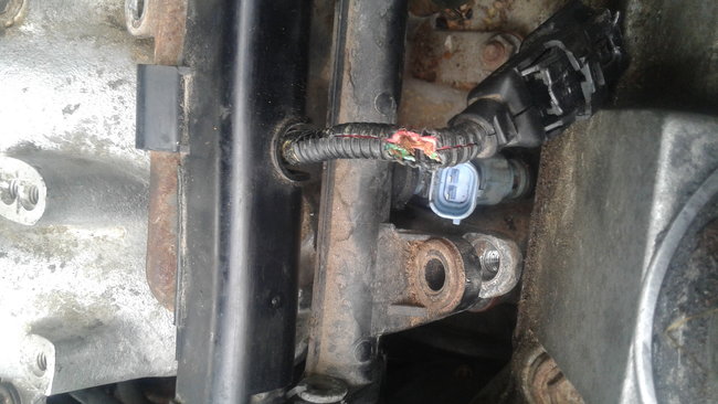

This is what I found when the code P02020202 showed in the scanner..Q

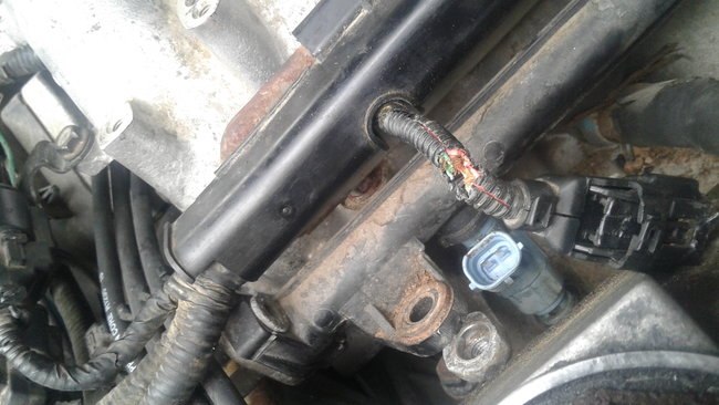

Bare wires broken and attached on clay and injector #2. Would this cause no idle or crank but dies when acc pedal release. Could it have shorted anything else that would keep it from idling. I'm going to repair the wires and see what happens. I need all the help I can get !

If the injector isn't working correctly that could cause it to not idle. Fix the wires and let's see what happens.

This is what it started out looking like ! Going to scrap yard and get a connector and injector will let you know the outcome around mid- day.

Looks like a rodent chewed it?

That's what I thought also. Anyway I replaced it today and will try to crank it in the morn. Battery was too weak to crank it. Oreillys is charging it overnight and I will pick it up in the a.M.. Think I will have to reset the TED? What is that procedure?

The injector harness is more likely to be causing the idle issue. But you don't want a bad battery driving around.

Ok fixed injector wiring, installed new injector, and new battery. Vehicle now runs and idles somewhat at around 1000 rpm. Took it to get it scanned again. Still throwing the p0202 code and now the p1155 code. What now? Please help !

I don't see a p1155 code for that car are you sure that's the right code?Also are you sure there isn't more damage somewhere else on that injector harness?
