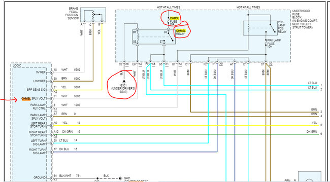

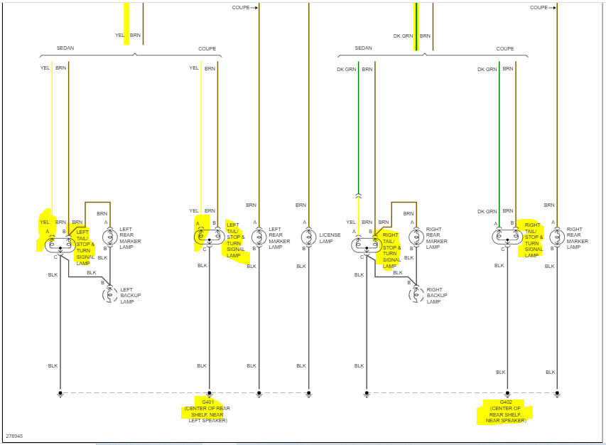

Is it only the brake lights that aren't working? Do the turn signals, parking lamps, backup lamps, and license plate lamps work? I ask because there could be a ground-related issue.

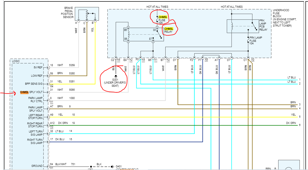

I ask because the center high-mount stop lamp (CHMSL) is powered via a relay. It also has its own separate fuse.
Next, if the turn signals work, then the wiring to the light sockets is good because the signals use the same wires.

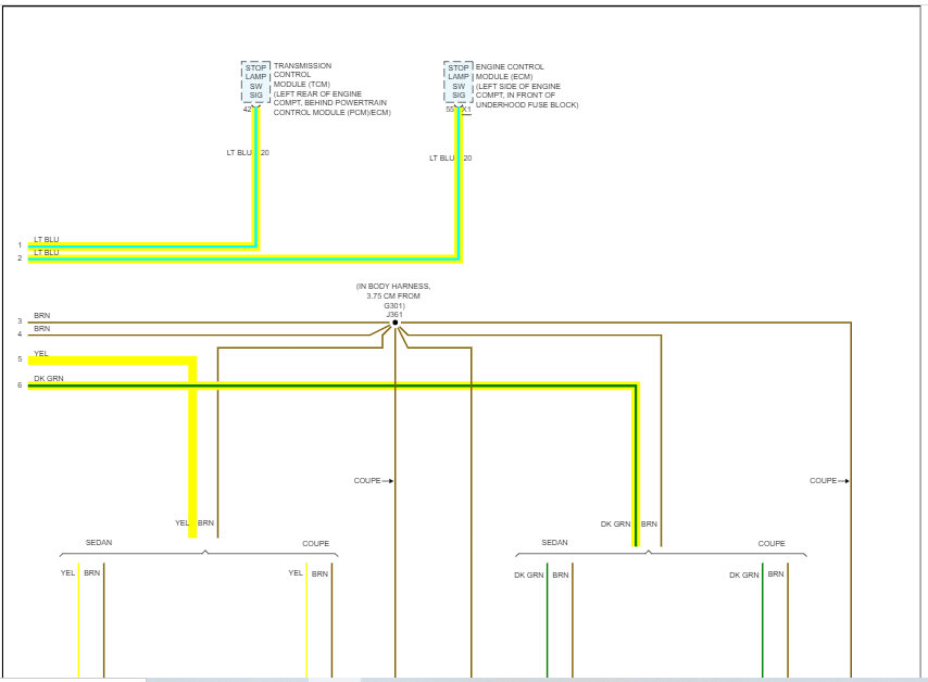

That leaves the body control module. Do me a favor. See if there is power to the yellow wires at the light sockets when the brake pedal is pressed. Don't use a 9v battery.
I attached the wiring schematic below showing the exterior lighting circuits. I highlighted areas of interest. I need to know if there is power. If there isn't, we will need to work backward to see where power is lost.

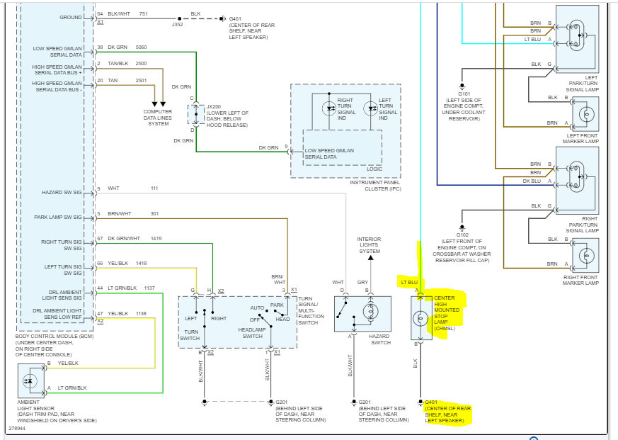

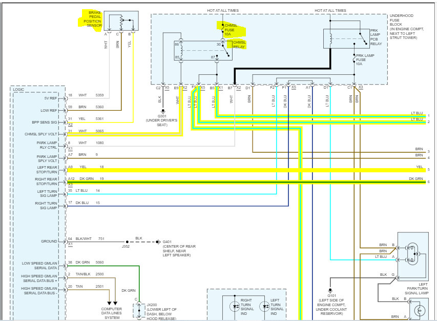

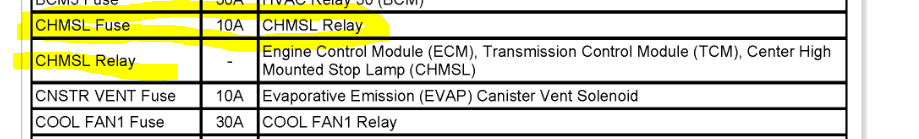

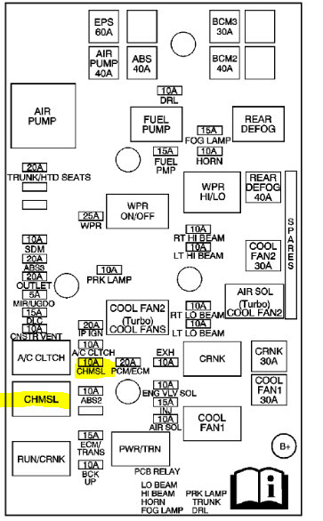

If it is only the CHMSL, there is a fuse and relay in the under-hood fuse box. See pics below. Note, if you are seeing a dim light, then check to make sure the ground is good. Also, using a multimeter or voltmeter, check to see if there is battery voltage at the light blue wire on the CHMSL. If there is, then either we have a weak ground or a poor connection at the light itself.
Let me know what you find.

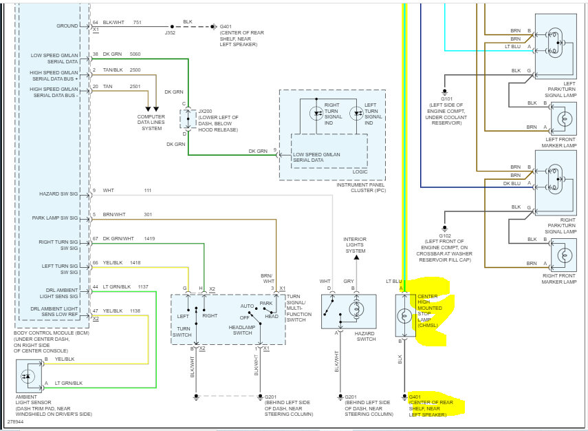

If you have 18+v to the light, it may have failed. Also, at the CHMSL is a light blue wire. Have you checked it for power as well as checked the black wire for continuity to ground?
