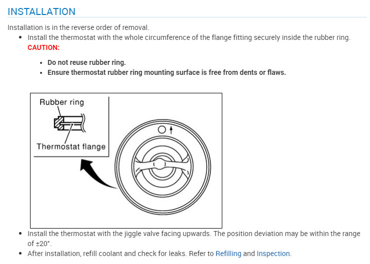

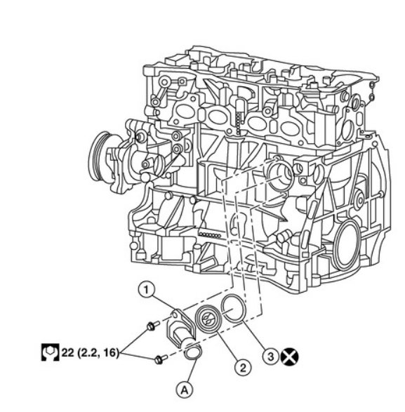

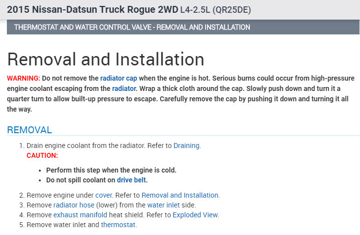

Is the thermostat located on the upper or lower hose? I seem to be finding conflicting answers.

Here is a quick tutorial for you to view as a reference for thermostat replacement:
I've attached pictures and step-by-step directions for replacement below.Hope this helps and thanks for using 2CarPros.
