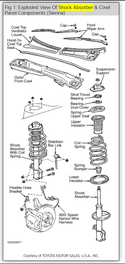

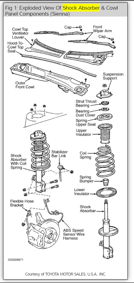

The car is low to the ground, I want to raise it up. Advice needed on what to do. Thanks
Tuesday, September 19th, 2017 AT 5:42 AM
KEN L
MASTER CERTIFIED MECHANIC
55,499 POSTS
The car is low because someone has cut or heated the springs a common thing to do among the younger crowd.
Here is a a guide and some diagrams to help you get the job done:
You will need a strut compressor which you can rent at the auto part for free.
Please let us know what happens and upload pictures or videos of the problem.
Image (Click to make bigger)
