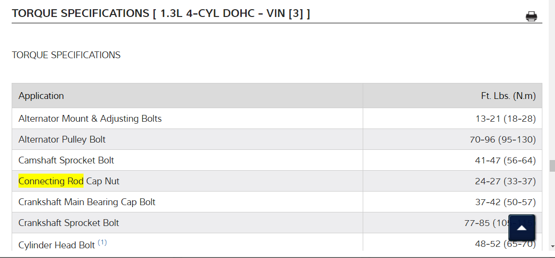

What the torque specs for a g16a cylinder head bolts, main bearings and connecting rod?

Both of my reference materials do not show a 1994 Suzuki Swift with a 1.6L engine just a 1.3L engine with either a single overhead camshaft or dual overhead camshafts. Can you please verify your vehicle's engine size for us?

Can I have the VIN number so I can get the exact specs for you?

Engine number G16A838312 and chassis number AH14S250061 that is what is on the vin plate. if it helps it a right hand drive saloon or sedan.

It says 1.6 liters on the valve and it's a sixteen valve engine.

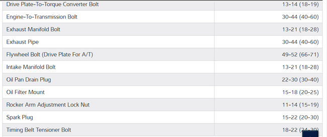

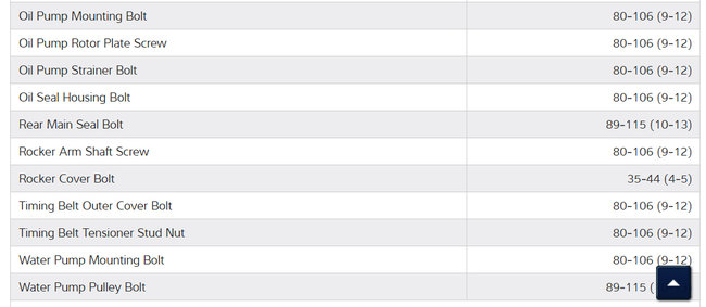

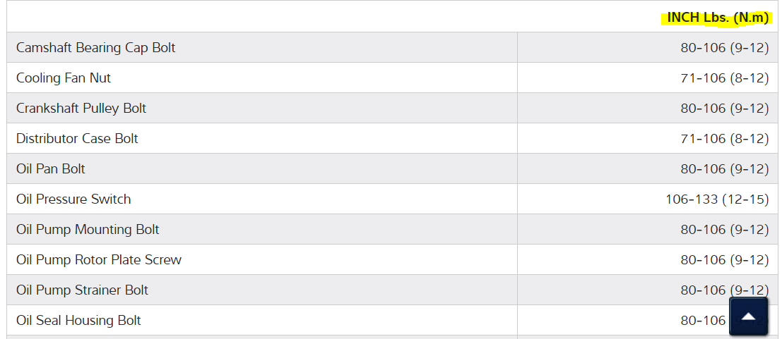

I have included the information that you requested in the diagrams down below. I have included the torque specs for your entire vehicle and I hope this helps. Please, feel free to ask, should you have an additional questions.
