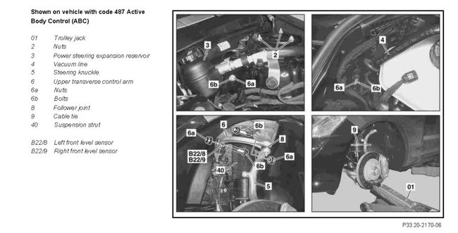

Seems like it's coming from the upper control arm. When feeling with hands that is where i see the play is. Also, the noise coming from the top when raising the car as in the video.
Jul 26, 2022 at 8:09 AM
  • 54,130 POSTS

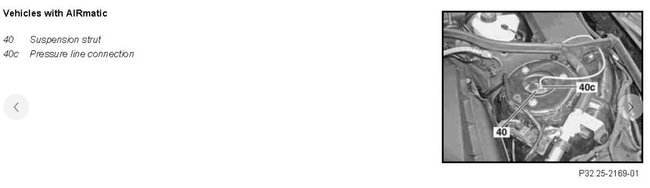

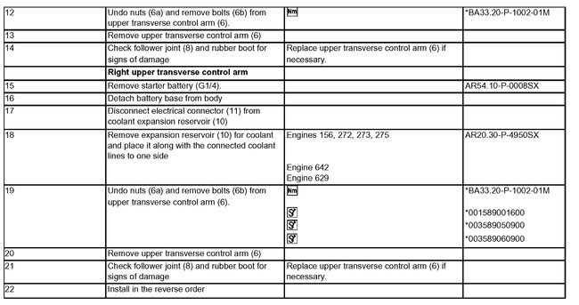

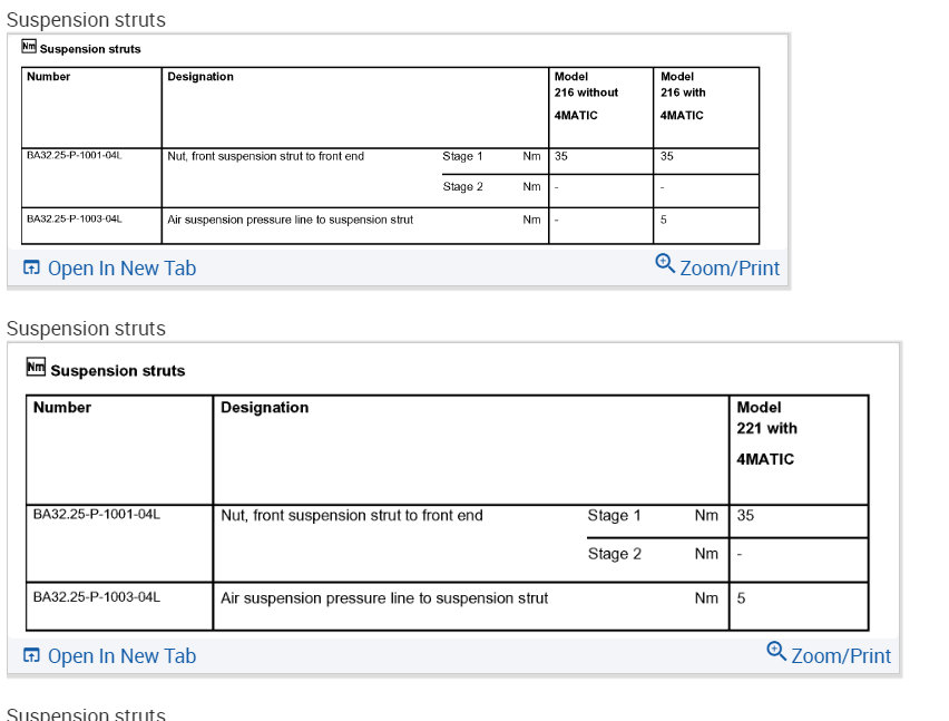

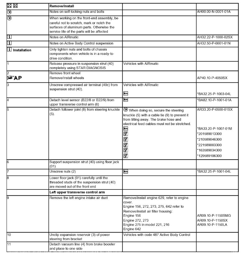

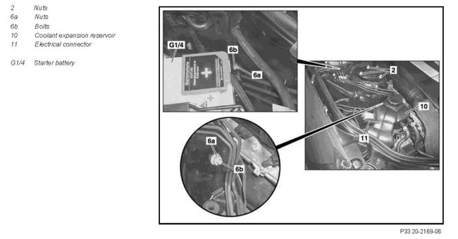

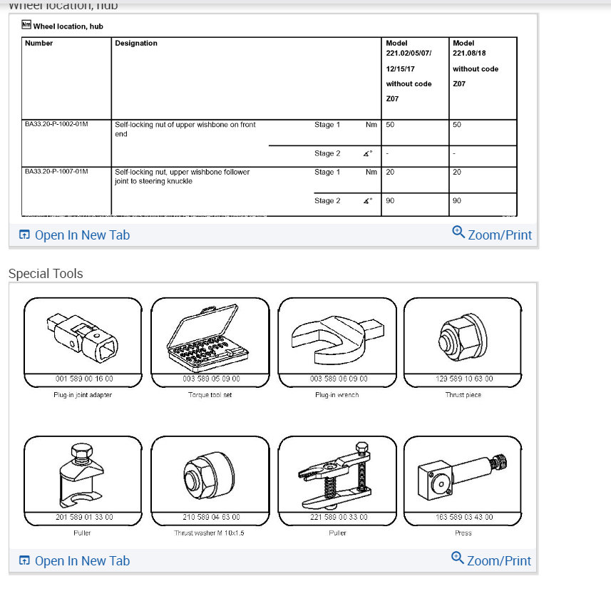

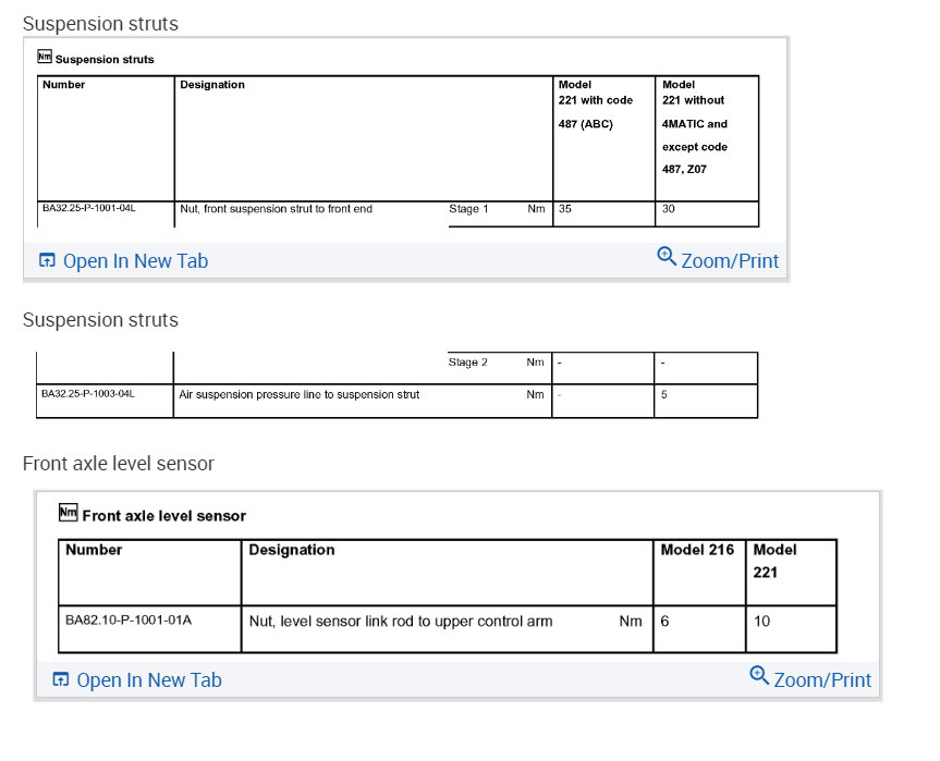

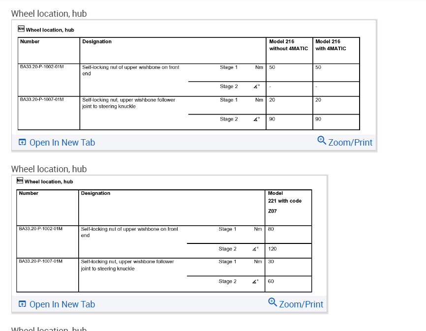

Thanks for the videos, they help. Yes, it looks like that is where the play is coming from as well, here is how to change out the upper control arm s to fix the problem. Check out the diagrams (below). Please let us know if you need anything else to get the problem fixed.
