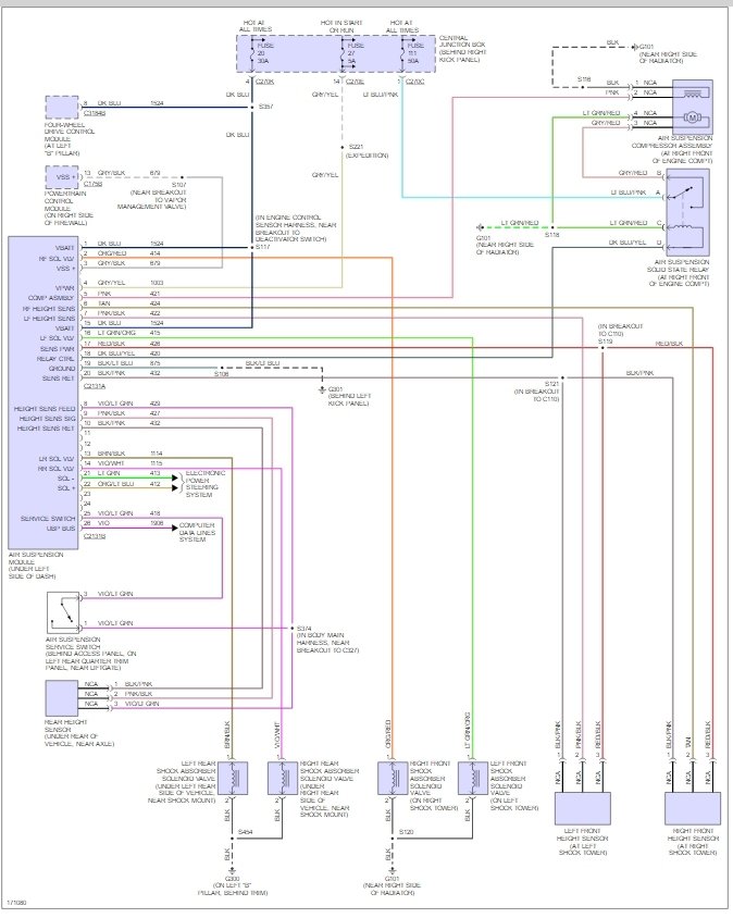

I have a 2003 lincoln navigator with air ride suspension. The back airbags are done and need to be replaced. Can I have the back switched to coils and shocks and will the front suspension still work properly?

You can switch them but you'll need to do the front as well and disable the electronic suspension by pulling fuse or relay

So will the computer stop filling the front airbags if the back is switched to coils and shocks?

Yes if you pull the fuse or relay.
Here is a diagram
Please let us know how it goes
Best, Ken

If I leave the fuse in will it continue to fill the front airbag suspension?

The system works for the front and rear, if you disable it neither will work.
