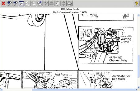

This is a Loyale. Where can I locate the 4WD relay solenoid? It's not engaging (though it says it is) into 4wd, and I think I need to replace the relay, but need to know where it's located. Help?

When you ask-you shall receive from 2carpros-See below Its in the center dash console behind ashtray Green connector
https://images.2carpros.com/forum/automotive_pictures/12900_4wd_checker_relay_1.jpg
Good Luck
