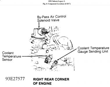

On the idle air control valve, I see where the hoses connect but I am not seeing where this is bolted to the throttle body or engine casing.
I do see a small cover that can be removed. To remove the whole valve assembly from the car, do I need to open that cover and will I find the bolts in there with which it is attached to the car?
If not, can you point me to a diagram that shows the bolts that hold this thing on (or explain where they are so that I can find them). I'm going to go to the junkyard and grab one off a Legacy, once I figure out how to get it off.

The IAC is known as the Bypass Air control Valve for this model and here is a location diagram. It is bolted on at either end and aftr removing the bolts, it can be pulled out. Quite often cleaning the valve with carb cleaner would fix the symptome described as there are no trouble codes.
https://www.2carpros.com/forum/automotive_pictures/192750_IACV91LegacyFig06_1.jpg
Here are the procedures for testing the component.
BY-PASS AIR CONTROL VALVE (TBI)
1 . With engine running, disconnect electrical connector. Engine speed should drop (a little with engine warm, a lot with engine cold). Reconnect electrical connector. Ensure engine speed returns to previous speed.
2. If not, turn engine off. Turn ignition switch to ON position. Ensure 10-12 volts are available at Black/White wire of air control valve electrical connector.
3. Turn ignition off. Ensure resistance of Air Control Valve (ACV) is 7.3-13 ohms at -4 to 176 °F (-20 to 80 °C). If not, replace ACV. Check ACV solenoid for any short to ground. If present, replace ACV.
4. Attach electrical connector to ACV. Disconnect connector at ECU. Turn ignition on. Ensure 10-12 volts are present at terminal No. 45 (Green/Red wire) of ECU. If not, check harness between ACV and ECU.
5. Turn ignition off and reconnect ECU connector. Turn ignition on. Backprobe terminal No. 45 (Green/Red wire) of ECU. There should be one volt or less for about one minute after ignition switch is turned to ON position. After one minute, there should be at least 10 volts. If not, check for a bad ground, problem with ECU circuits (sensors) or ECU.

OK. I pulled it. Didn't remove the coolant lines attached, but did shoot carb cleaner liberally through the air lines and connectors -- one of which was particularly crudded up inside.

That was it!
Winter is back, so I went out this a.M. When it was snowing and about 30 degrees out and started the car. Let it run for about 10 minutes. Kicked down the idle.
Idles steady. No surging.
So just pulling and cleaning the Bypass Air Control Valve did the trick. After all those other parts I needlessly replaced.
