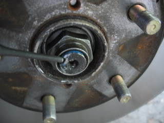

Thank you for all of your help by the way, Ill have to take a look at that here in the next day or two. I dont have the proper tools to take off the nut or tighten it so Im assuming that I should be able to take it to a reputable shop and have them either tighten or replace the axle nuts correct? Considering I've been driving around on this for around 8 months with nothing more than the intermittent clicking I should probably be ok for a few more days?
Just for my clarification I've referred to the spline nut as the axle nut is the picture below the 'spline nut?'

Yes it will be fine to drive it for a few more days, this is the spline nut, as it is what is called a staked nut, and not split pin type, you should ask for a new nut to be fitted, by the way is it staked, the pic does not show the knocked in section, it may be that the pointer is in the road.
