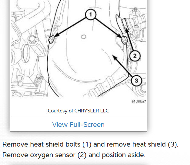

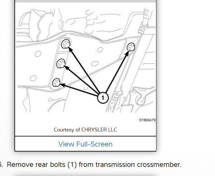

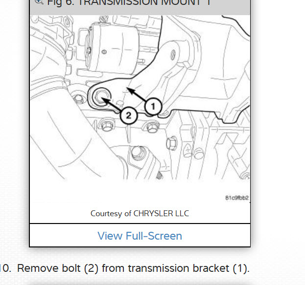

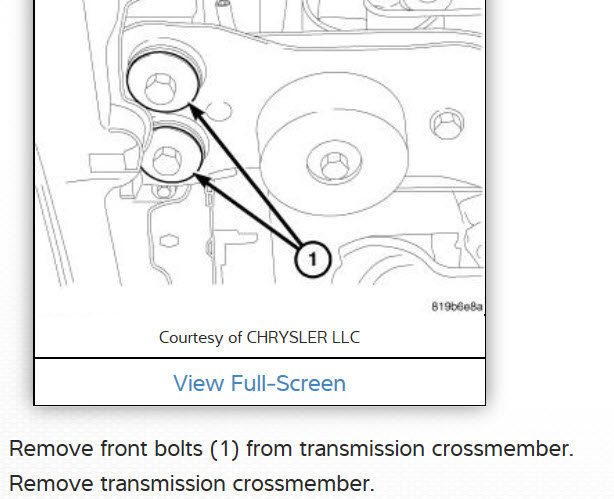

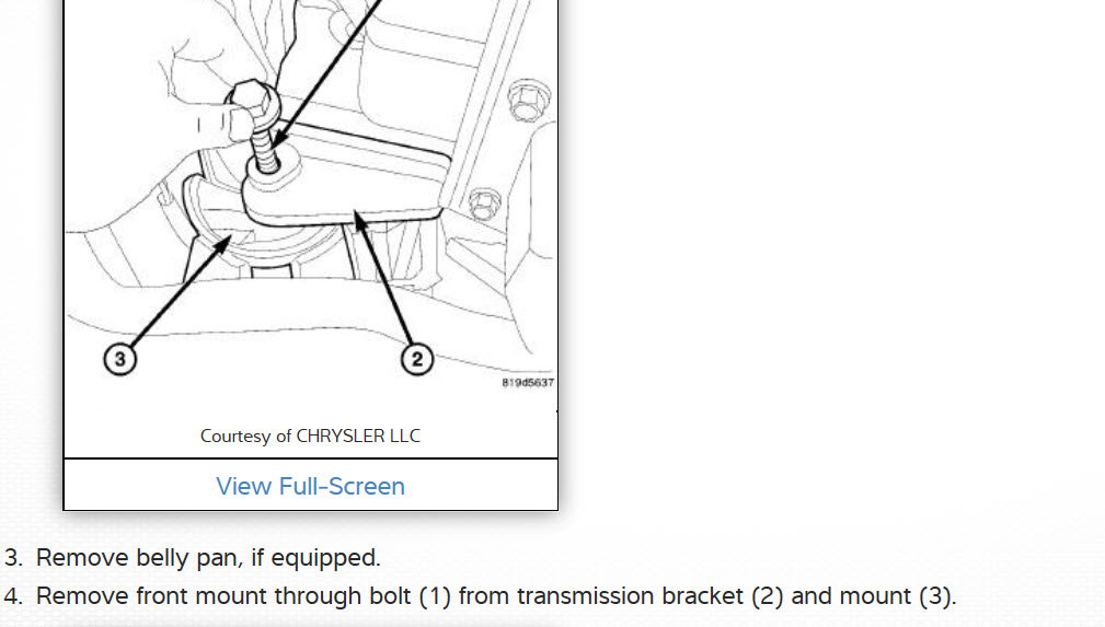

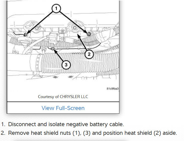

No idea how to access starter to put in new starter. Is there some special trick getting it out?

See pictures it is kind of involved then you can start on removing starter.
