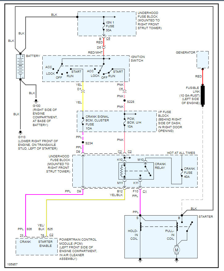

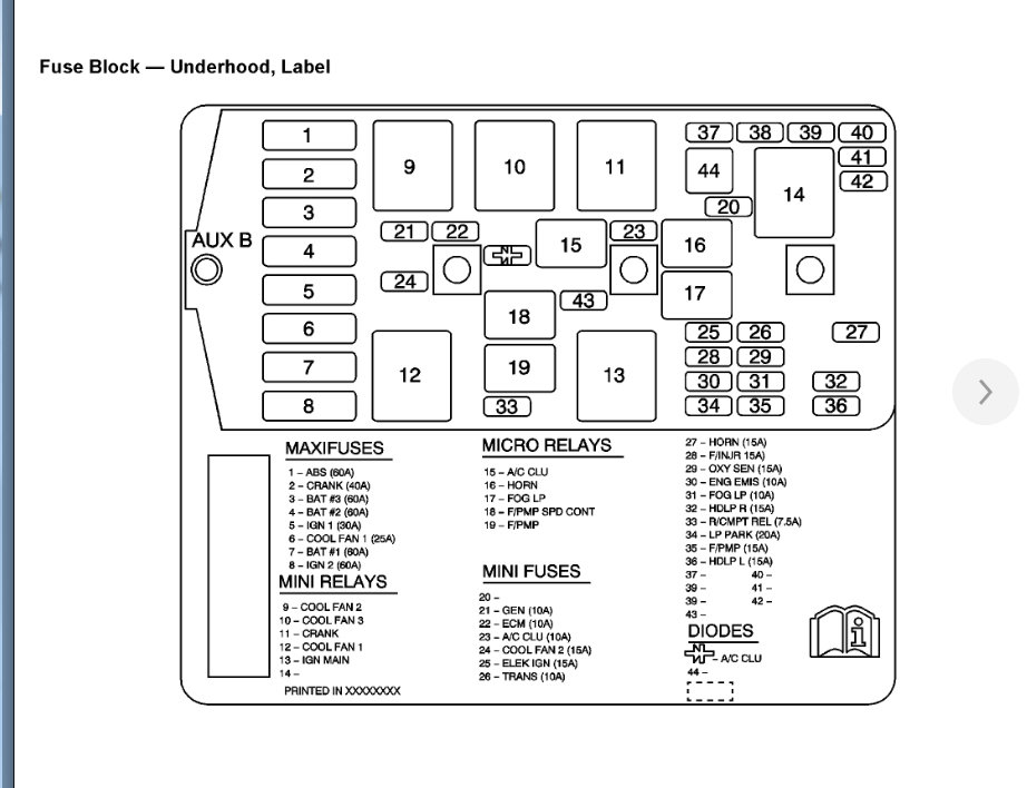

I need to know where is the location of the starter relay on my car?
Saturday, August 10th, 2019 AT 12:09 PM
MECHANIC
18,907 POSTS
Here is the wiring diagram that shows a number of fuses and what the call a Crank relay.
Looks like on the underhood fuse box, fuse 2 and relay 11 are your crank relay and fuses.
Let me know if you have questions. Thanks
