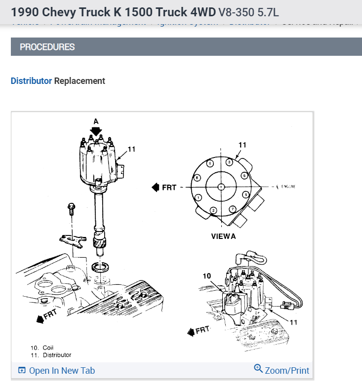

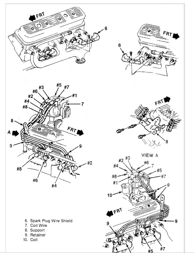

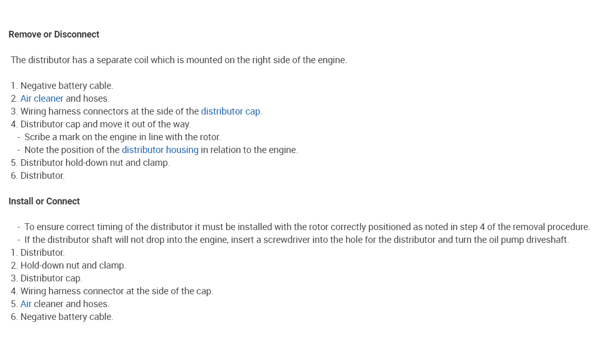

I would remove the MSD Digital Multi Spark box and coil and replace it with stock parts, we have no way of knowing what's going on with aftermarket parts. I would check RockAuto. Com for an ACDelco rebuilt distributor with new coil. Here is how to install it. Also check the TBI base gasket. Check out the images (below). Please let us know what happens.
Thursday, January 5th, 2023 AT 1:16 PM
