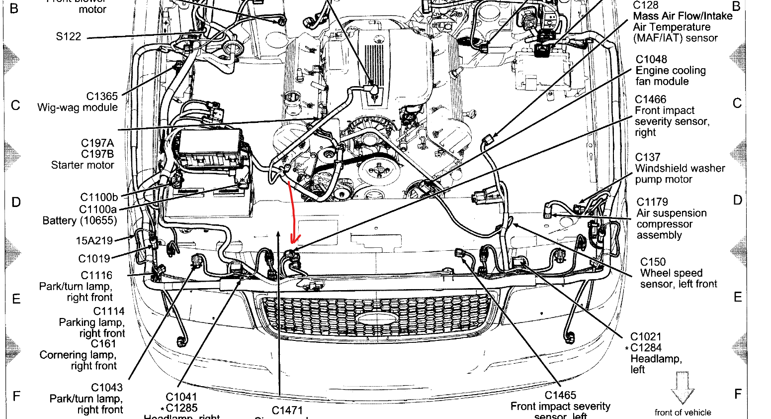

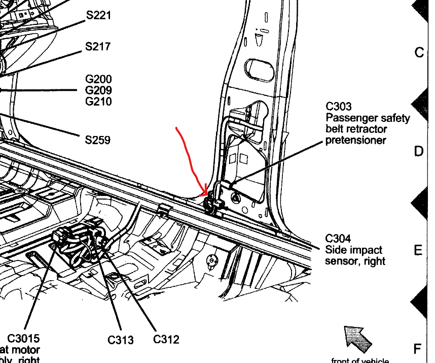

I believe this refers to Passenger side front Impact sensor. Where is this sensor located on my 2006 P71 Crown Victoria?

Here are both right side airbag system impact sensors in case you need them. Check out the images (below). Let us know if you need anything else.
