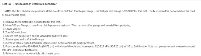

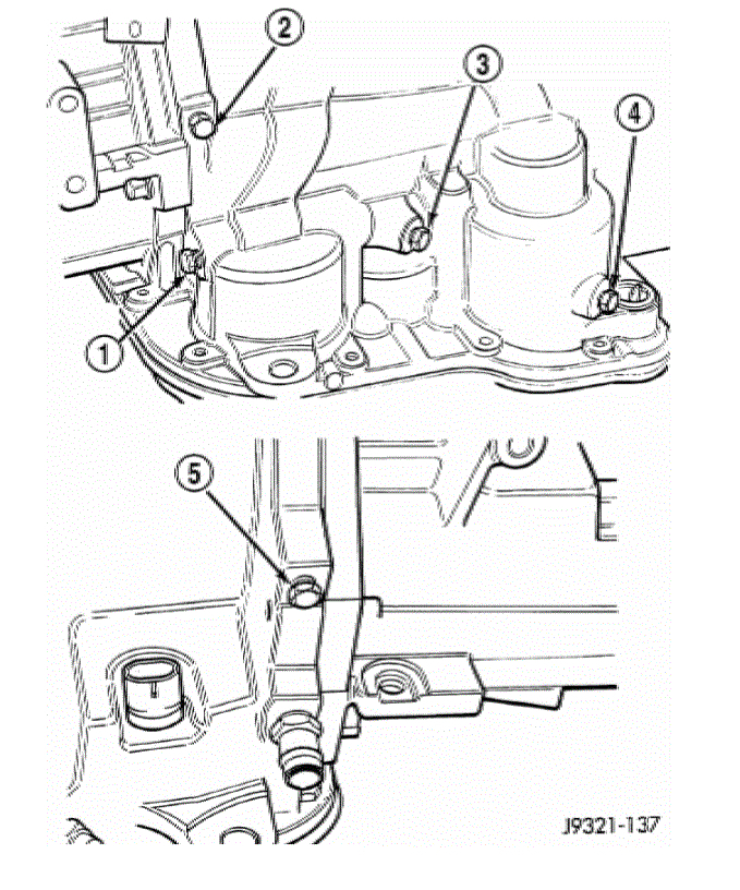

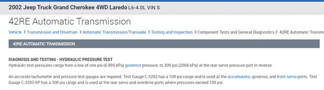

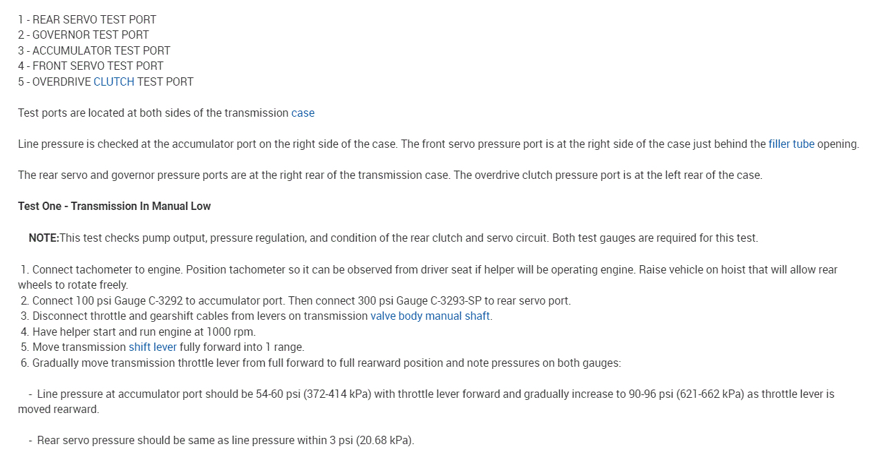

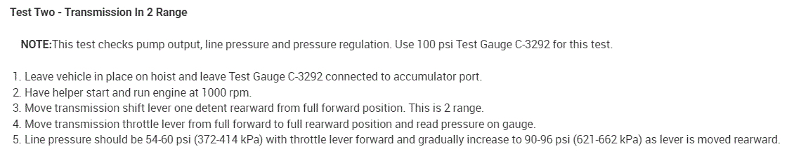

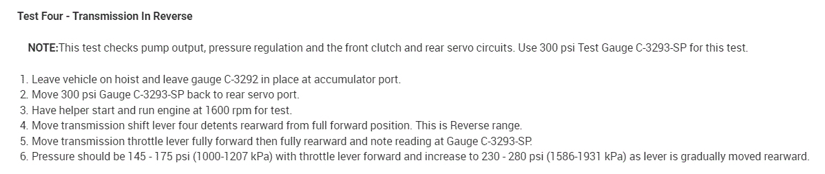

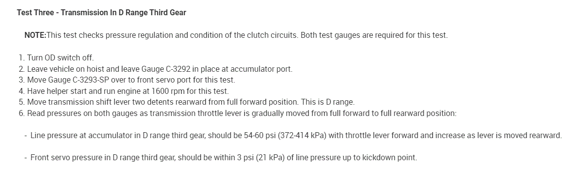

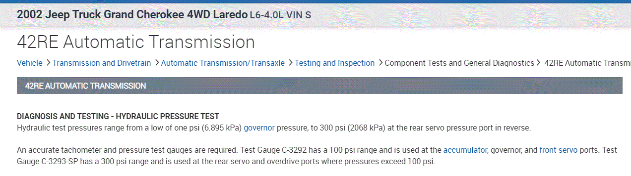

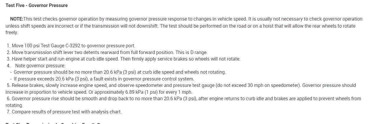

The idea that there are no codes is leading me to think there could be possible line pressure issues or an issue with the valve body itself. The idea that you replaced the pressure sensor should help the testing show normal. If I had to guess if one of the parts you purchased was bad, I would think the pressure solenoid would be first on my list.
Do me a favor. Take a look at the pics below. They provide directions for testing line pressure. It will require a pressure gauge but really isn't that hard to do. See if it is something you feel comfortable doing and let me know.

Hi Joe, I am working on this in my drive. I jack the front of the car up and put on jacks to drop the transmission pan. So, while those test procedures do not look difficult, I do not have a helper and I have no way of getting the rear axle off the ground. It does seem like the problem is pressure related and since it was shifting late but holding gears before I would assume it's like you said the solenoid or the sensor. Another thing I wondered about was an electrical issue, maybe one of the wires that plugs to either of these is bad. Another post someone said they put the old filter back on and it worked fine. That is a bit hard to understand but I was thinking of pulling the filter off and not using a filter just to test, putting the old solenoid and sensor back on and see what if anything changes. If nothing else, I can eliminate those two items. If it's the valve body I was thinking of putting in a Transgo shift kit. Can I test the pressure with the car stationary with a long hose on the vacuum gauges and me sitting with my foot on the brake putting it in drive etc.

You can test it yourself with a long enough gauge. Basically, you need to determine line pressures at idle, in gear, and so on.

The solenoid valve generates the governor pressure needed for upshifts and downshifts. I suspect that is the cause. If possible, let me know if the replacement eliminates the issues. I'm interested in knowing.

The governor pressure sensor measures the output pressure of the governor pressure solenoid valve. LOL, It's like one big loop. Regardless, the pressure sensor output signal provides the necessary feedback to the PCM to accurately control pressure.
